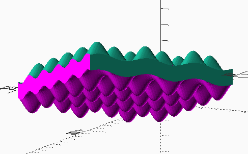

Hello,
I think I have missing faces in my polyhedron because I am unable to compute
a difference or something similar with an other object.
However, the plain polyhedron looks fine so I don't know where my bug is
located.
Thank you very much for your help.
Andreas

Hello,
compute
located.
Andreas

https://en.wikibooks.org/wiki/OpenSCAD_User_Manual/The_OpenSCAD_Language#Mis-ordered_faces On Wed, Dec 4, 2019 at 12:12 AM AndreasG4r <grubi@edumail.at> wrote: > Hello, > > I think I have missing faces in my polyhedron because I am unable to > compute > a difference or something similar with an other object. > However, the plain polyhedron looks fine so I don't know where my bug is > located. > > Thank you very much for your help. > Andreas > > > > lenX=100; > lenY=200; > sizeX = 100; > sizeY = 100; > lenTot=lenX*lenY; > cntX=3; > cntY=5; > amplitude=10; > wallSize=3; > function generator(x,y) = > amplitude*sin(x*360*cntX/lenX)*sin(y*360*cntY/lenY); > function p(x,y,z) = x+y*lenX+z*lenX*lenY; > > // x1y1 x1y2 x1y3, ... , x2y1, ... > //Start 2. X Point 2 > //Start 2. Y Point lenX > //Start 2. Level: lenX*lenY > points = [ > for(y = [0:lenY-1]) for(x = [0:lenX-1]) > [x*sizeX/lenX,y*sizeY/lenY,generator(x,y) - wallSize/2] , > for(y = [0:lenY-1]) for(x = [0:lenX-1]) > [x*sizeX/lenX,y*sizeY/lenY,generator(x,y) + wallSize/2], > ]; > faces = [ > for(x = [0:lenX-2]) for(y = [0:lenY-2]) > [p(x,y,0),p(x,y+1,0),p(x+1,y+1,0),p(x+1,y,0)], > for(x = [0:lenX-2]) for(y = [0:lenY-2]) > [p(x,y,1),p(x,y+1,1),p(x+1,y+1,1),p(x+1,y,1)], > for(x = [0:lenX-2]) [p(x,0,0),p(x+1,0,0),p(x+1,0,1),p(x,0,1)], > for(x = [0:lenX-2]) > [p(x,lenY-1,0),p(x+1,lenY-1,0),p(x+1,lenY-1,1),p(x,lenY-1,1)], > for(y = [0:lenY-2]) [p(0,y,0),p(0,y+1,0),p(0,y+1,1),p(0,y,1)], > for(y = [0:lenY-2]) > [p(lenX-1,y,0),p(lenX-1,y+1,0),p(lenX-1,y+1,1),p(lenX-1,y,1)], > > ]; > > difference(){ > polyhedron(points,faces,convexity = 20); > cube([sizeX/2,sizeY/2,wallSize*10]); > } > > > > -- > Sent from: http://forum.openscad.org/ > > _______________________________________________ > OpenSCAD mailing list > Discuss@lists.openscad.org > http://lists.openscad.org/mailman/listinfo/discuss_lists.openscad.org >

[image: eggbox.PNG]

Thank you very much for your comments.
Now I got it. I don't have missing faces - I have wrong oriented faces.
And I learned a new feature of the editor :)
Just in case someone needs something like this:
