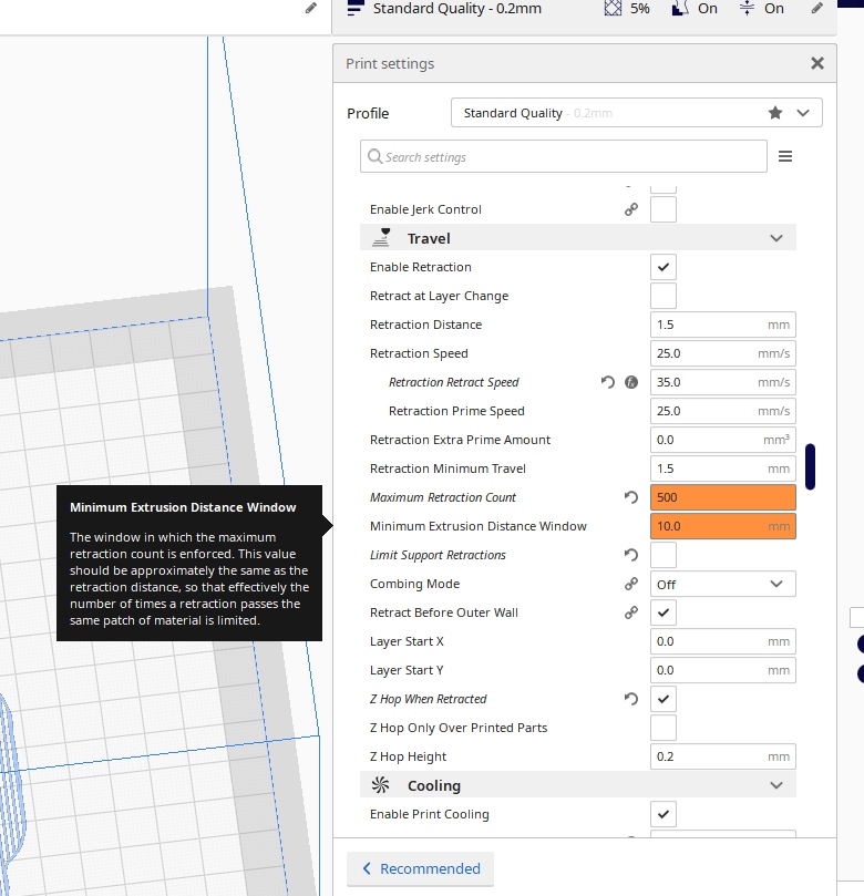

Cura's 'retraction hell' - no idea what you are talking about. There are
settings to reduce retractions, so that the filament is not ground by
the feed wheels, and there are plenty of tutorials on line (in the
search engine of your choice, just enter "cura retraction settings" and
read a few of them to get the idea). and for a shape like this there
should be few retractions. As I keep saying, you need to set the printer
up properly for your filament, and then you need to make the correct
adjustments, temperature, cooling, speed, etc,. within cura (or any
other slicer).
I've attached a jpeg of the cura retraction settings area, and if you
install the settings guide extension, you'll get a clue about their
function. I expect combing mode would help.
hth
Best wishes,
Ray
Combing is off, as it seems to enhance the buildup of plastic on the
bottom of the nozzle when squirting petg, eventually catching and
destroying the job.
destroying the job.
