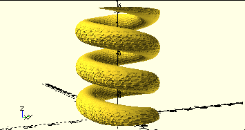

The geometry always makes my head hurt, but it turns out that
linear_extrude twisting is not a good way to make screw threads.
I've continued to think about this, for my own understanding.
Consider the simple cylindrical helix (cribbed from a BOSL2 example), a
spring shape:
That's not a screw thread, but it has some similarities.
Now, can we create that using a twisted linear extrude?
Clearly not, because of the ends - it begins and ends with a horizontal
cross-section of a single point, and until the top of the cylinder every
cross-section is a different shape.

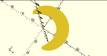

But what if we ignore the ends?  The cross-section in the middle is
constant, no?
Yes, it is:
I'm sure that shape can be derived mathematically.  I'm also sure that I
can't do it, at least not off the top of my head.

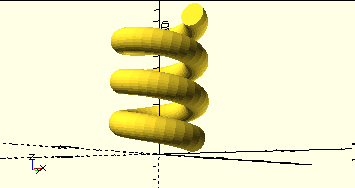

But can we then linear-extrude that with a twist to form the helix?
Sort of.

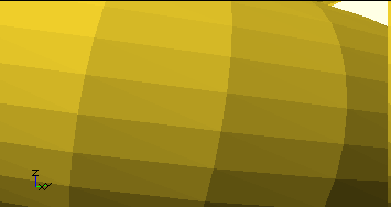

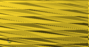

What's with that scaly surface?
Here's a close-up:
Looks like issues with exactly how linear_extrude triangulates the
surface.  I don't remember the details, but I've looked at that before.
My dim recollection is that it's not technically wrong, but it isn't
exactly right either.

Net, it looks like you can sort of generate that kind of shape using
linear extrusion, but it won't be easy and the result may not be optimal.
For those who want to play on their own, here's the program that I
used.  It's adapted from Example 22 at
https://github.com/revarbat/BOSL2/wiki/skin.scad#functionmodule-path_sweep .
function helix(t) = [30 * cos(3 * 360 * t),
                     30 * sin(3 * 360 * t),
                     100 * (1 - t)];
helix_steps = 100;
helix = [for (i=[0:helix_steps]) helix(i/helix_steps)];
c = translate([0,11,0],circle(10));
path_sweep(c, helix, method="natural");
//projection(cut=true) translate([0,0,-40]) path_sweep(c, helix, method="natural");
//linear_extrude(height=100, twist=3*360) projection(cut=true) translate([0,0,-40]) path_sweep(c, helix, method="natural");
