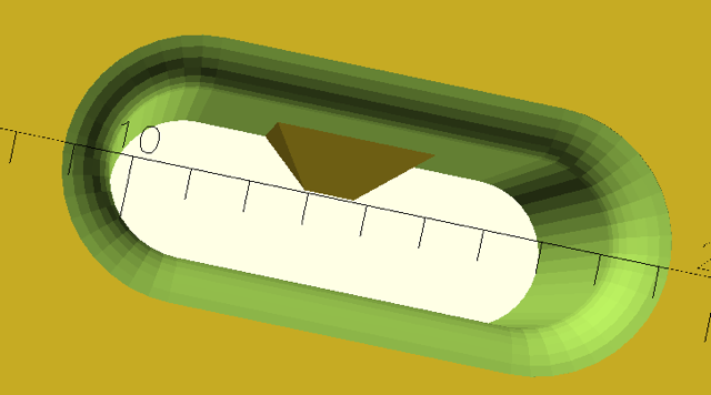

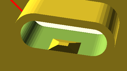

My design requires very accurate holes for connectors like USB, HDMI, etc. They should have enough friction (~0.2mm) but not too much, the tolerances in the connectors and the printer are very complicated to handle.
Really?  I don't know anything about the design process there, but as a user it seems like the critical tolerances are all in the metal-on-metal interfaces supplied by the connectors themselves.  I don't think I've ever seen (or at least have never noticed) a product where the plastic is part of the mechanical connection.
No, the plastic has to hold the connector and needs to provide enough smoothness to easily insert but enough friction to not fall out. I now use a little wedge at the end to create more friction. I tried many different ways.
Make the whole hole smaller,
Make it only smaller on x or y,
Add an elastic clip that pushes on the connector,
etc.
The small wedge seems to work best and seems to work on my Ultimaker S3 in the different resolutions I tried out with Tough PLA and will use PC today because this is closer to the material in Injection Molding (IM). However, concerned how this works out with IM.
Suggestions welcome.

I also came to the conclusion that the right way is to prototype with FDM and then do the extra mile to make a design optimized for IM. The high cost and long delays of the mold make this a necessity.
However, I'd like to keep the impedance between these models as small as possible because, based on the same principle, and depending on the success of the first one, I have two more down the line. I also like it because it allows me to formally capture the learning you always do in these proceses.
I am new to this world and in my naive way as a software developer I assumed that a 3D model is a 3D model. I worked in printing during the 80's and PDF was a godsend. Before PDF we had to send horribly complex instructions to the typesetters, being aware of the most intricate attributes of the type setter. PDF changed the game by creating a standard that described the perfect page regardless of resolution. You could print it on a stamp or you could print it on football field and the latter would still show perfect resolution. After PDF the typesetters took over the responsibility to print a page as close as possible to this perfect description. We could just focus on the perfect description.
Since this is 40 years ago I'd expected that a similar model was also present in the 3D world. I realize that 3D models are seriously more complicated but still it was a shock how primitive it seems.
Was a surprise ... but I've no choice but to live with this.

Fri, Sep 6, 2024 8:48 AM
On 9/5/24 04:32, Peter Kriens via Discuss wrote:
On 4 Sep 2024, at 17:31, Jordan Brown openscad@jordan.maileater.net
handle.
different ways.
  • Make the whole hole smaller,
  • Make it only smaller on x or y,
  • Add an elastic clip that pushes on the connector,
  • etc.
today
Can your printer get hot enough for PC? I had to modify an Ender5Plus to
get it hot enough for PC, needs a 280C nozzle and 120C bed to Just Print
PC. Bed booster and 800 watts at 32 volts.  New hot end.  And 280C is
right at the HE ratings.
