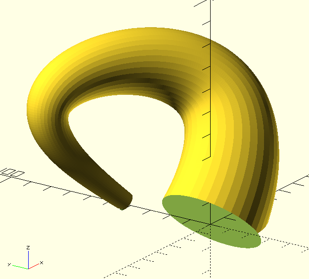

I want to make horns similar to those shown in the first screen capture,
below.
I started out with sweep() but could not see how to incorporate scaling
into that approach.  I hacked the sweep.scad module so that the global
shape() function was called inside sweep() (rather than passing the
output of shape() into sweep() as a parameter), so that I could return
shapes which scaled during the sweep.
That approach (although ugly/hacky) worked to some extent.  But since
what I really wanted was a hollow horn, things fell apart when I tried
to create two horns with different scales, so that I could subtract the
inner from the outer.  With only one global shape() function available,
the only way I could see to make this work was to duplicate the sweep()
code so that I could use two global shape() functions.  I felt as if I
was heading towards hacking hell.  Simple use of scale() failed because
I need the path to remain unscaled while the object that is being swept
is scaled.
I tried to use Ronaldo's sweep-with-easing approach (although I never
understood what "easing" was).  The result is unacceptable because the
shapes used are always horizontal: they do not rotate to stay orthogonal
to the path.  Perhaps this is due to errors in my approach (code is below).
In addition, I was unable to get the horn shapes to have caps on the ends.
I gave up on hollow horns, and made them solid, figuring that I would be
able to hollow them out with MeshMixer (annoying, but acceptable).  But
the STLs created were so damaged that neither MeshMixer nor NetFabb were
able to repair them.
I feel as if I am flailing about randomly.  Perhaps one of you can point
me in a more productive direction.
Thanks!

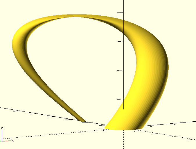

Jon,
let me remark some things before giving you advice.
  1. your code produces self-intersection. Check this with F12. It will never
    pass CGAL
    http://forum.openscad.org/file/t887/jon1.png
  2. I have noticed that current dev snapshots have a bug concerning the use
    of rotated polygons as start/end shapes of sweeps. Unavoidable non-planarity
    leads to CGAL-errors. https://github.com/openscad/openscad/issues/2246

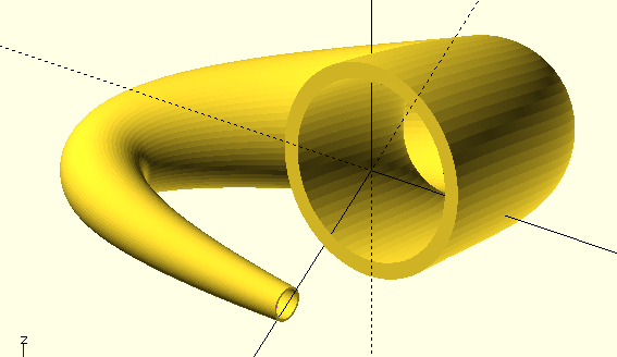

  3. some years ago I have played with the version of sweep you are currently
    using, but felt finally that its implicit restriction to using a certain
    basic shape is too restrictive for my purposes. Therefore I developed my own
    version, which you should know. It expects a vector of polygons placed in 3D
    and skins it, just like skin().
  4. here a simple animation showing a bulb walking through a pipe.
    Uncommenting the first call showes, how the polygons are constructed and
    placed in 3D space. Uncommenting the second call and enabling animation
    (e.g. 10/100) shows the animation of a bubble wandering through a pipe.
use <Naca_sweep.scad> // https://www.thingiverse.com/thing:900137
w = 40;
// sweep(trajectory(10), showslices = true); // view polygons as slices
// w = $t*90-10; animated();
module animated()
sweep(trajectory(10));
sweep(trajectory(9, 14));
function trajectory(r0 = 10, r1=15, N = 20) =  [for(i=[0:N-1])
let(angle = 90/N*i)
let(r = max(r0, bulb(r1, 1.9, w-angle)))
Ry_(angle, Tx_(100, vec3D(circle(r))))];
function circle(r, N=20) = [for(i=[0:N-1]) r*[sin(360/Ni), cos(360/Ni)]];
function bulb(r, scale=1, x) =  abs(x)<r?scalesqrt(rr-x*x):0;

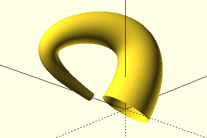

If understood correctly your code, your variable my_path is a prebuilt transform path for sweep that does not include the necessary rotations of the sections to make them orthogonal to the path. That is why the sections are all parallel to plane xy after sweep. In the following code, I separate the path from the shape transform sequence you want to apply at each path point. And I define a function path_shape_transforms(), based on construct_transform_path(), that takes in account a shape transform sequence besides the path itself. bottom_w = 120; top_w = 3; height = 120; steps = 360; pathstep = height/steps; delt = top_w - bottom_w; path = [ for (i=[0:steps]) [18*sin(i), 18-18*cos(i*0.7), 36*sin(i/2)] ]; shtransf = [ for (i=[0:steps]) scaling([11 * (1.2 - i/steps), 11 * (1.2 - i/steps), 1]) * rotation([0,0, steps]) ]; square_points = square(1); circle_points = circle(r=0.5, $fn=60); ptrans = path_shape_transforms(path, shtransf); sweep(circle_points, ptrans); function path_shape_transforms(path, shape_transf, closed=false, tangts) = let( l = len(path), tangents = tangts==undef ? tangent_path(path, closed) : tangts, local_rotations = minimizing_rotations(concat([[0,0,1]], tangents)), rotations = accumulate_rotations(local_rotations), twist = closed ? calculate_twist(rotations[0], rotations[l-1]) : 0 , rt = [ for (i = [0:l-1]) construct_rt(rotations[i], path[i]) * rotation( [0, 0, twist*i/(l-1)] ) ] ) [for (i = [0:l-1]) rt[i]*shape_transf[i] ]; function square(l) = [ [-l/2,-l/2], [-l/2,l/2], [l/2,l/2], [l/2,-l/2] ]; function circle(r) = [for(i=[0:$fn-1]) [cos(360*i/$fn),sin(360*i/$fn)] ]; ​ 2018-01-05 15:21 GMT-02:00 jon <jon@jonbondy.com>: > I want to make horns similar to those shown in the first screen capture, > below. > > I started out with sweep() but could not see how to incorporate scaling > into that approach. I hacked the sweep.scad module so that the global > shape() function was called inside sweep() (rather than passing the output > of shape() into sweep() as a parameter), so that I could return shapes > which scaled during the sweep. > > That approach (although ugly/hacky) worked to some extent. But since what > I really wanted was a hollow horn, things fell apart when I tried to create > two horns with different scales, so that I could subtract the inner from > the outer. With only one global shape() function available, the only way I > could see to make this work was to duplicate the sweep() code so that I > could use two global shape() functions. I felt as if I was heading towards > hacking hell. Simple use of scale() failed because I need the path to > remain unscaled while the object that is being swept is scaled. > > I tried to use Ronaldo's sweep-with-easing approach (although I never > understood what "easing" was). The result is unacceptable because the > shapes used are always horizontal: they do not rotate to stay orthogonal to > the path. Perhaps this is due to errors in my approach (code is below). > > In addition, I was unable to get the horn shapes to have caps on the ends. > > I gave up on hollow horns, and made them solid, figuring that I would be > able to hollow them out with MeshMixer (annoying, but acceptable). But the > STLs created were so damaged that neither MeshMixer nor NetFabb were able > to repair them. > > I feel as if I am flailing about randomly. Perhaps one of you can point > me in a more productive direction. > > Thanks! > > Jon > > > use <sweep.scad> > use <scad-utils/transformations.scad> > use <scad-utils/shapes.scad> > > bottom_w = 120; > top_w = 3; > height = 120; > steps = 360; > > pathstep = height/steps; > delt = top_w - bottom_w; > > square_points = square(1); > circle_points = circle(r=0.5, $fn=60); > > sweep(circle_points, my_path); > > my_path = [ for (i=[0:steps]) > translation([18*sin(i), 18-18*cos(i*0.7), 36*sin(i/2)]) * > scaling([11 * (1.2 - i/steps), 11 * (1.2 - i/steps), 1]) * > rotation([0,0, steps]) ]; > > > > > -- > Sent from my desktop computer. > I do not receive emails while away from my desk, > nor do I receive texts on my main phone number > (which is a land line). > If you know that I am on the road, please text me. > If you know that I am home, please email me. > > > _______________________________________________ > OpenSCAD mailing list > Discuss@lists.openscad.org > http://lists.openscad.org/mailman/listinfo/discuss_lists.openscad.org > >
Fri, Jan 5, 2018 8:07 PM
Parkinbot:
Thanks so much for your time!  I was able to get a solid object out of
this, but when I changed the path to be the one that I am working on,
the top flattened again.  I imagine that I need to rotate the slices
better.  Your example had a fairly simple rotation, one that was easy to
specify.  I guess I need to write code to take two points along the path
and compute the rotations necessary to get the disks oriented properly.

Thank you for your time!  I was able to get "my" shape fairly easily
with your approach, and I could even create two objects (one inside the
other) to make progress toward a hollow shape (that is not just a single
surface).  Unfortunately, I do not see how to get the ends to close up.
I'm not sure that this is necessary if I plunge the two ends into a
solid (like a cube). However, when I just union() the horn surface (not
solid object but surface) with a sphere, the resulting horn is
problematic and cannot be repaired.

Now I want to discuss your question on how to deal with a hollow sweep. My
approach to that is the following:
a) build a skin for the outer surface without cap in a suitable form;
b) build a skin for the inner surface without cap in the same form;
c) build a skin (a polygon) connecting one end of the first skin with one
end of the other skin;
d) do the same with the other end;
e) aggregate those four skins in one polyhedron call.
The suitable form I use for all skins is a polyhedron data format: a pair
of a point list and a facet list. The first two skins are built by
sweep_polyhedron()
(a function you find in my fork code) without caps. The last two skins may
also be built by sweep_polyhedron() applying a round if necessary but it
may be just a annular surface connecting two sections.The last process, I
called the aggregate, is a very general module that receives a list of
polyhedron data, process them and make a call to the polyhedron primitive.

The code bellow illustrates the approach I described before. I had to write
some additional helper functions.
The initial parameters and other functions are as before.
Note that if the inner and outer skins intersect the model will not be
acceptable by CGAL. It is the programmer responsability to avoid this.
Depending on how the shape and path are defined, some surfaces may be
inside out. To correct that sweep_polyhedron() and
annular_polyhedron() have an extra argument, inv, that should be set true
of a point list and a facet list. The first two skins are built by sweep_polyhedron()
below.
what I really wanted was a hollow horn, things fell apart when I tried to
create two horns with different scales, so that I could subtract the inner
from the outer.  With only one global shape() function available, the only
way I could see to make this work was to duplicate the sweep() code so that
I could use two global shape() functions.  I felt as if I was heading
towards hacking hell.  Simple use of scale() failed because I need the path
to remain unscaled while the object that is being swept is scaled.
ends.
to repair them.
Thanks!
