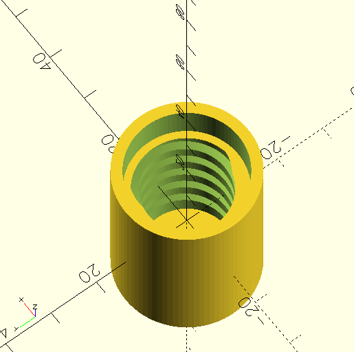

I'm trying to make a helper for lawn bowling, and the first order of
business is to make the attachment to fit a dollar store broom handle.
I have everything but the line with the comment working, and I am
wondering why my final line in the female() module is only rendering
the tube and not the cylinder.
include <BOSL2/threading.scad>
$fn= $preview ? 60 : 180;
inch=25.4;
female();
acme_threaded_rod(d=19.8, l=40, pitch=5.08);
module female() {
tube(id=17.05,od=22.6,h=25.4);
up(2.3) tube(id=22.7,od=27,h=30);
down(13.65) cylinder(h=1,d=27); // <---- Does not render

It renders for me, but there's very little left after the difference().  I
think the value of 13.65 is not correct.  For a design like this that's not
intended to be symmetrical on z-axis, I suggest anchoring to the X-Y plane
with ANCHOR=BOTTOM arguments.  And use left_half() to see the cross section.

Thanks Dan! Your answer baffled me for a minute, but it led me to the
solution. The Acme threaded rod was sticking down past the part I said
didn't render. Of course it rendered, but was cut out by the threaded
rod.
All good now!

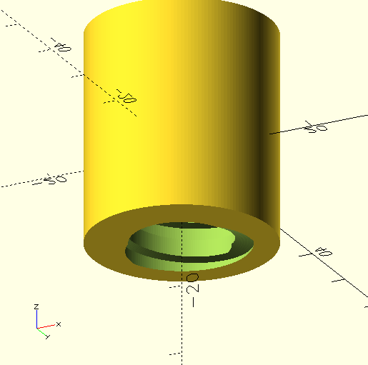

 In which case, just move the problem line up to just after the
closing bracket of the difference.
That would not have worked, as the problem was that the long threaded
rod extended beyond the female part at both ends, so when I added the
solid end, it actually cut it. It was simply a matter of making the rod
shorter and positioning it properly.
Here's the code that works...
female();
up(2.5) acme_threaded_rod(d=19.8, l=30, pitch=5.08);
module female() {
up(2.3) tube(id=22.7,od=27,h=35);
down(15.18)cylinder(h=2.5,d=27);

nut into a block. 2 start threads then makes 2 identical half nuts.
Probably a better method, Gene, but I think I'll try my plan first.
The final results will be modified forms of these:
https://www.mastersofgames.com/cat/bowls/ubi-launcher-bowls-delivery-aid.htm
https://www.mastersofgames.com/cat/bowls/bowling-arm.htm
The part in my code was only a test to experiment with fit. the top
outer cylinder will be about 100mm long, and will serve to attach (in
the case of the UBI Launcher), wings connecting to the business end in
order to strengthen the part that pushes the bowl. The way I envision
it, printing it at an angle to orient the layer lines for strength,
should be strong enough.
The 'bowling arm' is the easiest one to use, and I think I can make it
strong enough.
