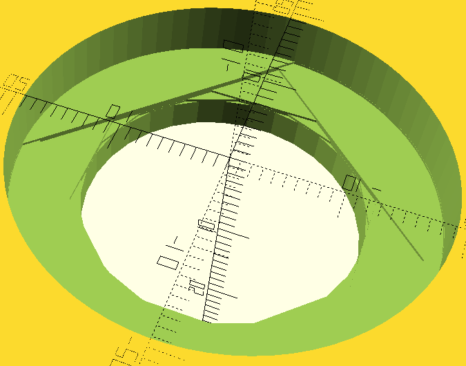

The problem seems to be caused by very close edges in a stack of polygons
with different numbers of vertices.Each polygon has its radius defined by r
/ cos(180 / fn) so that the flat sides line up. But of course they don't
line up exactly when 180 / n is an angle that makes cos return an
irrational. Making each one smaller by 1/128 so they never line up exactly
AND adding a render() around the stack fixes it.
This is for generating hanging holes that print in mid air without support
material.
I think something must snap the vertices and break the topology during F5
and that gets cached and breaks F6. I don't understand why render doesn't
fix it though. It seems geometry generated by render() is different under
F5 than it is with F6 but I thought render() was supposed to do the same as
F6 for that sub tree. Perhaps that is something that could be fixed, so at
least just render() is a work around. I think the underlying problems is
using three number systems and not doing topologically aware conversions
from one to another.

The problem seems to be caused by very close edges in a stack of polygons with different numbers of vertices.Each polygon has its radius defined by r / cos(180 / fn) so that the flat sides line up. But of course they don't line up exactly when 180 / n is an angle that makes cos return an irrational. Making each one smaller by 1/128 so they never line up exactly AND adding a render() around the stack fixes it. This is for generating hanging holes that print in mid air without support material. [image: image.png] I think something must snap the vertices and break the topology during F5 and that gets cached and breaks F6. I don't understand why render doesn't fix it though. It seems geometry generated by render() is different under F5 than it is with F6 but I thought render() was supposed to do the same as F6 for that sub tree. Perhaps that is something that could be fixed, so at least just render() is a work around. I think the underlying problems is using three number systems and not doing topologically aware conversions from one to another. On Wed, 2 Jan 2019 at 23:35, nop head <nop.head@gmail.com> wrote: > I though that putting render() around it to force CGAL during F5 would fix > the problem but it doesn't. > > The problematic code is a stack of linear extrudes unioned together. > > On Wed, 2 Jan 2019 at 21:20, Marius Kintel <kintel@kintel.net> wrote: > >> Argh, yes, I think this is a bug triggered by an optimization trying to >> avoid using CGAL where not necessary. >> >> -Marius >> >> > On Jan 2, 2019, at 13:17, nop head <nop.head@gmail.com> wrote: >> > >> > I am running into this error on F6 unless I flush the cache after the >> preview. >> > >> > ERROR: CGAL error in CGAL_Nef_polyhedron3(): CGAL ERROR: assertion >> violation! Expr: e_below != SHalfedge_handle() File: >> /mxe/usr/x86_64-w64-mingw32.static.posix/include/CGAL/Nef_3/SNC_FM_decorator.h >> Line: 426 >> > >> > Anybody know what causes it? I have vague recollection of it being >> something to do with caching an inexact value during the preview. >> > >> > >> > _______________________________________________ >> > OpenSCAD mailing list >> > Discuss@lists.openscad.org >> > http://lists.openscad.org/mailman/listinfo/discuss_lists.openscad.org >> >> >> _______________________________________________ >> OpenSCAD mailing list >> Discuss@lists.openscad.org >> http://lists.openscad.org/mailman/listinfo/discuss_lists.openscad.org >> >
Thu, Jan 3, 2019 11:20 AM
Actually when I eliminated all the nearly coincident edges it don't need a
render().
