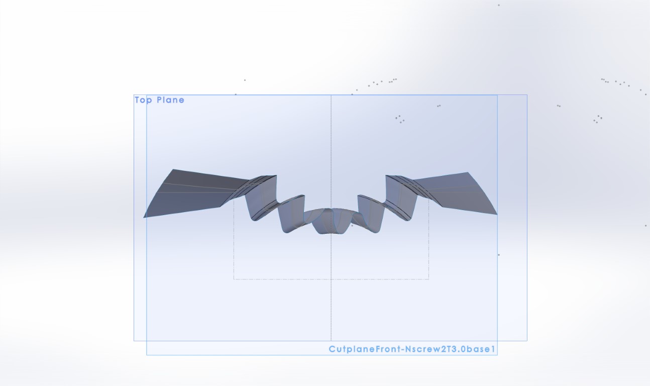

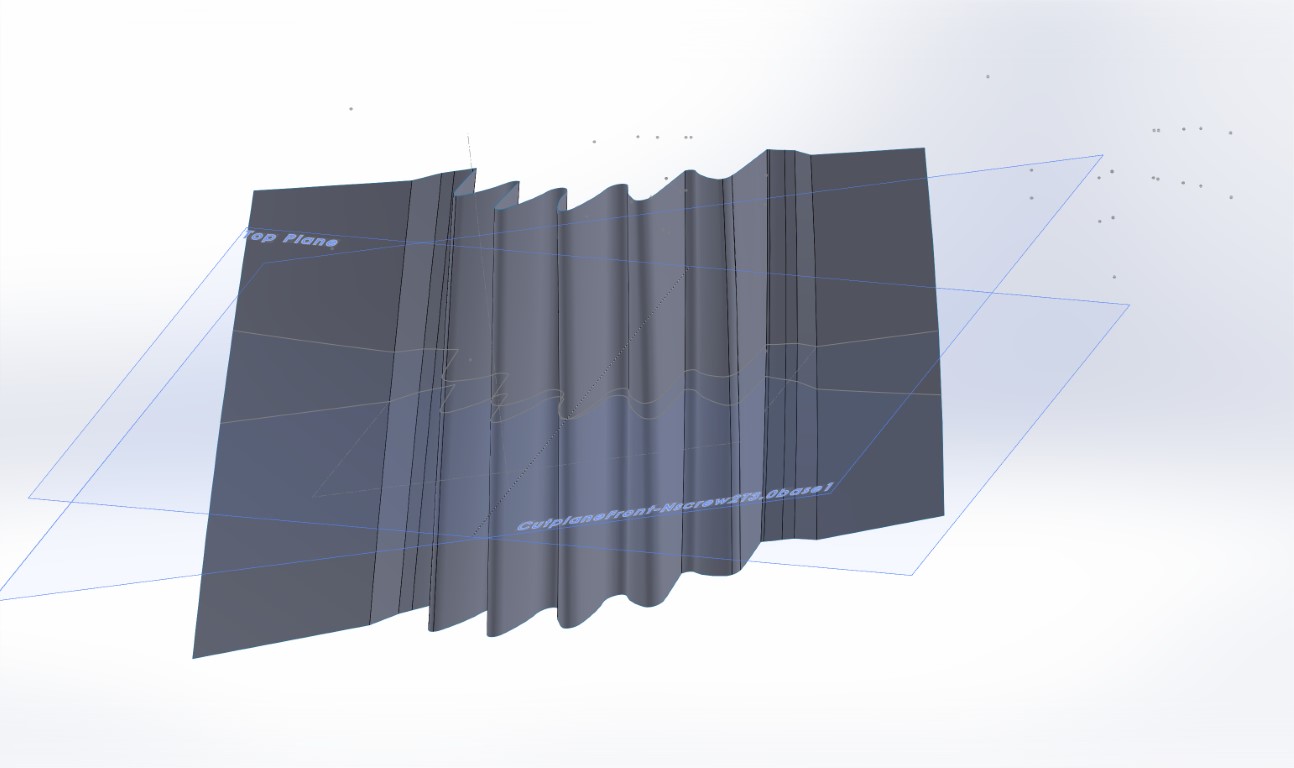

Just to explain with pictures:
Here is the kind of surface that I have to create.
The surface profile is defined from a cut of the part along the plane labelled ‘Cutplane’ It is rotated about 12° from the top plane.
The section on the cut plane is obtained by the projection(cut=true) method.
The surface follows an helix with an axis perpendicular to the top plane. The only way to create an extrude object with a twist in OpenSCAD is to use the section in the top plane (XY plane). and extrude it, so I need to ‘project’ the cut plane section on the top plane to get the primitive for the extrusion, while staying on the twisted surface. Here is a top view to see the difference of the sections.
So the section on the XY plane has to be derived from the section on the cut plane following an helical path of known center and pitch. It’s easy to calculate as the plane’s intersection is going through the helix axis.
So if exporting the DXF is the only way to get the data of the cut plane section, I will go through this…

I think you're exceeding my ability to visualize 3D operations.
I think that what you're saying is that you have a polygon that is
tilted from the XY plane, and that what you want is to screw that
polygon down along a helical path and record the shape that it draws as
it passes through the XY plane.
Is that sort of right?
If so, yeah, sorry, no idea how to do it.
