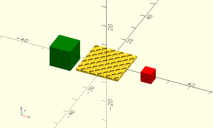

Please try out namespaces for yourself and add feedback on the pull
request. More syntax examples available at the pull request page.
namespace bosl2 {
} import_specials;
using bosl2;
textured_tile("trunc_diamonds", 20, tex_reps=[5,5]);
module cuboid(s) {
  bosl2::cuboid(s/2);
color("green") left(20) bosl2::cuboid(10);
color("red") right(20) cuboid(10);

I can already write code that functions like this (I would call my
cuboid() "MyCuboid()"), but is much less complex.  Is this only
compelling if I need to use two different libraries which have
accidentally used the same name for different purposes?  Is this solving
problems for library creators or library users?

On 9/7/25 2:18 AM, Jon Bondy via Discuss wrote:
Is this only compelling if I need to use two different libraries which
have accidentally used the same name for different purposes?
It's certainly useful for that.
  Is this solving problems for library creators or library users?
Every time you create something you want to reuse in another design, you
are a library creator too!
-Cory
It's solving problems for library creators because when they add a new
function they don't have to worry about it colliding with a function in
some user's program.
It's solving problems for library users because when they add a new
function they don't have to worry about it colliding with a library's
function... including the function that the library adds in its next update.
("function" here really includes functions, modules, variables, and
hopefully special variables.)
Indeed, namespacing is very similar to slapping a prefix on every name.
The major differences are that inside the declaration you don't need to
keep repeating the prefix, and if there's a "using" mechanism (as Cory
proposes) then a caller can automatically add the prefix too.
BTW, while it's fairly unlikely that two libraries will use the same
name for different purposes, it's not at all unlikely that they will use
the same name for the same purpose, but with slightly different
arguments, return values, et cetera.  Two libraries might well define
regular_polygon(), but is it regular_polygon(size, sides) or
regular_polygon(sides, size)?  Or is it "vertexes" instead of "sides"?
