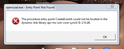

Sadly, none of the suggestions achieve what I need :-(
I tried downloading the latest x64 dev snapshot and it failed with :-
... so, going back to the last stable.
I am running under Win 7 x64 Pro with 8G of memory. The fact that the output STL file is OK wont stop me proceeding but the lack of a reliable preview is very irritating.
