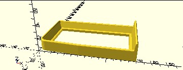

Now another problem was occurred (like the second structure above)
but now allways
What does this mean?
It means exactly what it says, that there was no geometry, that nothing
ever generated any geometric objects.
When I F6 your program I get:
WARNING: Ignoring 2D child object for 3D operation in file , line 19
Rendering cancelled on first warning.
Line 19 is a polygon() call.  Polygons are 2-dimensional.  (They display
in preview with some thickness, but that's for preview only.)  You have
to make them be three-dimensional before they can be part of your model.
Because I have OpenSCAD set to stop on the first warning, it aborts and
generates nothing.  (I suspect that the top-level union fails.)
This particular "polygon" isn't even a real polygon.  It only has two
points:  [[140, 85], [140, 0]]
When I comment that polygon() call out, I get a successful render.
