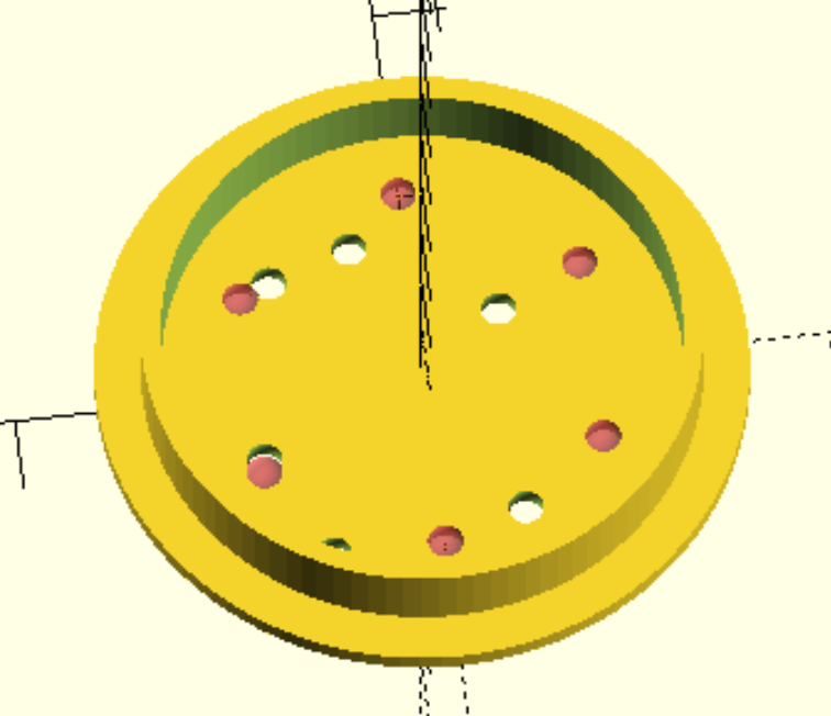

Dear all
...... this is the way a non programmer works.. but it is painful. :-(
include <bosl2/std.scad>
$fn=100;
id=55; //Innendurchmesser
od=64; //Außendurchmesser
h=10;  //Höhe über Alles
s=2;   //Stärke
translate([0,0,h/2+s/2])
tube(h=h-s, or=id/2, wall=s);
cylinder(s,d=od);
    translate([-id/20.7,id/20.4,s0.5]) sphere(r=2);
    translate([-id/2
0.3,id/20.6,s0.5]) sphere(r=2);
    translate([id/20.4,id/20.5,s0.5]) sphere(r=2);
    translate([id/2
0.5,id/20.2,s0.5]) sphere(r=2);
    translate([id/20.2,-id/20.3,s0.5]) sphere(r=2);
    translate([-id/2
0.6,id/2*-0.3,s*0.5]) sphere(r=2);
How can I manage to get a valid array of coordinates which are all
within a defined circle with a diameter of n?
Many thanks in advance
Karl
P.S.

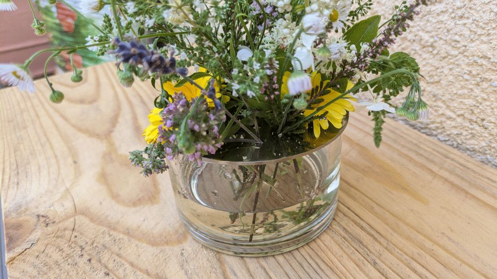

the goal is to print a kind of lid for different sizes of glasses... to
use them as vase for small flowers.

This line of code replaces your six lines to make the spheres:
for (angle = [0:60:300]) { rotate([0, 0, angle]) translate([-id/20.7,0,
0.5
s]) sphere(2);}

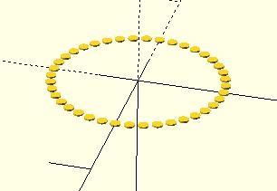

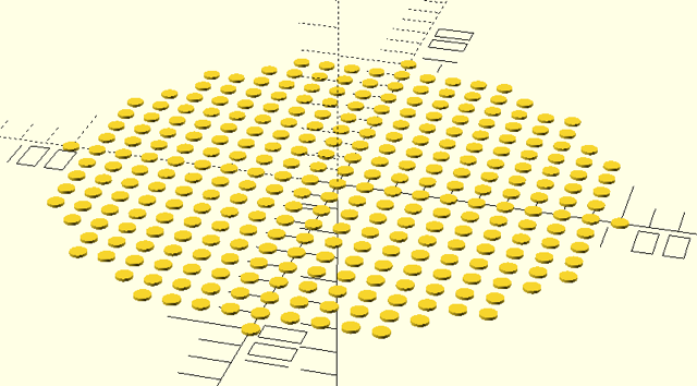

I see you use BOSL2. Library is quite amazing. Spent the last 4 days trying to get my head around it and I feel I am barely touching the surface.
However, if you are you looking for a grid:
grid_copies(10, inside=circle(100)) cyl(d=5,h=1);
Or just along the edge?
arc_copies(d=100,n=40) circle(3);
if you just want the vectors:
path=arc(n=4,d=100,angle=360);
echo(path);
ECHO: [[50, 0], [-25, 43.3013], [-25, -43.3013], [50, 0]]
[image: PastedGraphic-1.png]
[image: PastedGraphic-2.png]
echo(path);
glasses... to use them as vase for small flowers.
<PXL_20240715_100200132.MP.jpg>_______________________________________________

I managed at least using a funny function from BOSL2 ;-) ---> but I am
not convinced from the  randomize results.
Thanks to all for your help
Karl
$fn=100;
s=2;   //Stärke
kl=10;  //Anzahl kleine Löcher
ml=5;   //Anzahl mittelgroße Löcher
gl=3;   //Anzahl große Löcher
kpoints = spherical_random_points(kl,id/20.8);*
kp=path2d(kpoints);
mpoints = spherical_random_points(ml,id/2*0.8);
mp=path2d(mpoints);
gpoints = spherical_random_points(gl,id/2*0.8);
gp=path2d(gpoints);
translate([0,0,2])
union()
    cylinder(s,d=od);
for(i=[0:kl-1])
   translate(kp[i]) cylinder(h=6,d=2);
for(i=[0:ml-1])
   translate(mp[i]) cylinder(h=6,d=3.5);
for(i=[0:gl-1])
   translate(gp[i]) cylinder(h=6,d=5);
