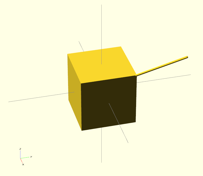

Isn't it the other way round ?, i.e. X first Z last so
rotate([0,0,45]) rotate([0,45,0]) rotate([45,0,0])
You’re right, my head was on backwards.
-Marius

I think not if I understand the question
, because the answer to "Do 3 45° turns of a line in the axis make it a
space diagonal to that octant" is no.
It takes only two rotations, one of 45 and the other of atan(sqrt(0.5)) for
the reason you showed above.
cube(50, center = true);
hull() {
sphere();
rotate([0,-atan(sqrt(0.5)), 45])
 translate([100, 0, 0])
     sphere();

Thank you, atan is the function I was looking for.
After thinking about it, I have understood that it is not possible to rotate
a cube in the way I was visualizing. In that case you would need a different
shape than a cube.
side = 10;
side_half = side/2;
opposite_over_adjacent = side_half / (side_half*sqrt(2));
rotate([45, atan(opposite_over_adjacent), 0])
cube([side, side, side], center = true);
