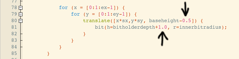

Let us start bit the difference with the two "bits".

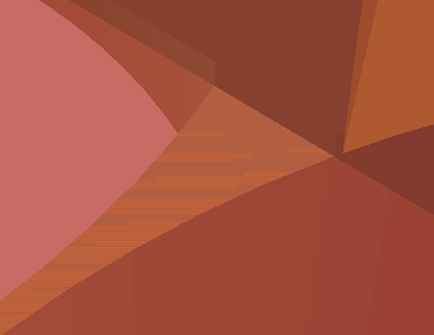

When I add the # modifier, I see Z-Fighting.
Z-Fighting occurs when faces are coincident - OpenSCAD does not like
that as it is not clear whether the surface belongs to the model or not.
Please move the second bit down and make it a longer:
adding the # modifier to if (cover > 0) {
that looks unclean:
so, let us move this cube up a bit:
and also the other cube, but the other cube has to be translated down a bit.

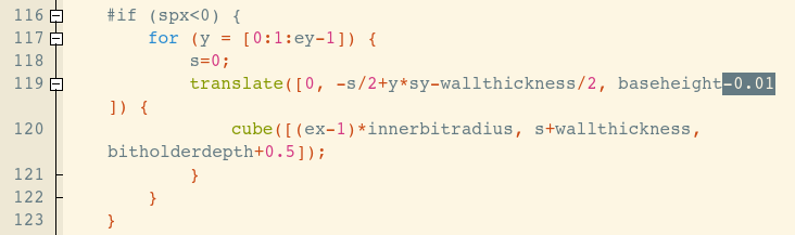

adding the modifier # to if (spx<0) {
again, Z-Fighting:
so, move it down a bit:

Your hexagonal shapes sit directly upon the base. If you lower them by a very
tiny bit, even .001, then they will not be co-planar and will no longer
cause the error.
