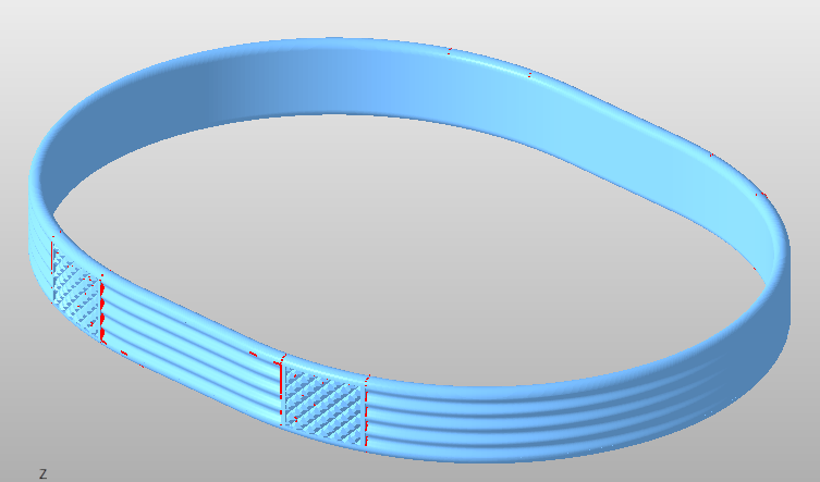

I have a design with some questionable bits in it where I cut a section out
of a ring with a shape that overlaps it and then unions another shape that
is intersected with the same overlapping shape to exactly fill the gap.
Normally I would overlap them but I can't see a way how to in this case
because it is part of a curve. If I extend along the curve I expect the
sides will be nearly coincident but not.
I figured since they are both the same profile cut with the same surface
they should match exactly, but it seems not. But OpenSCAD says the
object is simple and there are two volumes. When I export to STL NetFabb
tells me there are self intersections at the joins, so I tried AMF export
but that still gives the same self intersections. It also takes forever to
export and produces a big file.
So when OpenSCAD says the object is simple does that guarantee it is
manifold without self intersections? If so, why is it still broken in AMF?
export but that still gives the same self intersections. It also takes
forever to export and produces a big file.
AMF takes up more space since it is XML. How long it takes to export
depends on implementation. OFF and OBJ formats are more efficient
(OpenSCAD can export OFF).
Both AMF, OBJ and OFF are better than STL since they include exact
topology and do not require any coordinate matching as STL does.
However, if the model is originally self intersecting, using either
format will not make any difference.
I don't know what "simple" means in this context either. Does OpenSCAD
detect all self-intersections? If it does not, the file format will not
fix it.

The "simple" designation comes from CGAL (got that from reading the source). CGAL generates meshes that are free from self intersection, but the coordinates are represented as infinite precision rational numbers. The process of converting a defect free CGAL mesh to any of the mesh file formats includes: converting the rational numbers to floating point, which perturbs the coordinate values and can introduce self intersections. The conversion process apparently also includes "snapping to a grid" (learned that from forum posts), which can also introduce self intersections. So I think that if CGAL says the mesh is simple, then that does not preclude the exported mesh from containing self intersections. On Sat, Nov 7, 2020, at 4:54 PM, Carsten Arnholm wrote: > On 07.11.2020 22:29, nop head wrote: > > I have a design with some questionable bits in it where I cut a section > > out of a ring with a shape that overlaps it and then unions another > > shape that is intersected with the same overlapping shape to exactly > > fill the gap. Normally I would overlap them but I can't see a way how to > > in this case because it is part of a curve. If I extend along the curve > > I expect the sides will be nearly coincident but not. > > The above does not make any sense to me/not possible to understand. > Maybe you have a code snippet for this? or the AMF/STL? > > > When I export to STL NetFabb > > tells me there are self intersections at the joins, so I tried AMF > > export but that still gives the same self intersections. It also takes > > forever to export and produces a big file. > > AMF takes up more space since it is XML. How long it takes to export > depends on implementation. OFF and OBJ formats are more efficient > (OpenSCAD can export OFF). > > Both AMF, OBJ and OFF are better than STL since they include exact > topology and do not require any coordinate matching as STL does. > However, if the model is originally self intersecting, using either > format will not make any difference. > > > So when OpenSCAD says the object is simple does that guarantee it is > > manifold without self intersections? If so, why is it still broken in AMF? > > I don't know what "simple" means in this context either. Does OpenSCAD > detect all self-intersections? If it does not, the file format will not > fix it. > > Carsten Arnholm > > > _______________________________________________ > OpenSCAD mailing list > Discuss@lists.openscad.org > http://lists.openscad.org/mailman/listinfo/discuss_lists.openscad.org >
Sat, Nov 7, 2020 10:26 PM
Yes it looks like the grid snap breaks it before it gets exported, so it
doesn't make any difference how it is exported. I.e. naively assumed AMF
would preserve the topology from CGAL.

Yes it looks like the grid snap breaks it before it gets exported, so it doesn't make any difference how it is exported. I.e. naively assumed AMF would preserve the topology from CGAL. On Sat, 7 Nov 2020 at 22:14, Doug Moen <doug@moens.org> wrote: > The "simple" designation comes from CGAL (got that from reading the > source). CGAL generates meshes that are free from self intersection, but > the coordinates are represented as infinite precision rational numbers. The > process of converting a defect free CGAL mesh to any of the mesh file > formats includes: converting the rational numbers to floating point, which > perturbs the coordinate values and can introduce self intersections. The > conversion process apparently also includes "snapping to a grid" (learned > that from forum posts), which can also introduce self intersections. So I > think that if CGAL says the mesh is simple, then that does not preclude the > exported mesh from containing self intersections. > > On Sat, Nov 7, 2020, at 4:54 PM, Carsten Arnholm wrote: > > On 07.11.2020 22:29, nop head wrote: > > > I have a design with some questionable bits in it where I cut a > section > > > out of a ring with a shape that overlaps it and then unions another > > > shape that is intersected with the same overlapping shape to exactly > > > fill the gap. Normally I would overlap them but I can't see a way how > to > > > in this case because it is part of a curve. If I extend along the > curve > > > I expect the sides will be nearly coincident but not. > > > > The above does not make any sense to me/not possible to understand. > > Maybe you have a code snippet for this? or the AMF/STL? > > > > > When I export to STL NetFabb > > > tells me there are self intersections at the joins, so I tried AMF > > > export but that still gives the same self intersections. It also takes > > > forever to export and produces a big file. > > > > AMF takes up more space since it is XML. How long it takes to export > > depends on implementation. OFF and OBJ formats are more efficient > > (OpenSCAD can export OFF). > > > > Both AMF, OBJ and OFF are better than STL since they include exact > > topology and do not require any coordinate matching as STL does. > > However, if the model is originally self intersecting, using either > > format will not make any difference. > > > > > So when OpenSCAD says the object is simple does that guarantee it is > > > manifold without self intersections? If so, why is it still broken in > AMF? > > > > I don't know what "simple" means in this context either. Does OpenSCAD > > detect all self-intersections? If it does not, the file format will not > > fix it. > > > > Carsten Arnholm > > > > > > _______________________________________________ > > OpenSCAD mailing list > > Discuss@lists.openscad.org > > http://lists.openscad.org/mailman/listinfo/discuss_lists.openscad.org > > > > _______________________________________________ > OpenSCAD mailing list > Discuss@lists.openscad.org > http://lists.openscad.org/mailman/listinfo/discuss_lists.openscad.org >
Sat, Nov 7, 2020 11:03 PM
Does anybody here know what the grid units are?
It seems like it should be possible to have the grid be far smaller than
any realistic feature on a model, while still being far larger than the
precision of a 64-bit floating point number.  (Measuring a kilometer in
micrometers is only 9 digits; 64-bit floating point is good for 15-16
digits.)

There is no reason to apply "grid snap". In particular, if you export to
a format like AMF, OBJ or OFF, each vertex is represented exactly once
anyway so it makes no sense and can only cause problems.

Yes I think the grid snap causes more problems than it solves, if it solves
any. There are two values both exactly representable in float.
Roughly micrometers and nanometers.
//const double GRID_COARSE = 0.001;
//const double GRID_FINE = 0.000001;
/* Using decimals that are exactly convertible to binary floating point
const double GRID_COARSE = 0.0009765625;
const double GRID_FINE = 0.00000095367431640625;
You can always arrive at vertex separations much smaller than model
features when you start doing CSG. For example if you have a tall thin
cylinder that is tessellated with triangles and you slice a section off the
end where the long thin triangles come to a point. There are lots of other
examples where you can intersect two curves and get arbitrarily close
vertices if you are unlucky.
Also floating point has variable resolution, so if you have small details
far from the origin I think the grid points will merge when truncated to
floats.

I may be partially responsible for the current state of affairs:
https://github.com/openscad/openscad/issues/1107
https://github.com/openscad/openscad/pull/1115
Six years (!) on, perhaps slicers can auto-fix imperfect models with
better results and non-gridded coordinates would work or, at least, not
fail quite so spectacularly.
But, yuch, everything is deeply intertwingled!
