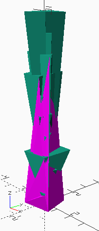

Hello,
I am trying to build a stack of polyhedra with each polyhedron build between
two semi-random 4-edges polygons. Also, the ceiling of a polyhedron is the
floor of the next one.
However I get weird results, and after rendering I get 2D shapes only.
What's wrong?

Some of your faces are inside out.

Wed, Jun 24, 2020 10:19 PM
The easiest way for stacking things that have heights
defined in a list is via a recursive module. As noted
by nophead, the winding order is important, so the
point generation needs to make sure it's clear how
to enumerate in defined way.
// https://gist.github.com/thehans/c1721ba161249ad6830c50f1891af7d0
function cmul(c1,c2) = let(a=c1[0],b=c1[1],c=c2[0],d=c2[1]) [ac-bd, ad+bc];
function cpow(v, n) = n > 0 ? cpow(cmul(v, [0,1]), n - 1) : v;
// generate 4 points in 1st quadrant and rotate so we
// end up with one point in each quadrant in defined
// order
function points(z) = [ for (n = [0:3]) [ each cpow(rands(3, 10, 2), n), z ] ];
faces = [
[0, 1, 2, 3],
for (a = [0:3]) [ 4+a, (1+a)%4, a ],
for (a = [0:3]) [ 4+a, 4+(1+a)%4, (a+1)%4 ],
[7, 6, 5, 4]
module p(heights, bottom, h = 0, i = 0) {
if (i < len(heights)) {
height = h + heights[i];
top = points(height);
polyhedron([ each bottom, each top ], faces);
p(heights, top, height, i + 1);
