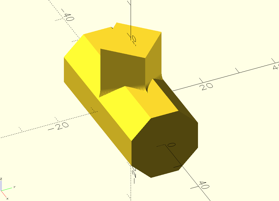

Dear all,
I am trying to join two prisms, a squared one and one with an octagon as base with join_prism to have a fillet at the connecting edges. I don't get it to work in the way I'd like to. I am not sure if I'm doing something wrong or if I don't fully understand the limitations of join_prism.
Please consider the following (extremely simplified!!!) example:
// spin != 0 fails
pathOct = octagon(d = 20, spin = 0);
// size > 8 fails
pathSq = square(size = 8, spin = 45, center = true);
join_prism(
    polygon = pathSq,
    length = 10,
    base = pathOct,
    fillet = 2,
yrot(90)
offset_sweep(
    path = pathOct,
    height = 40,
    anchor = CENTER,

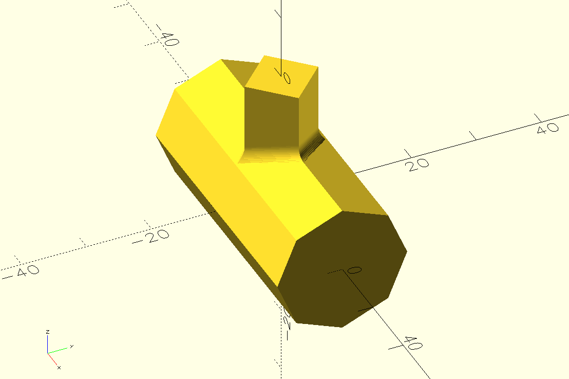

This produces a good looking fillet (first picture). Nonetheless, actually I'd like to increase the size of the square to 12 and turn the octagon around x by 22.5 degrees (flat top and bottom). If I do so, it produces weird fillets that don't cover the connecting edges correctly (second picture).
What Am I doing / understanding wrong?
Best,
Thomas
Correct fillet:
Wrong fillet:
Dear all, I am trying to join two prisms, a squared one and one with an octagon as base with join_prism to have a fillet at the connecting edges. I don't get it to work in the way I'd like to. I am not sure if I'm doing something wrong or if I don't fully understand the limitations of join_prism. Please consider the following (extremely simplified!!!) example: ``` include <BOSL2/std.scad> // spin != 0 fails pathOct = octagon(d = 20, spin = 0); // size > 8 fails pathSq = square(size = 8, spin = 45, center = true); join_prism( polygon = pathSq, length = 10, base = pathOct, fillet = 2, ); yrot(90) offset_sweep( path = pathOct, height = 40, anchor = CENTER, ); ``` This produces a good looking fillet (first picture). Nonetheless, actually I'd like to increase the size of the square to 12 and turn the octagon around x by 22.5 degrees (flat top and bottom). If I do so, it produces weird fillets that don't cover the connecting edges correctly (second picture). What Am I doing / understanding wrong? Best, Thomas Correct fillet: Wrong fillet:

I think the fillets look right. It just seems sharper, because edges
coincide in the "wrong" picture. Try doing an "animation", with the octagon
turning slowly, and/or with the square piece growing, to see how the
fillets grow/change.

Your squares has only four points. Not enough for a good match. You need to
resample the square to have more points.
