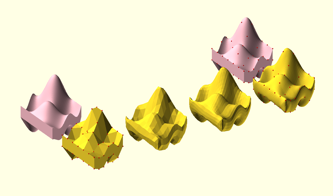

I found a bug that was causing the textures to happen.
This looks interesting
Can you share the reference paper?

Of course.
It was at:
http://www.math.tau.ac.il/~niradyn/papers/butterfly.pdf
but the link isn't super reliable, so I've attached a copy.

Thanks Nathan
Let me read and see what can be done with this new knowledge

Sanjeev & Nathan,
Another potential source for this topic is Gerald Farin's "Curves and
Surfaces for CAGD: a practical guide". When I was looking up the proper
name I found an PDF version online <
https://www.cin.ufpe.br/~mdlm/files/Farin-5a_edicao.pdf> As a note, I
think one of the big additions starting with his 5'th addition was the
introduction of "Blossom" notation (which simplified many of the equations
by a factor of 5 or 10). It has been decades since I took his CAGD class,
and probably have forgotten most of the details, but he has some gems in
there with surface decimation and interpolation.
Hope this helps,
EBo --

Wow
Great and Thanks John for sharing this book
There is a lot to study now for me in next few weekends.
