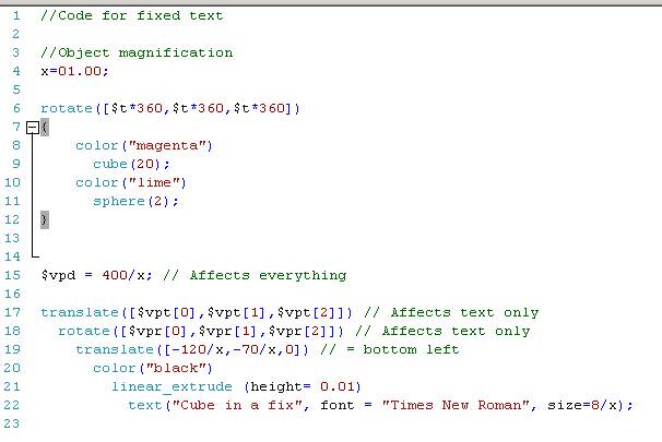

Note that indentation of the code helps understand
which lines affect the next line.
Sequences of code affect the following lines until a ";" terminates that sequence.
e.g. (as an image so email doesn't affect it)

It would work nicely if distance (with $vpd) could be applied to the text
alone, as translate and rotate can, without affecting anything else.
Assigning to $vpd, $vpt and $vpr affect the camera, so that changes the appearance of everything. Reading the values to know where the camera is allows you to position individual objects in a fixed place relative to the camera. There is no need to split up the vectors and join them back together again. [$vpt[0],$vpt[1],$vpt[2]] is just $vpt and can be passed to translate. You assigned to $vpd to specify the zoom, whereas I read $vpd to change the size of position of the text, so it doesn't change. It then doesn't matter if $vpd is changed with GUI or is assigned to. Not sure why you didn't just use the method I posted. On Mon, 26 Oct 2020 at 01:13, MichaelAtOz <oz.at.michael@gmail.com> wrote: > Note that indentation of the code helps understand > > which lines affect the next line. > > Sequences of code affect the following lines until a ";" terminates that > sequence. > > > > e.g. (as an image so email doesn't affect it) > > > > > > > -----Original Message----- > > > From: Discuss [mailto:discuss-bounces@lists.openscad.org] On Behalf Of > Caddiy > > > Sent: Mon, 26 Oct 2020 12:03 > > > To: discuss@lists.openscad.org > > > Subject: Re: [OpenSCAD] Another missing feature? (All I want for > Xmas...) > > > > > > Ah, now it works! Thanks. > > > > > > Window y remains constant and window x can be set to the full width or > minus > > > the preferred editor width. Unfortunately there is no $vpw[0]. > > > > > > I have added translate([-10,10,0]) to get the text out of the extreme > corner > > > and text size=10 (which seems to be the default value) so that I just > have > > > to change the number for bigger or smaller characters. > > > > > > My code, for what it's worth: > > > > > > //Code for fixed text > > > > > > //Object magnification > > > x=01.00; > > > > > > > > > > > > rotate([$t*360,$t*360,$t*360]) > > > { > > > color("magenta") > > > cube(20); > > > color("lime") > > > sphere(2); > > > } > > > > > > > > > > > > > > > $vpd = 400/x; // Affects everything > > > > > > translate([$vpt[0],$vpt[1],$vpt[2]]) // Affects text only > > > > > > rotate([$vpr[0],$vpr[1],$vpr[2]]) // Affects text only > > > > > > > > > translate([-120/x,-70/x,0]) // = bottom left > > > > > > color("black") > > > > > > linear_extrude (height= 0.01) > > > > > > text("Cube in a fix", font = "Times New Roman", size=8/x); > > > > > > > > > It would work nicely if distance (with $vpd) could be applied to the text > > > alone, as translate and rotate can, without affecting anything else. > > > > > > > > > > > > -- > > > Sent from: http://forum.openscad.org/ > > > > > > _______________________________________________ > > > OpenSCAD mailing list > > > Discuss@lists.openscad.org > > > http://lists.openscad.org/mailman/listinfo/discuss_lists.openscad.org > > > <http://www.avg.com/email-signature?utm_medium=email&utm_source=link&utm_campaign=sig-email&utm_content=emailclient> Virus-free. > www.avg.com > <http://www.avg.com/email-signature?utm_medium=email&utm_source=link&utm_campaign=sig-email&utm_content=emailclient> > <#m_-6997805907647189939_DAB4FAD8-2DD7-40BB-A1B8-4E2AA1F9FDF2> > _______________________________________________ > OpenSCAD mailing list > Discuss@lists.openscad.org > http://lists.openscad.org/mailman/listinfo/discuss_lists.openscad.org >
