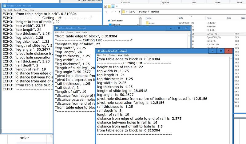

Based on Jordon's post from a few days ago, and my not being too
interested in command line construction/entry, I've written a gui
interface for handling this
openscad -o echo.out --export-format echo echo.scad
If type 'echo' is selected, then an iterative select and replace
function is used, if needed. This can quickly, without much bother,
produce reasonably formatted text for documentation/other purposes,
without needing to use any other mark up/mark down characters within the
echo statements, unless verbose/more formatted echo's are wanted. Of
course, once the echo file has been obtained, then any basic text editor
can easily pretty it up, using search and replace, say. I could also
automatically include random 'and also', 'whereas', 'must be', etc. to
make it appear as more natural English 😁
