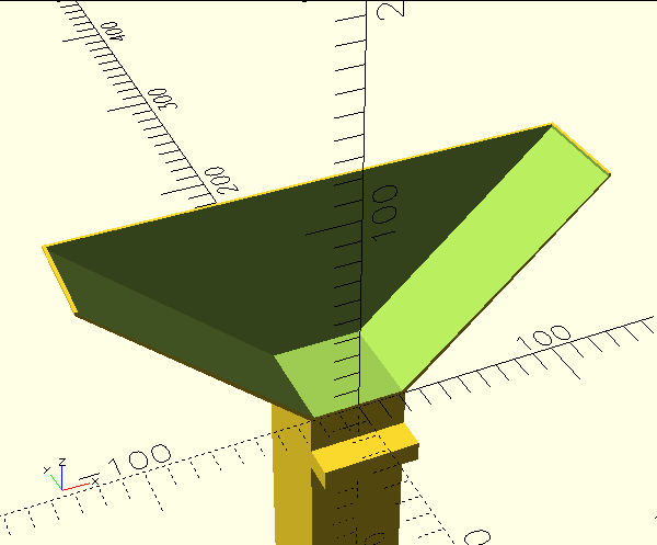

First, I suggest that you carefully examine your base model.  It has a
bunch of Z-fighting in the funnel section that makes it unclear what's
really going on, but when you render it it looks like one side is
totally open.  Then the bottom of the funnel appears to be blocked.  (Or
is it just a shovel, not a funnel?)

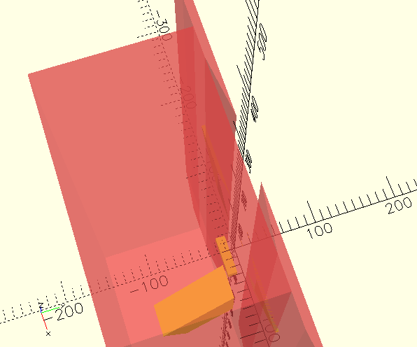

Next, put # in front of one of the cutter() invocations, and look
carefully at the shape it makes.
This is just part2(), with # in front of the cutter() call:

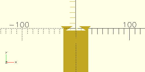

See those skinny triangular-ish shapes?  Those are dovetails.  But
there's only one tooth, and it's very wide and very shallow.
// Finally, setup the dovetail:
// - Teeth count
// - Teeth height
// - Teeth Clearance
teeth = [1, 8, 0];
Yep, one tooth, 8 units tall, and 250 units wide in X.  Something funky
is going on with those teeth, probably caused by the various ratios.
Let's flop the model on its back and try some different dovetail parameters.

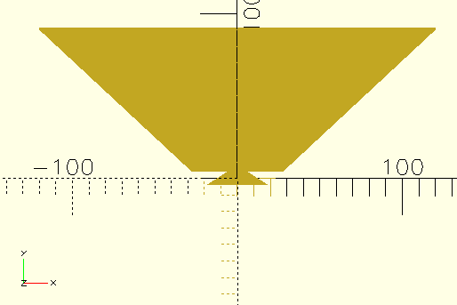

In both part1() and part2():
    rotate([-90,0,0]) whole_model();
That requires rotating the bounding box too:
dimension = [250, 600, 150];
You kind of have to have the bounding box that big, so that the funnel
is inside of it, but it means that to get a reasonable tooth size you
have to have a lot more teeth.
teeth = [5, 8, 0];
Looking from +Z, orthogonal:
Hey, getting close.
Let's look at the two resulting parts, zoomed in on the joint, from +Z
in orthogonal mode...
Looking plausible.  I would be happier if the dovetail tooth was
narrower, but I don't immediately see a way to do that using this library.
