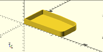

I'm not sure exactly what you're looking for, but here's a stab based on
your basePlate() module.
thickness = 2;
height = 15;
linear_extrude(height=thickness) basePlate();
linear_extrude(height=height) {
        basePlate();
        offset(-thickness) basePlate();
which produces:
By the way, when you have a choice you should work with 2D objects and
then extrude them, rather than working with 3D objects.  Performance is
better and there are fewer strange cases.
I could have done that by extruding the base plate to the full height,
and extruding an offset-in version, and differencing, but there would
have been a Z-fighting artifact at the top if I did it the obvious way.
