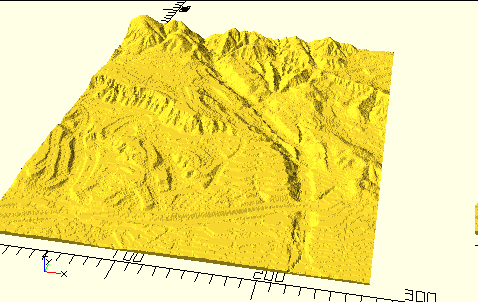

I keep thinking about doing something with USGS 3D Elevation Program
files.
I found a much more convenient source for the data, that will let you
extract whatever chunk you want.
https://portal.opentopography.org/dataCatalog?group=global
They also have some world-wide data.
That came from this guy, who was trying to do something different with
the elevation data:
https://shallowsky.com/blog/2019/Jul/
Here's a snippet extracted from the 1/3 arc-second / 10m data.
Notes:
  • I haven't tried to do anything to get the vertical scale right.  The
    original ends up basically black; I used GIMP Colors/Auto/Stretch
    Contrast to get it to have some visible contrast.  A final toolchain
    would need to do a better job of doing something controlled with the
    vertical scale.
  • I believe that the pixels are 1/3 arc second in each dimension,
    which means that they are taller than they are wide.  I correct for
    that by scaling X by cos(latitude).
  • My first thought was that the scalloping was a contouring artifact,
    but now I suspect that it's real, that it represents areas flattened
    out for lines of houses.
What I did:
  • https://portal.opentopography.org/raster?opentopoID=OTNED.012021.4269.1
  • Use map to select area.
    o Uncheck "generate hillside" if you like.
    o Enter an e-mail address
    o [SUBMIT]
  • Wait just a moment (10-20 sec for small areas) for page to refresh
    with results.
  • Download data (in .tar.gz form, sigh)
  • 7zip to expand the .gz, then expand the .tar, to get a .tif
  • GIMP
    o Colors/Auto/Stretch Contrast
    o crop when it was too big for OpenSCAD
    o Export as PNG
  • OpenSCAD
    o
    scale([cos(latitude),1]) {
        surface("output_USGS10m.png");
