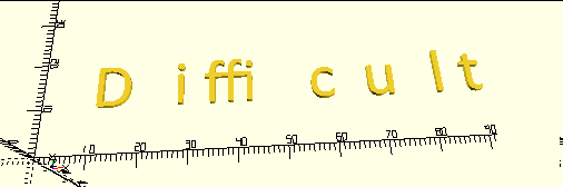

It's a straight multiplier on the "advance" value for each glyph.
Yeah, that can go wrong in a couple of ways.  A series of Ws will get a
lot more space between them than a series of Is.
You might think that it should be a value that's added to the advance
value, but that forgets the fact that OpenSCAD (through HarfBuzz)
supports ligatures.  If you want even weirder spacing, check out
"Difficult" in Calibri:
What's going on there is that "ffi" is compressed down into being one
glyph, and then the extra spacing is applied.  And since the "ffi"
ligature is extra-wide, the extra spacing after it is extra-wide too.
I don't know what the right answer is, but I'm going to draw a line and
say that I'm not going to try to fix it as part of my text metrics project.

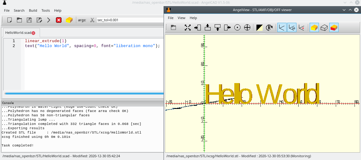

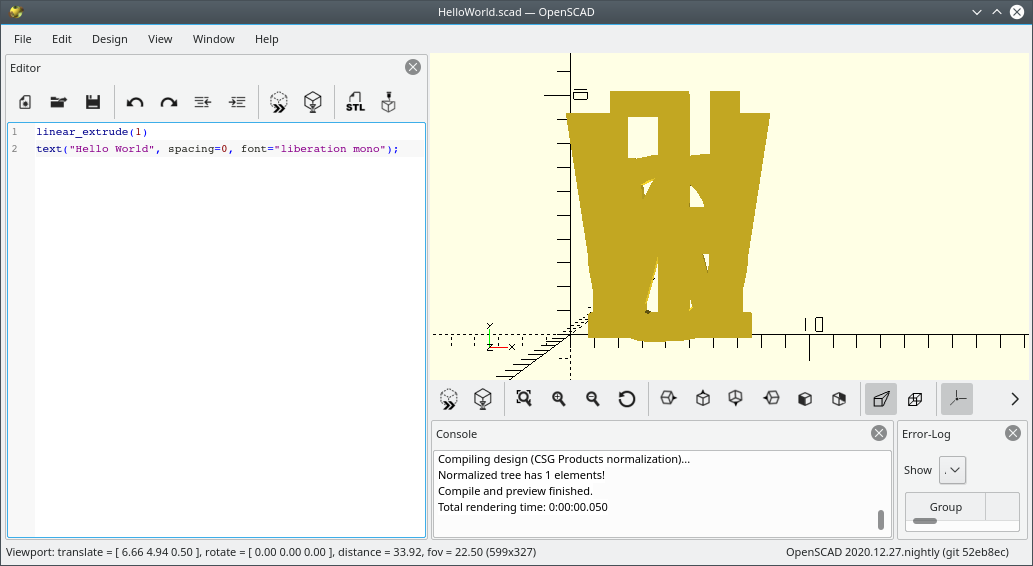

Consider this, I would expect zero spacing between the characters:
linear_extrude(1)
text("Hello World", spacing=0, font="liberation mono");
See attached "openscad_spacing0.png", where all characters are drawn on
top of each other, I don't think that is correct.
Compare with the same .scad code executed in AngelCAD, where you get
zero spacing between characters. I don't claim this to be perfect
either, but it makes much more sense to me.
Crsten Arnholm.

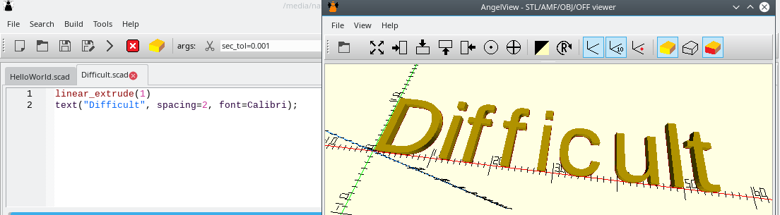

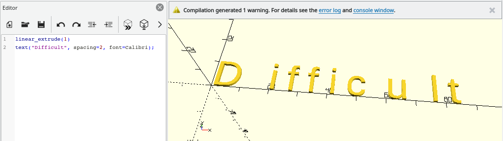

Fist of all, I don't see the ligature effect you are describing, even in
the very latest nightly: OpenSCAD version 2020.12.27.nightly (git
52eb8ec), see attached. That is probably something unreleased you have
added?
The discussion of ligatures seems to be making things more difficult
(pun intended) than required for the purposes of including text in
3d-printing models. What you showed is surely something different from
current OpenSCAD, even the latest nightly, and it does not seem like an
improvement when it comes to spacings.
Compare with the exact same .scad code Executed in AngelCAD 1.5-06
(attached screenshot), it does not need to be any more difficult than
that. AngelCAD does not use HarfBuzz, btw.

First of all, I don't see the ligature effect you are describing, even
in the very latest nightly: OpenSCAD version 2020.12.27.nightly (git
added?
No, it's stock OpenSCAD.  (Right now I'm demonstrating it with 2019.05
on Windows 10.)  But it depends on the font; it only applies to fonts
that have ligature support.  Liberation Sans does not seem to have
ligature support.  I've been testing it with Calibri.
