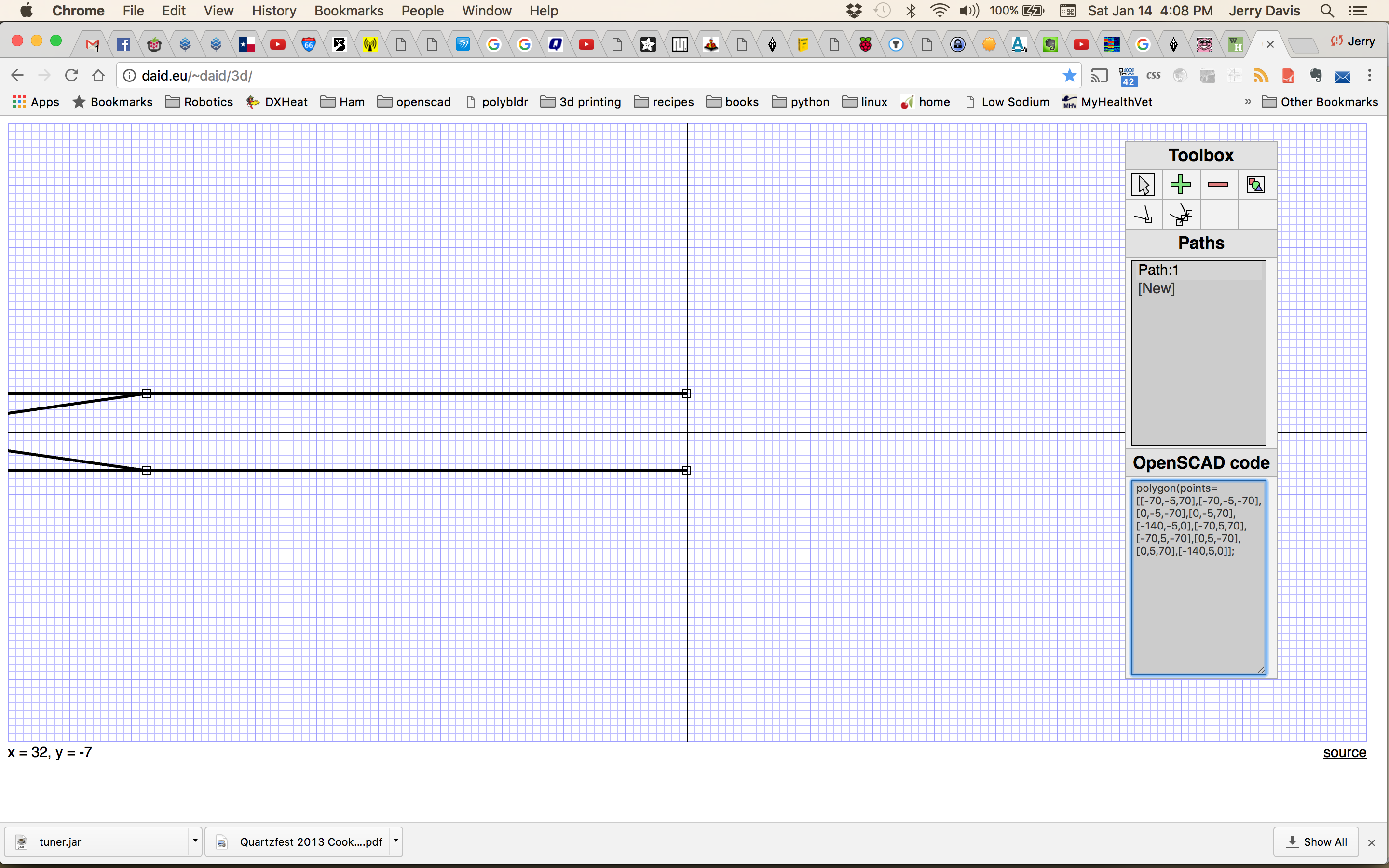

I'm not sure what I'm doing wrong or if this just doesn't work, but I'm
attempting to do the following:
minkowski(){
polyhedron(points=[[-70,-5,70],[-70,-5,-70],[0,-5,-70],[0,-5,70],[-140,-5,0],[-70,5,70],[-70,5,-70],[0,5,-70],[0,5,70],[-140,5,0]],faces=[[0,5,9,4],[6,1,4,9],[1,6,7,2],[7,2,3,8],[3,8,5,0]]);
sphere(10,center=true);
And all I get is a blank page.  I can render the polyhedron and the sphere
independent of the minkowski sum, but when I put it together I get nothing.
Any suggestions?

Your polyhedron is not 2 manifold. It seems to have missing faces and most
of the faces it has are pointing the wrong way.

I put your polyhedron in as a polygon on
and got this image of it.
this would be why.
