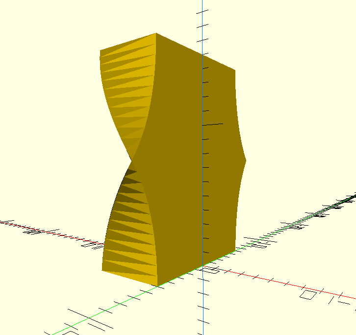

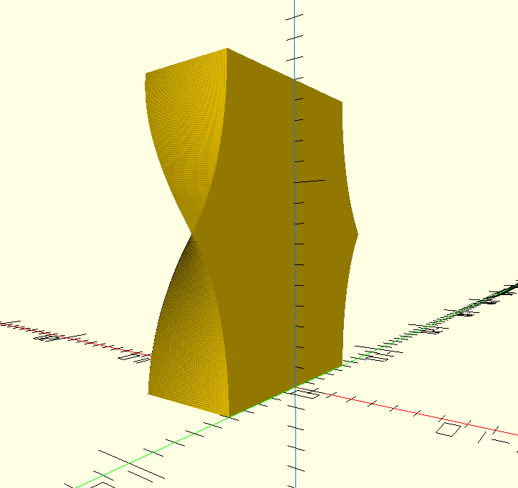

On 27.02.2021 19:38, adrianv wrote:
Is that in a dev version?  Because when I try
intersection(){
  linear_extrude(15, twist=90, convexity=8)
    square(10,center=true);
  translate([50/2,0,0])cube(50,center=true);
I get this pretty terrible result:
I get the same in OpenSCAD 2021.02.27.nightly (git c31925e) under
Kubuntu 18.04
However, if you run the exact same .scad code with no modifications in
AngelCAD, you get the result shown in the attached twist2a.png file.
And, if you run the exact same code again with no modifications, but
specify an external argument "secant_tolerance=0.001" to AngelCAD, you
get the result shown in the attached twist2b.png file.

Interesting, in openscad, if I set $fn=10000; it looks quite nice, (much
larger value  than that and my w10 pc tends towards freezing). Low
values e.g.  $fn=4, could be useful too! However, using $fa or $fs can
not get to a very fine resolution before warning messages are produced.
The $fn value for this object seems to be about 4 times the number of
'slices'.  $fn =1000, I would guess will most likely give the same
result  as for secant_tolerance =0.001 in AngelCAD, and would give more
or less 250 'slices',
Is it the default low $fn value that gives the 'terrible result'?
Yes, for the most part. The required discretization is a function of the
twist angle and any built-in curvature in the model. In this case it is
the wist angle alone.

That's interesting.  I didn't realize you could change the number of slices
with $fn.
But as I have been saying, really long narrow triangles are not really a
good way to model things.
I tried changing $fn to see what it took to make the model look roughly as
good as my model where I subdivide the square, and I think $fn=1000 looks
OK, where there is no longer visible oscillation of the walls.  The
resulting model has 3002 halffacets and 1501 facets.  (What is a halffacet?)
It also doesn't look good because it's sides are a moire pattern of tightly
clustered faces.  And it's not a good way to describe the geometry, with
triangles 15/1000 wide but 10 units long.
In my model I constructed by other methods, I think the visual quality is
good when I subdivide the square into 8 vertices per side.  This gives me
614 halffacets and 307 facets.  So it's 1/5 the amount of geometry.  And
the resulting model looks better.  There's no funny moire pattern.  I can
more clearly tell what the sides are doing.  If I use a division of 5 I get
603 total (half)facets and the model looks only slightly worse.  It's
starting to look distinctly polygonal along the edges, but the polygons are
a good approximation to the curve instead of a zig-zag approximation.
So on the one hand, yes, the default $fn is producing the terrible result.
But selecting a huge $fn gives a sort of tolerable result, not a good one.
It solves the problem in the wrong way, by using a zillion very long narrow
triangles instead of a smaller number of equilateral triangles.
I have this feeling that triangles with high aspect ratio (600 in the case
above) make for bad 3d models computationally.  But I am not sure if this is
true for just printing or representing geometry.  I may be mislead by past
experience in finite element analysis where the triangles need to be local
or they won't be good approximations to the spatially varying variables.  In
this context, you will definitely have problems if you have very long skinny
triangles.  Maybe no problems arise with very skinny triangles e.g. when
passing the model to a slicer?

Well, in the case being discussed here, remeshing skinny triags will not be
of any help. The problem is indeed the implementation of linear_extrude,
where nonplanar quads get triangulated.
in CSG a linear_extrude(10, twist=40) translates with default values to
However, when you specify the slices parameter the CSG will look like this:
Specifying the slices parameter will effect the twist operation only, while
$fn, $fa, $fs will also set a default value for the children of
linear_extrude();
As slices has only a vertical (z-axis) subdivision effect, in many cases it
could be advantageous to also introduce a (horizontal) subdivision scheme as
Adrian showed in his example.
For this, I think it might be worth to make a feature request for a new
"subdivide" parameter defaulting to 0 for backward compatibility and
allowing us to request a horizontal slicing for the twisted linear extrusion
by writing something like:
extrusion by writing something like:
linear_extrude(height = 10, convexity = 3, slices = 30, subdivision = 3) children()
There is already such an open feature request here:
https://github.com/openscad/openscad/issues/3411
The main thing needed is to come to some consensus on the API for such a
feature.  The discussion went a bit off the rails towards the end, but any
fresh thoughts would be welcome.
It sounds like you've suggest to subdivide all edges by a constant factor,
but that seems like a bad idea since you could be extruding this:
square([100,1]);
or even worse something like
hull() { circle(1, fn=$30); translate([100,0]) circle(1, $fn=30) }
You wouldn't want the 1 unit sides of the square to be divided up into 100
pieces or however many times as the long side, and the circle arc segments
would be subdivided even tinier.
Personally I think the best way to do it is to specify a "max edge length",
and split any long edges into however many parts are needed to satisfy that
length.
The max edge length could be a new parameter, or the special variable $fs
could simply be re-used , but I'm not sure if that's the best idea either.
Using $fs would require a way to disable it with a bool flag if that were
done (defaulted to disabled for backwards compatibility).
Another idea I just started to consider would be to make this subdivision /
segmentation of 2D geometry into its own operation, independent of
linear_extrude.  Since it might be useful in some other scenarios.
On a related note, today I finally tracked down the source of the collinear
edge merging and disabled that:
https://github.com/openscad/openscad/pull/3698
So that should at least make user workarounds a bit simpler. (nophead's
solution of perturbing vertices by small amounts would no longer be needed)
Hans

Although disabling the collinear edge merging allows workarounds they may
not be so simple as happens in the case of your hulling of two circles.
The  "max edge length" parameter seems to be the easiest for the users.
Em seg., 1 de mar. de 2021 às 01:58, Hans L thehans@gmail.com escreveu:
On Sun, Feb 28, 2021 at 5:41 PM Parkinbot rudolf@digitaldocument.de
square([100,1]);
length", and split any long edges into however many parts are needed to
satisfy that length.
/ segmentation of 2D geometry into its own operation, independent of
collinear edge merging and disabled that:
Hans
square([100,1]);
Well, in the moment you specify a slices parameter for this example, you
will have to defend the same argument. As the new subdivision parameter is
optional, everyone has the choice whether and how to use it (you also can't
prevent that people use $fn=800 for their designs). Indeed in most cases you
will be able to relax the number of vertical "slices" in favor of a better
horizontal "slicing". So things can only get better. I admit, there will be
pathological cases ... which then still can be solved by skin(). Currently
most designs involving some significant twist suffer from a bad
slices/subdivision ratio.
A more structure sensitive subdivision would require a sophisticated
analysis, and could lead to a granularity = "auto" parameter. I would never
expect such a revolutionary change in OpenSCAD to happen in one step, but it
wouldn't be a serious contradiction to allow for both (using a precedence
rule as it exists for $fn/$fa/$fs).
