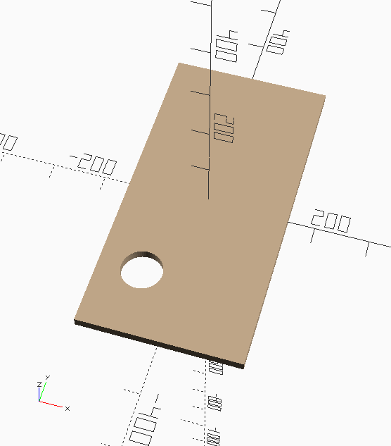

I have some simple code that worked with older versions of OpenSCAD but
doesn't work with OpenSCAD 2021.10.19.ci9029. I can't test later versions
because they don't run on Win7.
It uses a lot of library code but I can take the CSG that produces nothing
on the snapshot and paste it into an older version and it works.

It should produce this:
The 2D version looks correct but disappears when extruded. The sheet is
made by my sheet_2D()
https://github.com/nophead/NopSCADlib/blob/master/vitamins/sheet.scad#L61
module that makes sheets with square, rounded or chamfered corners. It only
fails when the corners are square, and it only fails when a hole is cut out
of it. So it seems to be a combination of difference, hull and linear
extrude.

If I replace sheet_2D with a square it works, or if I have minute radii or
chamfers it works. It also works if I comment out the holes for one side or
the other. It only fails when both sides have holes, so I think it might be
something to do with if and groups() inside difference().
If somebody can test it with a later snapshot I will post a bug report if
it is still broken.

Works for me with 2022.02.23 on Windows 10.

Thanks. Perhaps it is a bug that is already fixed.
