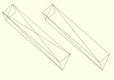

Hi Jordan,
However far you drill down into precision, since we are dealing with
digital computing, and the 'real world' is mainly analogue, there will
eventually be errors, or the necessity for tolerances. There are
apparently half a dozen or so versions of cgal kernels, and some of
them, afaik allow more exact results than manifold.
In my DSL, I  use EPECK kernel for cgal, it is slow. My 'diff' takes in
a manifold shape, and returns a manifold shape (if possible), so I can't
show exactly what cgal does internally. My 'difference' works purely in
manifold.
But a simple test of two cylinders, one slightly tilted, shows
differences in differences, so to speak.

dm=translate(d,[30,0,0])
show_viewer([c,dm])

you can see the different number of verts/tris  between the cgal and
manifold calculations
and here is the visual comparison between the two meshes c and d. It
shows one face has extra tris and duplicated vertices (well ones that
are combine/ignored in the manifold version).
I've attached the scad output, so if you wish, you can see what the mesh
actually is, in both cases.
Best wishes,
Ray
