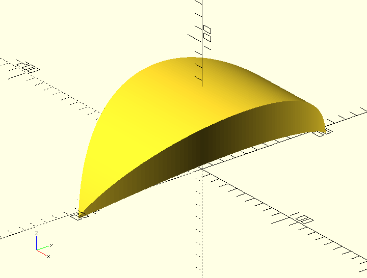

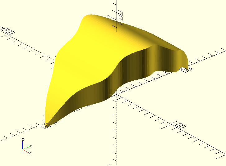

On morphing, I tried it using jons model (scaled up 10x and using
$fn=300 in OpenSCAD). Since all sides are curved in the first place, it
lends itself to easy morphing (to some degree). An image of the original
shape is attached. Example morphing code (angelscript), using the AMF
generated by OpenSCAD:

The second image shows the result. Lots of opportunities with such an
approach...
