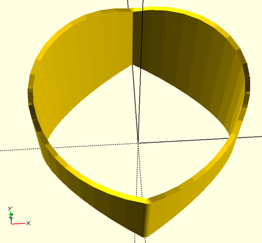

OK, I quickly implemented it and it tends to look good. I think my code
is readable for you, even you might not have some my lib functions
w1 = 35;
res1 = intersect( shape1, shape2, w1, w1);
path3 = Rz(0,concat(mid(res1, 0, 31),
mid(res1, 64, 88),
mid(res1, 146, 177),
mid(res1, 203, 227)
h = 20;
th=2;
max = Max(path3);
sx=(max[0]-th)/max[0];
sy=(max[1]-th)/max[1];
resA = Tz(h/2, path3);      // outer up
resB = S(sx, sy,1, resA);  // inner up
resC = Tz(-h, resB);      // inner down
resD = Tz(-h, resA);      // outer down
// prepare circular walk
path = [for(i=[0:len(resA)-1])[resA[i],resB[i], resC[i], resD[i]]];
dx = 15;
T(dx)sweep(path, close=true);
Rz(180)T(dx)sweep(path, close=true);
echo($vpr);
$vpr =  [w1, 0, 0];
Am 07.03.2025 um 10:31 schrieb Rudolf via Discuss:
not perfect, but I think viable in your case: you can calculate
scalex, scaley values for the 2D shape that keeps the wall thickness
at least at X and Y axis. Scaling only X,Y coordinates provides you an
inner shape with the same number of points and lets you build a
sequence of squares in the second step which you can use to do a
circular extrude around Z instead of linear extruding along Z.

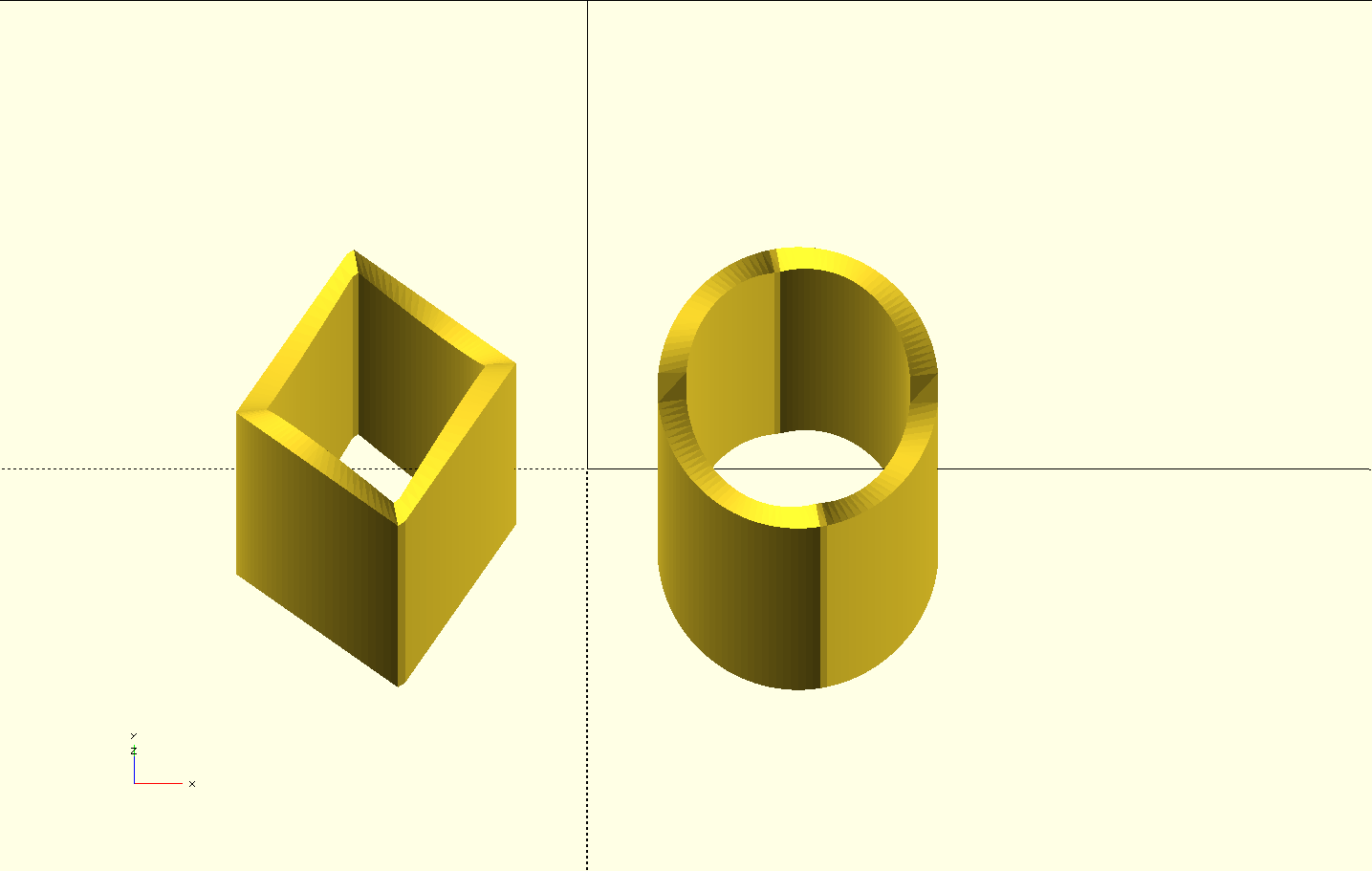

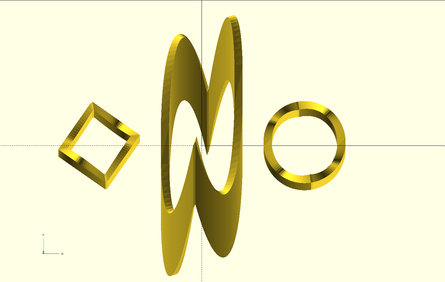

 Hi Peter,
 Adrian was right, it is not such a big drama to compute the
 intersection point of two extruded shapes, as long as they are
 somehow "well-behaved". I extracted the relevant functions and
 modules from my libraries and wrote your function
 *intersect(shape1, shape2, w1, w2)* and some test stuff with
 generic OpenSCAD. Find the scad file attached. The code is
 indeed quite neat and easy to understand. It computes the affine
 intersection of freely translated and rotated 2D-shapes, which
 are assumed to be endless in both directions.
 The function calculates all planes of the faces that delimit
 shape2, intersects each with all lines of shape1 and collects
 and returns only those points that are situated on a face This
 means, two function calls are needed to get hands on all
 intersection points. I leave it up to you to sort the sets
 together. In most cases you will be fine just using the richer set.
 I didn't have the time to protect the code against
 instabilities, mostly singularities from the dot product of two
 parallel vectors. As usual in OpenSCAD tiny-angle rotations or
 tiny-value translations get you around, as shown in the test
 code that produced the second example.
 Hope this helps you along. I'm curious whether it will bring you
 forward with the topology stuff in the paper.
 Rudolf

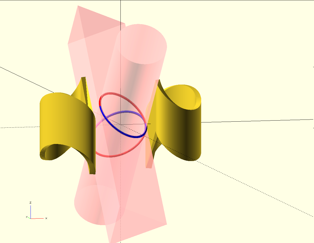

 I am looking for a way to calculate the 3D path where two
 shapes are intersecting. In this case, a shape can be limited
 to a linearly extruded 2D path.
 For example:
 phi = 45;
   rotate([0,phi,0])  rotate([0,0,45]) cube([20,20,80],center=true);
   rotate([0,-phi,0]) cylinder(r=14.2,h=80,center=true);
 I would like to have the 3D path indicated in red ...
 <PastedGraphic-1.png>
 I am looking for something like:
 function intersect( a, b, phi ) = ...
 Where an and b are 2D paths of the 2 shapes and phi is 1/2 the
 intersecting angle for an and b. I understand there are 2, I
 want the one closes to the XY plane.
 I am stuck ... anybody ideas or hints? I am using BOSL2 so any
 use of the built in functions would be great.

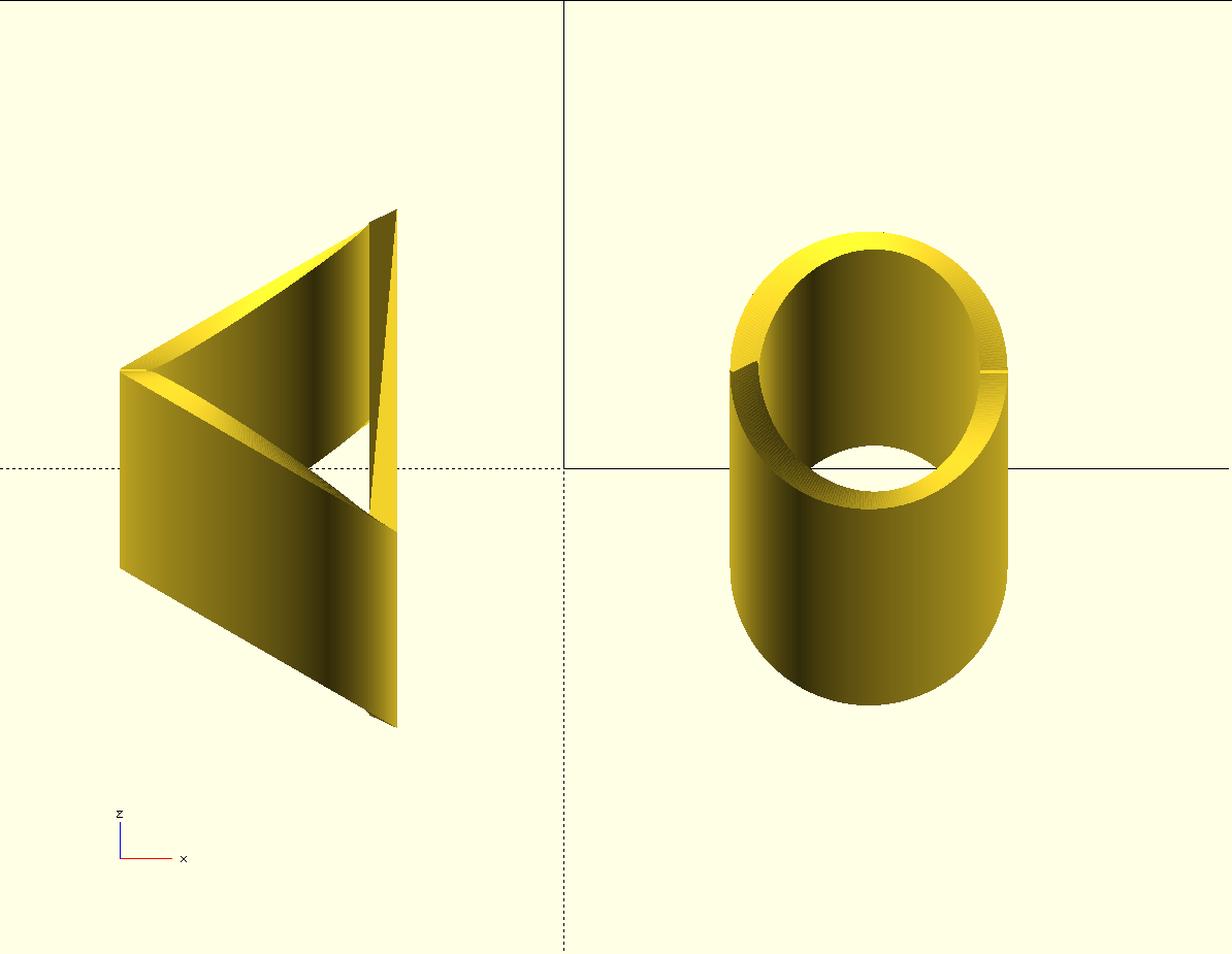

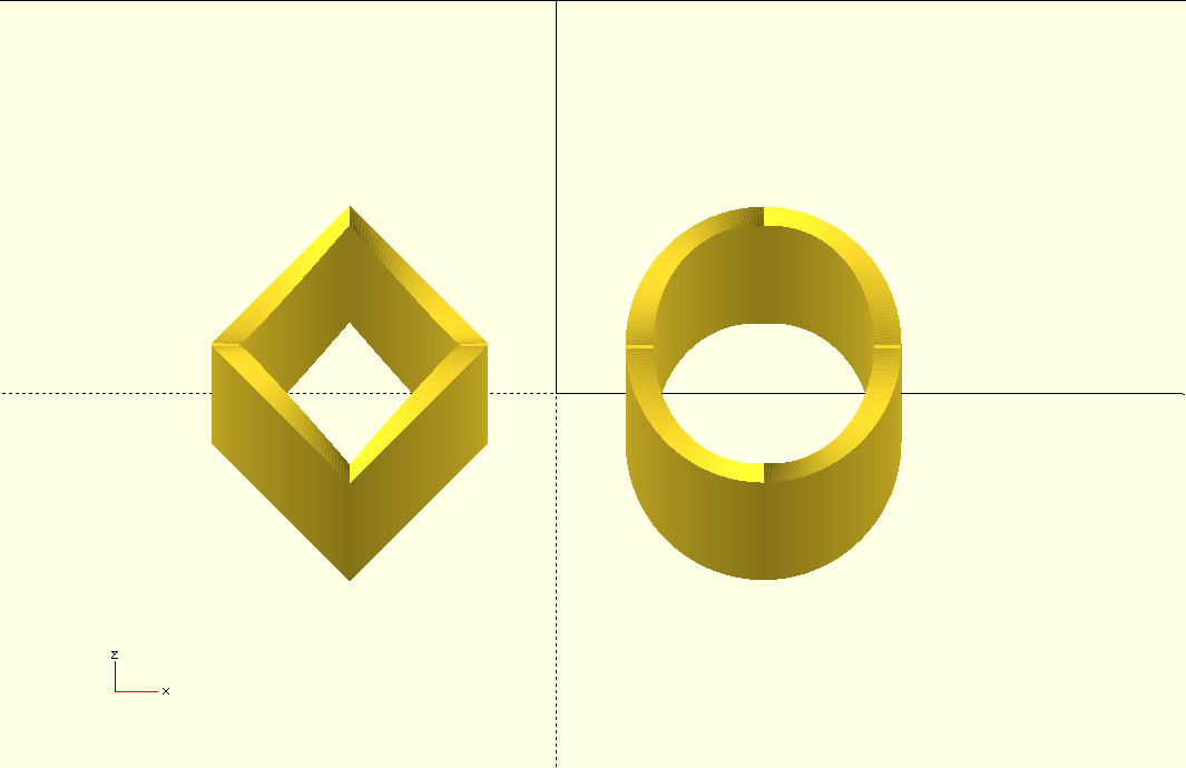

Its quite funny, best illusions you get with small view angles. Using
w1=5° gets me the following rather weird looking ground shape (middle).
Am 07.03.2025 um 11:29 schrieb Rudolf:
 For example:
 phi = 45;
 BTW, this is related to ambiguous cylinders
 <https://www.youtube.com/watch?v=sQ-Fsv8vVKo>. I want to
 experiment with different shapes but that requires the formula
 to be generic.

Its quite funny, best illusions you get with small view angles. Using w1=5° gets me the following rather weird looking ground shape (middle). Am 07.03.2025 um 11:29 schrieb Rudolf: > > OK, I quickly implemented it and it tends to look good. I think my > code is readable for you, even you might not have some my lib functions > > > w1 = 35; > res1 = intersect( shape1, shape2, w1, -w1); > path3 = Rz(0,concat(mid(res1, 0, 31), > mid(res1, 64, 88), > mid(res1, 146, 177), > mid(res1, 203, 227) > )); > > h = 20; > th=2; > max = Max(path3); > sx=(max[0]-th)/max[0]; > sy=(max[1]-th)/max[1]; > > resA = Tz(h/2, path3);      // outer up > resB = S(sx, sy,1, resA);  // inner up > resC = Tz(-h, resB);      // inner down > resD = Tz(-h, resA);      // outer down > > // prepare circular walk > path = [for(i=[0:len(resA)-1])[resA[i],resB[i], resC[i], resD[i]]]; > > dx = 15; > T(dx)sweep(path, close=true); > Rz(180)T(dx)sweep(path, close=true); > > echo($vpr); > $vpr =  [w1, 0, 0]; > > Am 07.03.2025 um 10:31 schrieb Rudolf via Discuss: >> >> not perfect, but I think viable in your case: you can calculate >> scalex, scaley values for the 2D shape that keeps the wall thickness >> at least at X and Y axis. Scaling only X,Y coordinates provides you >> an inner shape with the same number of points and lets you build a >> sequence of squares in the second step which you can use to do a >> circular extrude around Z instead of linear extruding along Z. >> >> >> Am 07.03.2025 um 09:21 schrieb Peter Kriens via Discuss: >>> I am having one more problem and I can't seem to find a good solution. >>> >>> I have a closed 3D path. How do I make this into a wall that >>> descents to the z=0? The problem is that the top must have the >>> Z-variances so extrudes seem out of the questions. I want the top of >>> the wall to be flat and be able to parameterize its overall >>> thickness (the current algorithm that uses difference() can create >>> very steep walls when angles are high.) >>> >>> PastedGraphic-7.pngPastedGraphic-9.png >>> >>> >>> >>> Is there any function in BOSL2 that can do this? >>> >>> Peter >>> >>> >>>> On 5 Mar 2025, at 11:53, Guenther Sohler via Discuss >>>> <discuss@lists.openscad.org> wrote: >>>> >>>> In PythonSCAD (and potentially soon in OpenSCAD) you could >>>> >>>> 1) output mesh  on Object A and  create a list of edges >>>> 2) output mesh on Object B and  create a list of edges >>>> 3) union/difference Object A with B , output mesh and create list >>>> of edges >>>> 4) select Set of Edges from 3 which are neither  in included in 1) >>>> nor  2) >>>> 5) sum up the lengths of Edges  from 4) >>>> >>>> my little 2 cents. I use exactly that algorithm for filling the cut >>>> line of 2 objects >>>> >>>> >>>> >>>> >>>> >>>> On Thu, Feb 27, 2025 at 10:28 PM Rudolf via Discuss >>>> <discuss@lists.openscad.org> wrote: >>>> >>>> Hi Peter, >>>> >>>> Adrian was right, it is not such a big drama to compute the >>>> intersection point of two extruded shapes, as long as they are >>>> somehow "well-behaved". I extracted the relevant functions and >>>> modules from my libraries and wrote your function >>>> *intersect(shape1, shape2, w1, w2)* and some test stuff with >>>> generic OpenSCAD. Find the scad file attached. The code is >>>> indeed quite neat and easy to understand. It computes the >>>> affine intersection of freely translated and rotated 2D-shapes, >>>> which are assumed to be endless in both directions. >>>> >>>> The function calculates all planes of the faces that delimit >>>> shape2, intersects each with all lines of shape1 and collects >>>> and returns only those points that are situated on a face This >>>> means, two function calls are needed to get hands on all >>>> intersection points. I leave it up to you to sort the sets >>>> together. In most cases you will be fine just using the richer >>>> set. >>>> >>>> I didn't have the time to protect the code against >>>> instabilities, mostly singularities from the dot product of two >>>> parallel vectors. As usual in OpenSCAD tiny-angle rotations or >>>> tiny-value translations get you around, as shown in the test >>>> code that produced the second example. >>>> >>>> Hope this helps you along. I'm curious whether it will bring >>>> you forward with the topology stuff in the paper. >>>> >>>> Rudolf >>>> >>>> // intersect two 2D shapes at an angle w >>>> function intersect(Sh1, Sh2, w1=w1, w2=w2) = >>>> let(Sh1 = Rx(w1, Sh1), Sh2 = Rx(w2, Sh2)) >>>> let(N1 =  Rx(w1, [0,0,1]), N2 = Rx(w2, [0,0,1])) >>>> let(L1 = len(Sh1), L2=len(Sh2)) >>>> let(sign = L1<L2) >>>> let(result = >>>>   [ >>>>     for(i = [0:L2-1], j = [0:L1-1]) >>>>     // define the current face of Sh2 >>>>     let(P1 = Sh2[i], P2=Sh2[(i+1)%L2]) >>>>     let(P3 = P1+N2, P4 = P2+N2) >>>>     let(d = norm(P1-P2)) >>>> >>>>     // calc the intersection of all lines of Sh1 with current >>>> face of Sh2 >>>>     let(A = Sh1[j], B = A+N1) >>>>       let(I = line_plane_intersection(A, B, P1, P2, P3)) >>>>       let(dist1 = distance_point_to_line(P1, P3, I)) >>>>       let(dist2 = distance_point_to_line(P2, P4, I)) >>>>     // filter points that closely touch the face >>>>       if(dist1+dist2<=d*1.0001) >>>>       I >>>>   ]) >>>>   result; >>>> >>>> >>>> <nGpKKGbcKaEzok3B.png> >>>> >>>> >>>> <ZcA2AgZ5byJR3asr.png> >>>> >>>> >>>> Am 22.02.2025 um 17:19 schrieb Peter Kriens via Discuss: >>>>> I am looking for a way to calculate the 3D path where two >>>>> shapes are intersecting. In this case, a shape can be limited >>>>> to a linearly extruded 2D path. >>>>> >>>>> For example: >>>>> >>>>> phi = 45; >>>>> union() { >>>>>   rotate([0,phi,0])  rotate([0,0,45]) >>>>> cube([20,20,80],center=true); >>>>>   rotate([0,-phi,0]) cylinder(r=14.2,h=80,center=true); >>>>> } >>>>> >>>>> I would like to have the 3D path indicated in red ... >>>>> >>>>> <PastedGraphic-1.png> >>>>> >>>>> I am looking for something like: >>>>> >>>>> function intersect( a, b, phi ) = ... >>>>> >>>>> Where an and b are 2D paths of the 2 shapes and phi is 1/2 the >>>>> intersecting angle for an and b. I understand there are 2, I >>>>> want the one closes to the XY plane. >>>>> >>>>> I am stuck ... anybody ideas or hints? I am using BOSL2 so any >>>>> use of the built in functions would be great. >>>>> >>>>> BTW, this is related to ambiguous cylinders >>>>> <https://www.youtube.com/watch?v=sQ-Fsv8vVKo>. I want to >>>>> experiment with different shapes but that requires the formula >>>>> to be generic. >>>>> >>>>> Kind regards, >>>>> >>>>> Peter Kriens >>>>> >>>>> >>>>> >>>>> >>>>> _______________________________________________ >>>>> OpenSCAD mailing list >>>>> To unsubscribe send an email todiscuss-leave@lists.openscad.org >>>> _______________________________________________ >>>> OpenSCAD mailing list >>>> To unsubscribe send an email to discuss-leave@lists.openscad.org >>>> >>>> _______________________________________________ >>>> OpenSCAD mailing list >>>> To unsubscribe send an email to discuss-leave@lists.openscad.org >>> >>> >>> _______________________________________________ >>> OpenSCAD mailing list >>> To unsubscribe send an email todiscuss-leave@lists.openscad.org >> >> _______________________________________________ >> OpenSCAD mailing list >> To unsubscribe send an email todiscuss-leave@lists.openscad.org

I have a closed 3D path. How do I make this into a wall that descents to
the z=0? The problem is that the top must have the Z-variances so extrudes
seem out of the questions. I want the top of the wall to be flat and be
able to parameterize its overall thickness (the current algorithm that uses
difference() can create very steep walls when angles are high.)
[image: PastedGraphic-7.png][image: PastedGraphic-9.png]
Peter

its a great design. is the source code public ? On Fri, Mar 7, 2025 at 12:22 PM Adrian Mariano via Discuss < discuss@lists.openscad.org> wrote: > I think something like this using BOSL2 methods: Say path is your > starting path. Project to xy plane with path_proj=path2d(path). Compute > offset, inside=offset(path_proj,r). Now map back to the top, inside_top = > hstack(inside, column(path,2)). Now you have all the coordinates of the > shape and can create it with vnf_vertex_array (or skin), so vnf = > vnf_vertex_array([path, path3d(path_proj), path3d(inside), > inside_top],row_wrap=true). (I think row_wrap is right, but maybe > col_wrap...) > > On Fri, Mar 7, 2025 at 5:29 AM Rudolf via Discuss < > discuss@lists.openscad.org> wrote: > >> OK, I quickly implemented it and it tends to look good. I think my code >> is readable for you, even you might not have some my lib functions >> >> >> w1 = 35; >> res1 = intersect( shape1, shape2, w1, w1); >> path3 = Rz(0,concat(mid(res1, 0, 31), >> mid(res1, 64, 88), >> mid(res1, 146, 177), >> mid(res1, 203, 227) >> )); >> >> h = 20; >> th=2; >> max = Max(path3); >> sx=(max[0]-th)/max[0]; >> sy=(max[1]-th)/max[1]; >> >> resA = Tz(h/2, path3); // outer up >> resB = S(sx, sy,1, resA); // inner up >> resC = Tz(-h, resB); // inner down >> resD = Tz(-h, resA); // outer down >> >> // prepare circular walk >> path = [for(i=[0:len(resA)-1])[resA[i],resB[i], resC[i], resD[i]]]; >> >> dx = 15; >> T(dx)sweep(path, close=true); >> Rz(180)T(dx)sweep(path, close=true); >> >> echo($vpr); >> $vpr = [w1, 0, 0]; >> >> Am 07.03.2025 um 10:31 schrieb Rudolf via Discuss: >> >> not perfect, but I think viable in your case: you can calculate scalex, >> scaley values for the 2D shape that keeps the wall thickness at least at X >> and Y axis. Scaling only X,Y coordinates provides you an inner shape with >> the same number of points and lets you build a sequence of squares in the >> second step which you can use to do a circular extrude around Z instead of >> linear extruding along Z. >> >> >> Am 07.03.2025 um 09:21 schrieb Peter Kriens via Discuss: >> >> I am having one more problem and I can't seem to find a good solution. >> >> I have a closed 3D path. How do I make this into a wall that descents to >> the z=0? The problem is that the top must have the Z-variances so extrudes >> seem out of the questions. I want the top of the wall to be flat and be >> able to parameterize its overall thickness (the current algorithm that uses >> difference() can create very steep walls when angles are high.) >> >> [image: PastedGraphic-7.png][image: PastedGraphic-9.png] >> >> >> >> Is there any function in BOSL2 that can do this? >> >> Peter >> >> >> On 5 Mar 2025, at 11:53, Guenther Sohler via Discuss >> <discuss@lists.openscad.org> <discuss@lists.openscad.org> wrote: >> >> In PythonSCAD (and potentially soon in OpenSCAD) you could >> >> 1) output mesh on Object A and create a list of edges >> 2) output mesh on Object B and create a list of edges >> 3) union/difference Object A with B , output mesh and create list of edges >> 4) select Set of Edges from 3 which are neither in included in 1) nor 2) >> 5) sum up the lengths of Edges from 4) >> >> my little 2 cents. I use exactly that algorithm for filling the cut line >> of 2 objects >> >> >> >> >> >> On Thu, Feb 27, 2025 at 10:28 PM Rudolf via Discuss < >> discuss@lists.openscad.org> wrote: >> >>> Hi Peter, >>> >>> Adrian was right, it is not such a big drama to compute the intersection >>> point of two extruded shapes, as long as they are somehow "well-behaved". I >>> extracted the relevant functions and modules from my libraries and wrote >>> your function *intersect(shape1, shape2, w1, w2)* and some test stuff >>> with generic OpenSCAD. Find the scad file attached. The code is indeed >>> quite neat and easy to understand. It computes the affine intersection of >>> freely translated and rotated 2D-shapes, which are assumed to be endless in >>> both directions. >>> >>> The function calculates all planes of the faces that delimit shape2, >>> intersects each with all lines of shape1 and collects and returns only >>> those points that are situated on a face This means, two function calls are >>> needed to get hands on all intersection points. I leave it up to you to >>> sort the sets together. In most cases you will be fine just using the >>> richer set. >>> >>> I didn't have the time to protect the code against instabilities, mostly >>> singularities from the dot product of two parallel vectors. As usual in >>> OpenSCAD tiny-angle rotations or tiny-value translations get you around, as >>> shown in the test code that produced the second example. >>> >>> Hope this helps you along. I'm curious whether it will bring you forward >>> with the topology stuff in the paper. >>> >>> Rudolf >>> >>> // intersect two 2D shapes at an angle w >>> function intersect(Sh1, Sh2, w1=w1, w2=w2) = >>> let(Sh1 = Rx(w1, Sh1), Sh2 = Rx(w2, Sh2)) >>> let(N1 = Rx(w1, [0,0,1]), N2 = Rx(w2, [0,0,1])) >>> let(L1 = len(Sh1), L2=len(Sh2)) >>> let(sign = L1<L2) >>> let(result = >>> [ >>> for(i = [0:L2-1], j = [0:L1-1]) >>> // define the current face of Sh2 >>> let(P1 = Sh2[i], P2=Sh2[(i+1)%L2]) >>> let(P3 = P1+N2, P4 = P2+N2) >>> let(d = norm(P1-P2)) >>> >>> // calc the intersection of all lines of Sh1 with current face of Sh2 >>> let(A = Sh1[j], B = A+N1) >>> let(I = line_plane_intersection(A, B, P1, P2, P3)) >>> let(dist1 = distance_point_to_line(P1, P3, I)) >>> let(dist2 = distance_point_to_line(P2, P4, I)) >>> // filter points that closely touch the face >>> if(dist1+dist2<=d*1.0001) >>> I >>> ]) >>> result; >>> >>> <nGpKKGbcKaEzok3B.png> >>> >>> >>> <ZcA2AgZ5byJR3asr.png> >>> >>> >>> Am 22.02.2025 um 17:19 schrieb Peter Kriens via Discuss: >>> >>> I am looking for a way to calculate the 3D path where two shapes are >>> intersecting. In this case, a shape can be limited to a linearly extruded >>> 2D path. >>> >>> For example: >>> >>> phi = 45; >>> union() { >>> rotate([0,phi,0]) rotate([0,0,45]) cube([20,20,80],center=true); >>> rotate([0,-phi,0]) cylinder(r=14.2,h=80,center=true); >>> } >>> >>> I would like to have the 3D path indicated in red ... >>> >>> <PastedGraphic-1.png> >>> >>> I am looking for something like: >>> >>> function intersect( a, b, phi ) = ... >>> >>> Where an and b are 2D paths of the 2 shapes and phi is 1/2 the >>> intersecting angle for an and b. I understand there are 2, I want the one >>> closes to the XY plane. >>> >>> I am stuck ... anybody ideas or hints? I am using BOSL2 so any use of >>> the built in functions would be great. >>> >>> BTW, this is related to ambiguous cylinders >>> <https://www.youtube.com/watch?v=sQ-Fsv8vVKo>. I want to experiment >>> with different shapes but that requires the formula to be generic. >>> >>> Kind regards, >>> >>> Peter Kriens >>> >>> >>> >>> >>> _______________________________________________ >>> OpenSCAD mailing list >>> To unsubscribe send an email to discuss-leave@lists.openscad.org >>> >>> _______________________________________________ >>> OpenSCAD mailing list >>> To unsubscribe send an email to discuss-leave@lists.openscad.org >>> >> _______________________________________________ >> OpenSCAD mailing list >> To unsubscribe send an email to discuss-leave@lists.openscad.org >> >> >> >> _______________________________________________ >> OpenSCAD mailing list >> To unsubscribe send an email to discuss-leave@lists.openscad.org >> >> >> _______________________________________________ >> OpenSCAD mailing list >> To unsubscribe send an email to discuss-leave@lists.openscad.org >> >> _______________________________________________ >> OpenSCAD mailing list >> To unsubscribe send an email to discuss-leave@lists.openscad.org >> > _______________________________________________ > OpenSCAD mailing list > To unsubscribe send an email to discuss-leave@lists.openscad.org >
R
Rudolf
Fri, Mar 7, 2025 2:43 PM
The source code is all public. It is a question of bundling all pieces
into a single project and the question whether you are on BOSL2. I
personally don't. As it is Peter's thread he will have an opinion about
it and might wanna "release" it.
Just a note concerning my screenshot. It was made with 10° Z-rotate,
which I introduced when playing with the design.
Without any rotation you get a symmetric design as expected.
@Adrian. Using an offset(-d) on the 2D projection of the path is more
straight forward, but it might reduce your edge count and thus bring
some trouble when trying to do the rotate extrusion.
 your starting path.  Project to xy plane with
 path_proj=path2d(path).  Compute offset,
 of the shape and can create it with vnf_vertex_array (or skin), so
 vnf = vnf_vertex_array([path, path3d(path_proj), path3d(inside),
 maybe col_wrap...)
         two shapes are intersecting. In this case, a shape can
         be limited to a linearly extruded 2D path.
         For example:
         phi = 45;
         1/2 the intersecting angle for an and b. I understand
         there are 2, I want the one closes to the XY plane.
         BOSL2 so any use of the built in functions would be great.

The BOSL2 offset has a same_length option so that point count will not
change and the points will align when linked into a 3d object.
I am looking for a way to calculate the 3D path where two shapes are intersecting. In this case, a shape can be limited to a linearly extruded 2D path.
For example:
phi = 45;
Where an and b are 2D paths of the 2 shapes and phi is 1/2 the intersecting angle for an and b. I understand there are 2, I want the one closes to the XY plane.
I am stuck ... anybody ideas or hints? I am using BOSL2 so any use of the built in functions would be great.
BTW, this is related to ambiguous cylinders https://www.youtube.com/watch?v=sQ-Fsv8vVKo. I want to experiment with different shapes but that requires the formula to be generic.

R
Rudolf
Wed, Mar 12, 2025 12:37 PM
Peter,
I don't have any problems using high resolutions. The only delicate
thing is combining the right pieces for the intersection path, as you
mentioned. And my code doesn't like, if you try to intersect a plane
with a parallel line. Its easy to treat (by a small rotation), but I
didn't have time to go into the routine (and return a [0,0,0] or
something very far away).
Here a screenshot of nice one that uses 300 Segments. I assembled all
code into a single file and attached it. Feel free to use it, but only
in a non-commercial way.
Just a usage hint. My select() function that automatically combines the
intersection path works well for 45° and a pair of shapes that has a
well matching diameter in x. For other cases, like a somehow rotated
triangle or a view angle of say 15° I manually tweak the intersection
path using the mid() function. Using the view switches makes this an
easy process with visual feedback.
The only lib used is "Naca_sweep.scad" for sweep(), but I think you can
use BOSL's skin() module with adding a single parameter.
         I think my code is readable for you, even you might not
         <H9GcJaPmmg60MwIz.png>
         w1 = 35;
         mid(res1, 64, 88),
         mid(res1, 203, 227)
         h = 20;
         th=2;
         max = Max(path3);
         resD[i]]];
         dx = 15;
         echo($vpr);
         $vpr =  [w1, 0, 0];
             and some test stuff with generic OpenSCAD. Find
             the scad file attached. The code is indeed quite
             that delimit shape2, intersects each with all
             to sort the sets together. In most cases you will
             against instabilities, mostly singularities from
             in OpenSCAD tiny-angle rotations or tiny-value
             will bring you forward with the topology stuff in
             the paper.
             Rudolf
