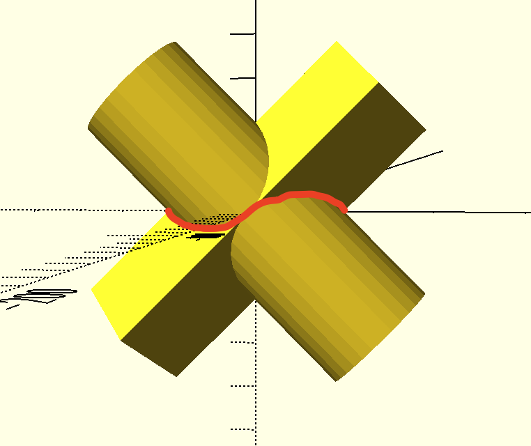

I am looking for a way to calculate the 3D path where two shapes are intersecting. In this case, a shape can be limited to a linearly extruded 2D path.
For example:
phi = 45;
rotate([0,phi,0])  rotate([0,0,45]) cube([20,20,80],center=true);
rotate([0,-phi,0]) cylinder(r=14.2,h=80,center=true);
I would like to have the 3D path indicated in red ...
I am looking for something like:
function intersect( a, b, phi ) = ...
Where an and b are 2D paths of the 2 shapes and phi is 1/2 the intersecting angle for an and b. I understand there are 2, I want the one closes to the XY plane.
I am stuck ... anybody ideas or hints? I am using BOSL2 so any use of the built in functions would be great.
BTW, this is related to ambiguous cylinders https://www.youtube.com/watch?v=sQ-Fsv8vVKo. I want to experiment with different shapes but that requires the formula to be generic.
Kind regards,
Peter Kriens

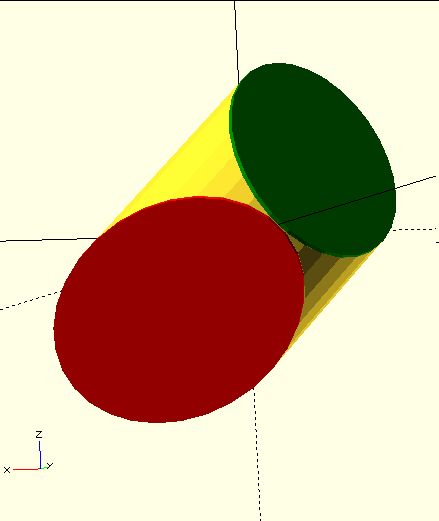

The intersection of a plane with a cylinder is an ellipse. In your
special well-behaved case of phi = 45, and an extruded square shape
intersecting with a circle of same diameter you can scale a circle with
1/sin(phi) and transform it to the intersection plane. This is what my
code shows (but not in a generic way). In the next step you would
describe the parts of the scaled circles you are interested in with a
function and transform it with affine transformations.
However, I would say there is no hope in using OpenSCAD function
language to find the intersection path of arbitrary tilted extruded
shapes, even if the shapes are well-behaved - i.e. their extrusions have
a unique path between your start and end point on the X-axis. If you
tried this you'd be forced to implement complex node search, sort and
calculation algorithms first and you'd encounter a lot of numerical
problems. Much fun.
p = 45;
r = 14.2;
intersection()
  rotate([0,p,0])  rotate([0,0,45]) cube([20,20,80],center=true);
  rotate([0,-p,0]) cylinder(r=14.2,h=80,center=true);
color("red")
rotate([0, 180-p, 0])
translate([0, 0, r])
rotate([-p, 0, 0])
scale([1, 1/sin(p), 1])
circle(r);
color("green")
rotate([0, -p, 0])
rotate([-p, 0, 0])
circle(r);

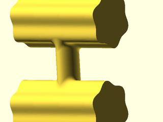

Here is an example taken from the BOSL2 manual for join_prism() which works
by computing the intersection between two arbitrary linear extrusions and
then computes a rounding profile along that intersection.  Here we have the
flower shaped object as one component and an ellipse shaped object as the
second one.  Things will go wrong if the objects aren't well enough
behaved, but the problem is not impossible in OpenSCAD, at least for
reasonable cases.

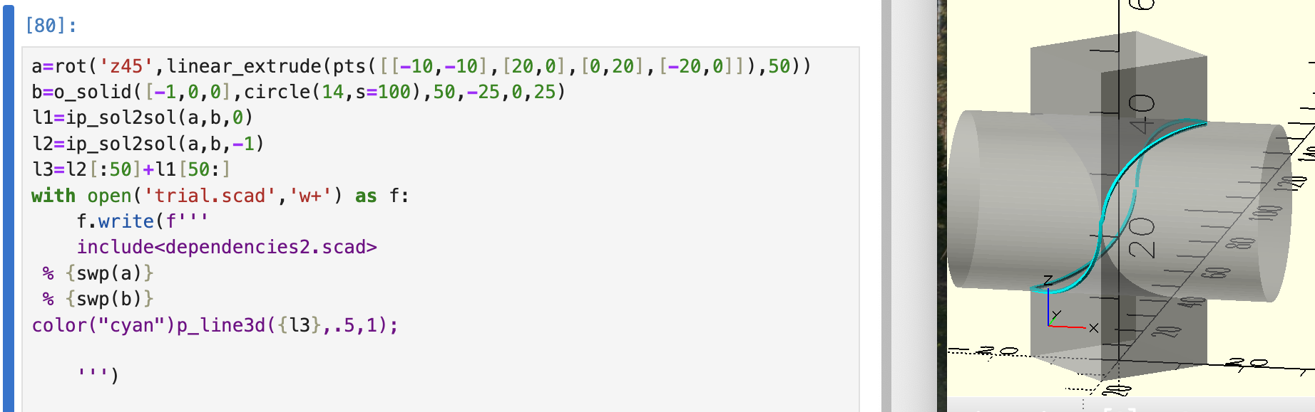

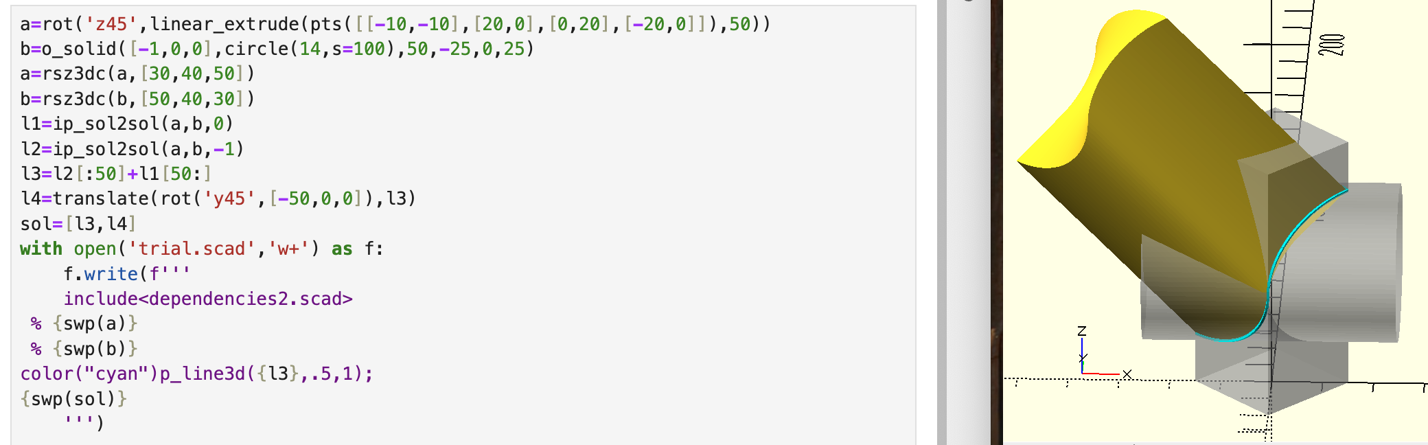

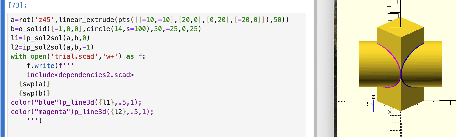

Here is an example of intersection line between 2 solids and then
manipulating the points to get the kind of line you showed in your sketch
step1:
[image: Screenshot 2025-02-23 at 7.12.26 AM.png]
step2:
[image: Screenshot 2025-02-23 at 7.17.02 AM.png]

Sun, Feb 23, 2025 2:37 AM
attached is the scad file generated and the code:
need to add more points for further finer results
from openscad2 import *
a=rot('z45',linear_extrude(pts([[-10,-10],[20,0],[0,20],[-20,0]]),50))
b=o_solid([-1,0,0],circle(14,s=500),50,-25,0,25)
a=rsz3dc(a,[30,40,50])
b=rsz3dc(b,[50,40,30])
l1=ip_sol2sol(a,b,0)
l2=ip_sol2sol(a,b,-1)
l3=l2[:250]+l1[250:]
l3=sec2surface_2(l3)
l4=translate(rot('y45',[-50,0,0]),l3)
sol=rot('y45',solid_from_2surfaces(l3,l4))
f.write(f'''
{swp(sol)}
attached is the scad file generated and the code: need to add more points for further finer results from openscad2 import * a=rot('z45',linear_extrude(pts([[-10,-10],[20,0],[0,20],[-20,0]]),50)) b=o_solid([-1,0,0],circle(14,s=500),50,-25,0,25) a=rsz3dc(a,[30,40,50]) b=rsz3dc(b,[50,40,30]) l1=ip_sol2sol(a,b,0) l2=ip_sol2sol(a,b,-1) l3=l2[:250]+l1[250:] l3=sec2surface_2(l3) l4=translate(rot('y45',[-50,0,0]),l3) sol=rot('y45',solid_from_2surfaces(l3,l4)) with open('trial.scad','w+') as f: f.write(f''' {swp(sol)} ''')

Here is an example of intersection line between 2 solids and then manipulating the points to get the kind of line you showed in your sketch
step1:
<Screenshot 2025-02-23 at 7.12.26 AM.png>
step2:
<Screenshot 2025-02-23 at 7.17.02 AM.png>

On 23 Feb 2025, at 02:30, Adrian Mariano via Discuss discuss@lists.openscad.org wrote:
Here is an example taken from the BOSL2 manual for join_prism() which works by computing the intersection between two arbitrary linear extrusions and then computes a rounding profile along that intersection.  Here we have the flower shaped object as one component and an ellipse shaped object as the second one.  Things will go wrong if the objects aren't well enough behaved, but the problem is not impossible in OpenSCAD, at least for reasonable cases.
<image.png>

The intersection of a plane with a cylinder is an ellipse. In your special well-behaved case of phi = 45, and an extruded square shape intersecting with a circle of same diameter you can scale a circle with 1/sin(phi) and transform it to the intersection plane. This is what my code shows (but not in a generic way). In the next step you would describe the parts of the scaled circles you are interested in with a function and transform it with affine transformations.
However, I would say there is no hope in using OpenSCAD function language to find the intersection path of arbitrary tilted extruded shapes, even if the shapes are well-behaved - i.e. their extrusions have a unique path between your start and end point on the X-axis. If you tried this you'd be forced to implement complex node search, sort and calculation algorithms first and you'd encounter a lot of numerical problems. Much fun.
p = 45;
r = 14.2;
intersection()
color("red")
rotate([-p, 0, 0])
circle(r);
color("green")
rotate([0, -p, 0])
rotate([-p, 0, 0])
circle(r);
<cTt6ag6v39Bm6Wyp.png>
For example:
phi = 45;
<PastedGraphic-1.png>
