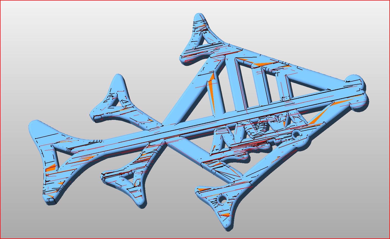

I don't have an algorithm at all.  I was looking for one, though :-)
Look at the sample pictures I sent as just being stl objects.  What would I
need to do to create them in OpenSCAD?  How do you create odd shaped
"blobs" and patterns and put them together?

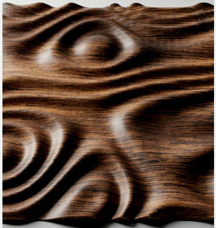

On Sat, Oct 26, 2024 at 12:53 PM Joe Weinpert joe.weinpert@gmail.com

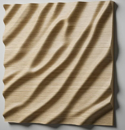

Here are a couple of samples.  Parametric styles vary immensely.  It
would be nice to have a tool that can be used to create different forms.
[image: 2024-10-26_12-46-24.jpg]
[image: 2024-10-26_12-48-31.jpg]
Joe Weinpert
skidrowacademy.com
On Sat, Oct 26, 2024 at 12:40 PM Adrian Mariano avm4@cornell.edu wrote:
You need to define your goal better. I have no clue what a parametric
wall carving might be. What form?  What parameters?
On Sat, Oct 26, 2024 at 12:23 Joe Weinpert via Discuss <
I would like to use OpenSCAD and the BOSL library to design parametric
wood wall carving STL files.
Has anyone done this yet?
Where should I start looking?  BOSL has nearly 900 functions.
Would there be any examples of what to use?  Examples, I have found,
are the best way to learn something.
Joe Weinpert
skidrowacademy.com
I don't have an algorithm at all. I was looking for one, though :-) Look at the sample pictures I sent as just being stl objects. What would I need to do to create them in OpenSCAD? How do you create odd shaped "blobs" and patterns and put them together? Joe Weinpert skidrowacademy.com On Mon, Oct 28, 2024 at 5:20 PM Adrian Mariano <avm4@cornell.edu> wrote: > Appears that you sent this message just to me, not the list. > > Do you have an algorithm that generates these parametric structures? > Because there are two separate issues here. One is how do you produce > those patterns AT ALL. And the second one is how do you do it in > OpenSCAD. It would be advantageous to have a solid answer to the first > question before pondering the second one. Or you at least need some idea > of a possible algorithm. An algorithm for this is not immediately obvious > to me. The problem of "how to do this in BOSL2" depends on what that > algorithm looks like, and a lot of it might not be BOSL2 specific but > really just how to generate a pattern that looks like that. > > On Sat, Oct 26, 2024 at 12:53 PM Joe Weinpert <joe.weinpert@gmail.com> > wrote: > >> Here are a couple of samples. Parametric styles vary immensely. It >> would be nice to have a tool that can be used to create different forms. >> >> [image: 2024-10-26_12-46-24.jpg] >> [image: 2024-10-26_12-48-31.jpg] >> >> Joe Weinpert >> skidrowacademy.com >> >> >> >> On Sat, Oct 26, 2024 at 12:40 PM Adrian Mariano <avm4@cornell.edu> wrote: >> >>> You need to define your goal better. I have no clue what a parametric >>> wall carving might be. What form? What parameters? >>> >>> On Sat, Oct 26, 2024 at 12:23 Joe Weinpert via Discuss < >>> discuss@lists.openscad.org> wrote: >>> >>>> I would like to use OpenSCAD and the BOSL library to design parametric >>>> wood wall carving STL files. >>>> >>>> Has anyone done this yet? >>>> >>>> Where should I start looking? BOSL has nearly 900 functions. >>>> >>>> Would there be any examples of what to use? Examples, I have found, >>>> are the best way to learn something. >>>> >>>> Joe Weinpert >>>> skidrowacademy.com >>>> >>>> _______________________________________________ >>>> OpenSCAD mailing list >>>> To unsubscribe send an email to discuss-leave@lists.openscad.org >>>> >>>
Mon, Oct 28, 2024 9:55 PM

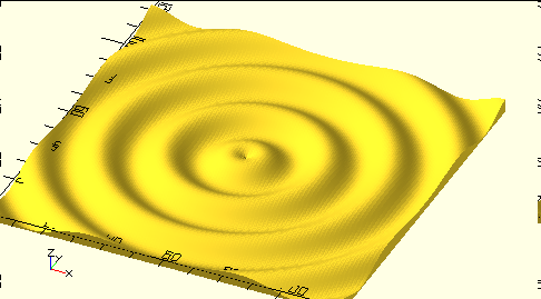

polyhedron(), and math to come up with the desired shape.
Here's something I did to come up with a water wave pattern.  It's not
great but it illustrates the idea.  The bulk is the sfc() module, which
is like surface() but takes its input in the form of an array.
surface() really should do that, but doesn't and I haven't gotten around
to making it happen.  I was never very happy with the relationship
between the resolution of the array and the size presented, so that may
be more complex than it needs to be.
For something like you describe, you need the sfc() module and a module
that produces the right height-map for your pattern.

And of course that prompted me to review that program, simplify it a
bit, and replace the wave function with one that's in some ways more
interesting.
But note that the shape of the model is entirely controlled by the
wave() function and its inputs.
Note:  sfc() has a bunch of square cells to draw a surface from.  That
requires deciding which diagonal to use to split the squares into two
triangles.  It happens that it chooses the lower-right/upper-left
diagonal, but either is equally correct.  In other patterns I've found
that this uniform triangulation can produce undesirable visual
artifacts, so in some other variations on this module I've chosen which
to use at random.  The difference is in how the final "each for" is built.
And of course, BOSL2 has this in its heightfield() module:
https://github.com/BelfrySCAD/BOSL2/wiki/shapes3d.scad#functionmodule-heightfield
waterSize = [120, 120];
waveLength = 20;
waveH = 2;
baseH = waveH + 0.5;
water(waterSize);
function wave(x, y) = sin(360*norm([x,y] - waterSize/2)/waveLength) * waveH;

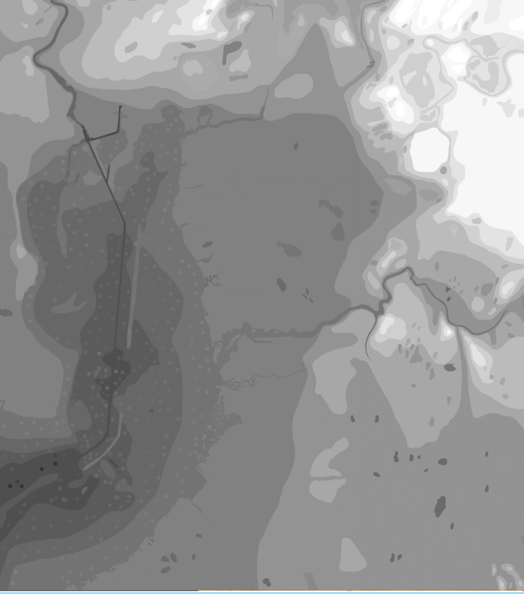

Meant to include an image...
Mon, Oct 28, 2024 11:06 PM
I don't think the waves problem gives much insight into the general
parametric problem that was posed.  Producing that general parametric
pattern as a function over the xy plane seems like it might be difficult.
I suppose there might be some cool generative method that used an iterative
process to produce a functional shape like that.
When I looked at it I thought maybe you could generate a set of paths for
each ridge (or cut, if you like).  I thought maybe this could be turned

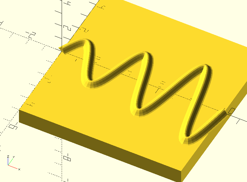

into a texture, but that's hard.  So that leads to something like this
(where you might be able to get away regular path_sweep if there are more
gentle curves---it would be faster).  But I have no clue how you generate
the path list.
include<BOSL2/std.scad>
cuboid([10,10,1],anchor=TOP+LEFT);
cycles=3;
path = [for(t=[0:10:360cycles])  [10t/360/cycles,
(1+t/(360*cycles)/.5)*sin(t)]];
profile = [for(theta=[-180:36:180]) [theta/180/3, (1+cos(theta))/7]];
path_sweep2d(profile, path);
great but it illustrates the idea.  The bulk is the sfc() module, which is
like surface() but takes its input in the form of an array.  surface()
really should do that, but doesn't and I haven't gotten around to making it
happen.  I was never very happy with the relationship between the
resolution of the array and the size presented, so that may be more complex

I don't think the waves problem gives much insight into the general parametric problem that was posed. Producing that general parametric pattern as a function over the xy plane seems like it might be difficult. I suppose there might be some cool generative method that used an iterative process to produce a functional shape like that. When I looked at it I thought maybe you could generate a set of paths for each ridge (or cut, if you like). I thought maybe this could be turned into a texture, but that's hard. So that leads to something like this (where you might be able to get away regular path_sweep if there are more gentle curves---it would be faster). But I have no clue how you generate the path list. include<BOSL2/std.scad> cuboid([10,10,1],anchor=TOP+LEFT); cycles=3; path = [for(t=[0:10:360*cycles]) [10*t/360/cycles, (1+t/(360*cycles)/.5)*sin(t)]]; profile = [for(theta=[-180:36:180]) [theta/180/3, (1+cos(theta))/7]]; path_sweep2d(profile, path); [image: image.png] On Mon, Oct 28, 2024 at 5:56 PM Jordan Brown <openscad@jordan.maileater.net> wrote: > On 10/28/2024 2:34 PM, Joe Weinpert via Discuss wrote: > > > I don't have an algorithm at all. I was looking for one, though :-) > > Look at the sample pictures I sent as just being stl objects. What would > I need to do to create them in OpenSCAD? How do you create odd shaped > "blobs" and patterns and put them together? > > > polyhedron(), and math to come up with the desired shape. > > Here's something I did to come up with a water wave pattern. It's not > great but it illustrates the idea. The bulk is the sfc() module, which is > like surface() but takes its input in the form of an array. surface() > really should do that, but doesn't and I haven't gotten around to making it > happen. I was never very happy with the relationship between the > resolution of the array and the size presented, so that may be more complex > than it needs to be. > > For something like you describe, you need the sfc() module and a module > that produces the right height-map for your pattern. > > $fa = 1; > $fs = 0.5; > > waterX = 600; > waterY = 600; > waterStep = 5; > waveLengthX = 60; > waveLengthY = 50; > waveAmpX = 2; > waveAmpY = 1; > waveH = waveAmpX + waveAmpY; > baseH = waveH + 0.5; > > function wave(x,y) = waveAmpX*sin(360*x/waveLengthX) + waveAmpY*sin(360*y/waveLengthY); > > module water() { > water = [ > let(nx = floor(waterX/waterStep)) > let(xStep = waterX/nx) > let(ny = floor(waterY/waterStep)) > let(yStep = waterY/ny) > for (ix = [0:nx]) [ > for (iy=[0:ny]) > wave(ix*xStep, iy*yStep) > ] > ]; > translate([-waterX/4,-waterY/4,waveH]) > sfc(water, [waterX, waterY, baseH]); > } > > module sfc(a, sz) { > function dataIndex(x, y) = dataBase + x*ny + y; > nx = len(a); > ny = len(a[0]); > corners = 0; > dataBase = corners + 4; > > pts = [ > [0, 0, -sz.z], > [nx-1, 0, -sz.z], > [nx-1, ny-1, -sz.z], > [0, ny-1, -sz.z], > for (x = [0:nx-1]) > for (y = [0:ny-1]) > [ x, y, a[x][y] ] > ]; > faces = [ > [ corners+0, corners+1, corners+2 ], > [ corners+0, corners+2, corners+3 ], > [ > each for (x=[0:nx-1]) dataIndex(x,0), > corners+1, > corners+0, > ], > [ > each for (y=[0:ny-1]) dataIndex(nx-1,y), > corners+2, > corners+1, > ], > [ > each for (x=[nx-1:-1:0]) dataIndex(x,ny-1), > corners+3, > corners+2, > ], > [ > each for (y=[ny-1:-1:0]) dataIndex(0,y), > corners+0, > corners+3, > ], > each for (x=[0:nx-2], y=[0:ny-2]) [ > [ dataIndex(x+1, y), dataIndex(x, y), dataIndex(x, y+1) ], > [ dataIndex(x+1, y+1), dataIndex(x+1, y), dataIndex(x, y+1) ], > ], > ]; > scale([sz.x/(nx-1),sz.y/(ny-1),1]) > polyhedron(pts, faces, convexity=ceil(max(waterX/waveLengthX, waterY/waveLengthY))); > } > > water(); > > >

Here are examples of the desired output that appear like they were sent
directly to me and not to the list, so I'm repeating them:
On Tue, Oct 29, 2024 at 6:11 AM Rogier Wolff R.E.Wolff@bitwizard.nl wrote:

close-but-not-quite.
Between each pair of curves, for each linesegment on one find the
closest point to the linesegment on the other curve. I'm not sure if
you have to take the sum of the linesegments or the actual distance to
the line. That's a triangle of your surface. For "well behaved"
curves, this gives the optimal surface. If there are not "well
behaved" curves that give a surface with holes... I don't know.
So for Jordan's example you could pass in something like:
a=5;
for (i=[0:.3:50])
translate ([0,0,asin(i360*4/50)]) circle (r=i);
or the radials. In openscad you can create a list-of-points with a
sinewave as the Z coordinate in one go. But I haven't memorized the
syntax yet.
(Initially / forever it is NOT the task of the algorithm to figure out
which pairs of curves to use for the surface. The user will have to
pass them in in sequence).
Being able to define surfaces (2d objects in 3D), would eventually
allow users to stitch them together (like we can already with
triangles) and create 3D objects. My example above together with
cylinder-surface (top=false) would create a real 3D object.
iterative
generate
the path list.
cycles=3;
would
which is
making it
complex
$fa = 1;
$fs = 0.5;
waterX = 600;
waterY = 600;
waterStep = 5;
waveLengthX = 60;
waveLengthY = 50;
waveAmpX = 2;
waveAmpY = 1;
function wave(x,y) = waveAmpXsin(360x/waveLengthX) +
waveAmpYsin(360y/waveLengthY);
module water() {
water = [
for (ix = [0:nx]) [
for (iy=[0:ny])
wave(ixxStep, iyyStep)
module sfc(a, sz) {
nx = len(a);
ny = len(a[0]);
corners = 0;
 pts = [
     [0,    0,    -sz.z],
     [nx-1, 0,    -sz.z],
     [0,    ny-1, -sz.z],
     for (x = [0:nx-1])
         for (y = [0:ny-1])
             [ x, y, a[x][y] ]
 faces = [
         corners+1,
         corners+0,
         corners+2,
         corners+1,
         corners+3,
         corners+2,
         corners+0,
         corners+3,
y+1) ],
water();
