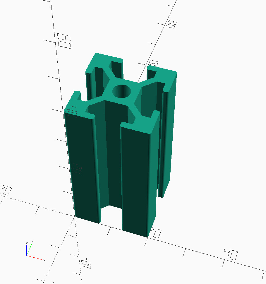

Fri, Jul 19, 2019 4:40 PM
To linear_extrude the projection of a linear_extruded shape in a STL file
seems to be a nonsense. You just need to resize its import:
resize([20,20,40])
import("PROFILE20X20_001.stl");
Alternatively, you can generate the profile STL with a unitary height and
scale its import:
scale([1,1,40])

To linear_extrude the projection of a linear_extruded shape in a STL file seems to be a nonsense. You just need to resize its import: resize([20,20,40]) import("PROFILE20X20_001.stl"); Alternatively, you can generate the profile STL with a unitary height and scale its import: scale([1,1,40]) import("PROFILE20X20_001.stl"); Em sex, 19 de jul de 2019 às 08:19, Juan C.Cilleruelo < juanc.cilleruelo@gmail.com> escreveu: > Thank you very much!!!! > > It's just what I looking for!!! > > > > /*---------- PROFILE 20X20 => ALUMINIUM PROFILE 20x20 > ----------*/ > linear_extrude(height = 40, center = false, convexity = 10, twist = 0){ > projection(){ > import("PROFILE20X20_001.stl"); > } > } > > > >
Fri, Jul 19, 2019 5:04 PM
Yes that is a better way to do it if you know the height of the STL.
Projection is very slow.

JC
Juan C.Cilleruelo
Fri, Jul 19, 2019 5:23 PM
This response seems to be, actually, a nonsense.
If I am the creator of the STL and I positioned it, as you can see,
exactly in X = 0, Y = 0 and Z = 0 and plain to Z, I'm almost sure I
don't need to resize it!
scale() and resize() deforms the original figure. linear_extrude only
"EXTRUDE" it.  This is what I want. An extrusion.
Thanks for your response, but it's not an appropriate solution for my
problem.
 resize([20,20,40])
 scale([1,1,40])
<juanc.cilleruelo@gmail.com mailto:juanc.cilleruelo@gmail.com> escreveu:
 /*----------  PROFILE 20X20 => ALUMINIUM PROFILE 20x20  ----------*/
 twist = 0){
       projection(){
This response seems to be, actually, a nonsense. If I am the creator of the STL and I positioned it, as you can see, exactly in X = 0, Y = 0 and Z = 0 and plain to Z, I'm almost sure I don't need to resize it! scale() and resize() deforms the original figure. linear_extrude only "EXTRUDE" it.  This is what I want. An extrusion. Thanks for your response, but it's not an appropriate solution for my problem. On 19/07/2019 18:40, Ronaldo Persiano wrote: > To linear_extrude the projection of a linear_extruded shape in a STL > file seems to be a nonsense. You just need to resize its import: > > resize([20,20,40]) > import("PROFILE20X20_001.stl"); > > Alternatively, you can generate the profile STL with a unitary height > and scale its import: > > scale([1,1,40]) > import("PROFILE20X20_001.stl"); > > > > Em sex, 19 de jul de 2019 às 08:19, Juan C.Cilleruelo > <juanc.cilleruelo@gmail.com <mailto:juanc.cilleruelo@gmail.com>> escreveu: > > Thank you very much!!!! > > It's just what I looking for!!! > > > > /*----------  PROFILE 20X20 => ALUMINIUM PROFILE 20x20  ----------*/ >    linear_extrude(height = 40, center = false, convexity = 10, > twist = 0){ >       projection(){ > import("PROFILE20X20_001.stl"); >       } >    } > > > > > _______________________________________________ > OpenSCAD mailing list > Discuss@lists.openscad.org > http://lists.openscad.org/mailman/listinfo/discuss_lists.openscad.org
