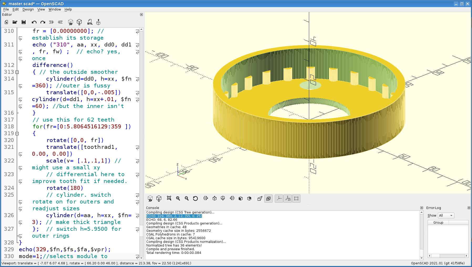

Greetings all;
My viewport suddenly developed a bad case of vertical strips and an
occasional moire pattern. Saving my work and exiting, then restarting
and reloading my work didn't fix it, rather like the view was split into
360 segments but each segment was only .99 degrees wide. The pattern
scales same as the work, previews and renders are ghostly looking and
sorta see thru.
I added a line to echo all the vars that might be responsible:
echo(329,$fn,$fs,$fa,$vpr);
329 is the line number.
and it outputs this:
ECHO: 329, 360, 2, 12, [55, 0, 25]
Can this be fixed?
Thanks all.

Post a screen capture.

Gene Heskett
Thu, Jul 8, 2021 7:48 AM
Attached.

Try turning off View/View-edges, and/or reduce $fn.

That looks rather like displays I've sometimes had. On at least one
occasion 'normality' was restored by rendering and then previewing
again.

I  expect the 'quick render' (F5) to be all messed up for complex
objects.  The 'full render (F6) is the one I'd be concerned with,
ultimately the stl file. With any screen resolution, you can often hit
on interference patterns. Basically it is the result of a digital
representation of an analogue world.

Gene Heskett
Thu, Jul 8, 2021 1:58 PM
And that was the instant magic twanger, thank you very much. I've no clue
how it got turned on.
Cheers, Gene Heskett
