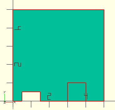

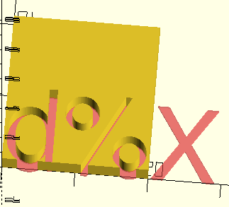

Wow, this is a bug, not an artifact, and it applies to preview, CGAL,
and Manifold, and it has been there since OpenSCAD first got text().
linear_extrude(6) {
         square(20);
         text("3Z");
text("3Z") or text("ch"): the Z and h don't show up. That 3 and c have
round bottoms seems to be the trigger.
text("4Z"): the Z shows up
text("3O") or text("cb"): the O and b do show up, apparently because
they also have round bottoms
text("oA") or text("oB" or text("o#"): only the holes in A, B and # show up
text("oi") or text("d%"): only the dot on the i and the o's in the % show up
It may be the font used, but in my test "o%" shows properly.
Checking it further (using # before the text) shows that the '/' in the
% character extends below the baseline.
text("o*") or text("o+"): no problem when the second characters don't
touch baseline
text("/A") or text(",A"): certain other characters like / and , also
trigger the problem.
In other weirdness, adding # for #text() shows a +/-0.5 mm extrusion in
red, instead of a 6 mm extrusion.
This is understandable, I think, because text() is a 2D object, and by
itself is shown as if it was extruded a tiny amount.

                            Adding valign="bottom" to the text() command appears to correct the issue.

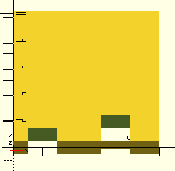

My expectation was that this behavior would not be tied to text() per
se, but rather to subtracting a 2D object with a coincident edge.  And
indeed, here's a test case:
    square(5);
    translate([1,0,0]) square(1,center=true);
    translate([3,0,0]) square(1);
Preview (tilted to make the Z-fighting visible):
Render:
It seems to require both a coincident edge and another subtraction that
crosses the edge; removing the first square fixes the problem with the
second square.
Using an experimental PR#4478 build that can extract the results of a
render, I get:
{ min : [0, 0, 0], max : [5, 5, 0], center : [2.5, 2.5, 0], size :
[5, 5, 0], objects : [ { points : [ [5, 5], [0, 5], [0, 0], [0.5,
0], [0.5, 0.5], [1.5, 0.5], [1.5, 0], [5, 0], [3, 0], [3, 1], [4,
1], [4, 0] ], paths : [ [0, 1, 2, 3, 4, 5, 6, 7], [8, 9, 10, 11] ] } ] }
The intended square-with-two-cutouts has been turned into a figure that
is a square with one cutout overlapping with another square that should
be the second cutout.
Surprisingly, the same pattern does not produce the same result when the
cutouts are along the Y axis rather than the X axis, nor does it produce
the same results when the cutouts are along the top.  Even swapping the
two cutouts yields a "correct" result.
The workaround is, like the similar problem in 3D, to avoid having
negative objects with edges coincident with edges on the positive object.

                            Yes I have been caught out with 2D differences failing with coincident
edges. I was surprised because 3D differences in CGAL work with
coincident faces if they are exactly coincident. And 2D uses fixed point
maths, so it should be easier.

> My expectation was that this behavior would not be tied to text() per se,
> but rather to subtracting a 2D object with a coincident edge.  And indeed,
> here's a test case:
> difference() {
>     square(5);
> Render:
> second square.
> render, I get:
>     min : [0, 0, 0],
>     max : [5, 5, 0],
>     size : [5, 5, 0],
>     objects : [
>             points : [
>                 [5, 5],
>                 [0, 5],
>                 [0, 0],
>                 [0.5, 0],
>                 [0.5, 0.5],
>                 [1.5, 0.5],
>                 [1.5, 0],
>                 [5, 0],
>                 [3, 0],
>                 [3, 1],
>                 [4, 1],
>                 [4, 0]
>             paths : [
>                 [8, 9, 10, 11]
> The intended square-with-two-cutouts has been turned into a figure that is
> a square with one cutout overlapping with another square that should be the
> second cutout.

                Fri, Sep 6, 2024 6:13 PM
                            It is odd, to me, that it seems to be only on the x axis, and if you
swap around the positions of the squares, then it gives a different
result. The rule seems to be that if there is an object that  crosses
the x axis nearer to the origin than others that are all on the x axis
then it does not render as I would expect when differenced from the square.
translate([0,10])
  square(50);
     translate([25,10])
      square(10);
     translate([5,10])
      square(10);
  //   translate([2,10])
 //  circle (d=1);
uncomment last lines, and fn6 render - squares disappear.
      square(5);
Render:
that crosses the edge; removing the first square fixes the problem
with the second square.

}; //places text on side of nut so I know tooth shape and size of nut
> linear_extrude(6) {
>       difference(){
>           square(20);
>           text("3Z");
This is further manipulated so it is embossed on the sides of the nut
The problem is that text gets stripped to just "1","2" etc if the
following decimal point is .0  then only the 2 etc gets printed.
technically 2 or whatever is correct but that is not what I think I'm
telling it to do.
What I've done is printed a series of 40 rings, incrementing the size by
.1 and printing that on the handle tab sticking out of the threaded ring
so that I have gages that tell me how big a nut pair I must make for
each screw so each nut fits that screw perfectly. Missing the .0 for
those that are an even mm in size looks unprofessional at best. IMO it
should render and print any numerical value I put in text=.
So while looking, can this be fixed too?  Thanks.
> show up
> touch baseline

> On 9/5/24 09:12, Raymond West via Discuss wrote:
>> Testing further.
>> It seems if the second number is flat at the bottom, 1,2,7 and aligns
>> with the base of the square, and the first is a 0,2,3,5,6,8,9 then the
>> second does not f6 render. 4 is interesting. It's the same for letters.
>> On 05/09/2024 16:27, larry via Discuss wrote:
>>> On Thu, 2024-09-05 at 16:16 +0100, Raymond West via Discuss wrote:
>>>> The following code snippet
>>>> //linear_extrude(6){
>>>>      difference(){
>>>>          square(20);
>>>>         text("5.5");

                            On 9/6/2024 12:29 PM, Steve Lelievre via Discuss wrote:
Someone already pointed out that this is a 2D issue. That means
another workaround, for when you don't want to tinker with the
position of the cutaway element, is to convert to 3D before taking the
difference.
It's also a well-known 3D problem.  The most obvious effect is
Z-fighting in preview, and rendering usually gets rid of it.  However,
at least in theory the nominally-coincident faces can be microscopically
misaligned and then rendering could yield ultra-thin walls.
The best plan is to avoid coincident edges and faces.
> difference.
