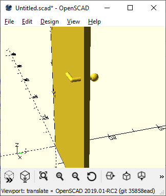

Michael Marx
Sat, Dec 7, 2019 2:41 AM
so I moved it off the
screen and can't get it centered again.
Try these two buttons

I think I got it to display but any time I try to rotate or move or zoom
it takes minutes for the software to reposition it so I moved it off the
screen and can't get it centered again. I didn't think my computer was
that slow but maybe it is, an iMac.
It appears that the object is not on the plate but elevated above it.
And there are artifacts on the plate. I would like to play with it but
maybe have to find another computer somewhere.

Thanks, I didn't know they did that.
