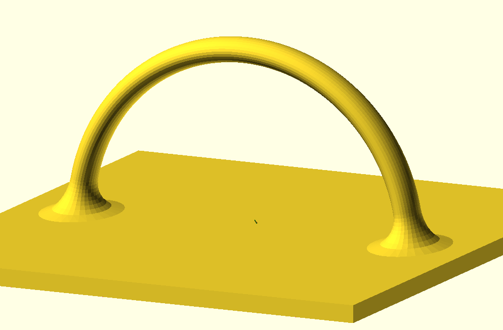

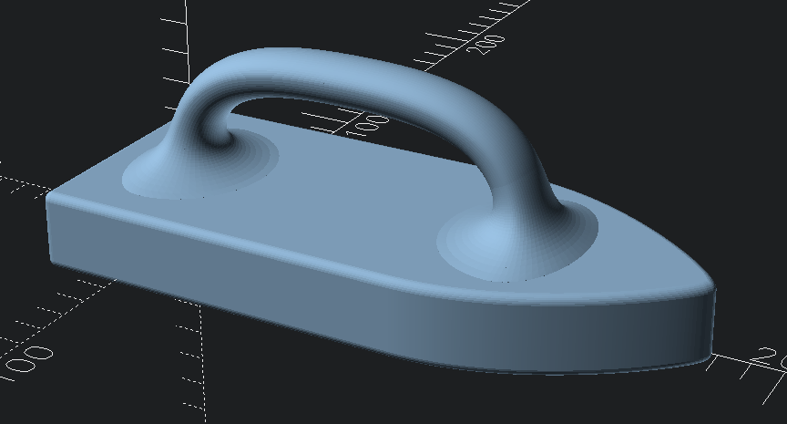

A bit of 'closure' on this question I asked last week. I tried to
understand and use the suggestions that were posted, and although I did get
some ideas from them, I couldn't quite wrap my head around them enough to
make them my own. But, in the end I've managed to produce pretty much
exactly what I wanted in plain OpenSCAD. I'm posting this more as an
encouragement to people like myself a week ago who are very intimidated by
making smooth objects in OpenSCAD, that it's absolutely possible, but may
require some different thinking, at least compared to how I myself approach
modeling other objects. I actually started out writing a pure Python
program that generated triangles and exported into Wavefront .obj format,
which is a very simple text-based 3d mesh format. (I say 'writing a pure
Python program', but actually Chatgpt wrote most of the hairy stuff). I got
the handle itself to work, then I wanted to add more functionality to
create the rest of the object I want to make, but that turned out to be
such a slog in Python, so I ported my approach from Python 1:1 to OpenSCAD.
That didn't work very well, it was essentially generating all the points
and faces to be passed to polyhedron(); but after a bit of refactoring (but
keeping the original approach) I got the attached more idiomatic OpenSCAD
version.
What it does is basically do the same steps I would do to model this object
manually in Blender. Create a list of points along a bezier curve, then
position a slightly linear_extrude()'ed polygon on each point of that
curve, rotating it to point towards the next point. Then for the 'flare' at
the base it applies a scale() to the relevant (i.e. first x) polygons,
using an exponentially decaying scaling factor. These polygons are combined
into a solid using hull() on each consecutive pair. For generating the
rounded object that forms the base of this handle, I also used hull() on a
bunch of spheres positioned at the extremes of the outline of the object.
All of this may be obvious to others; but although I do by now consider
myself an intermediate level OpenSCAD user, it still took me a radically
different way of thinking to get here. This whole process has been quite a
learning experience really, and I think it will make me consider doing
things in OpenSCAD in the future that just a week ago, I would think of as
too hard/not worth the effort.
A technical note is that I did have to use the preview builds of OpenSCAD,
as otherwise rendering this took minutes; in the preview build, less than
half a second.
And another side remark is that Chatgpt can actually be quite competent at
writing OpenSCAD code, as long as you create a custom GPT and upload the
OpenSCAD and BOSL2 manuals as zipfiles to it, and instruct it on some
stylistic things you want. It exposed me to some techniques I hadn't used
in the past but proved to be quite useful, and took care of all of the
tedious math.
cheers
Roel

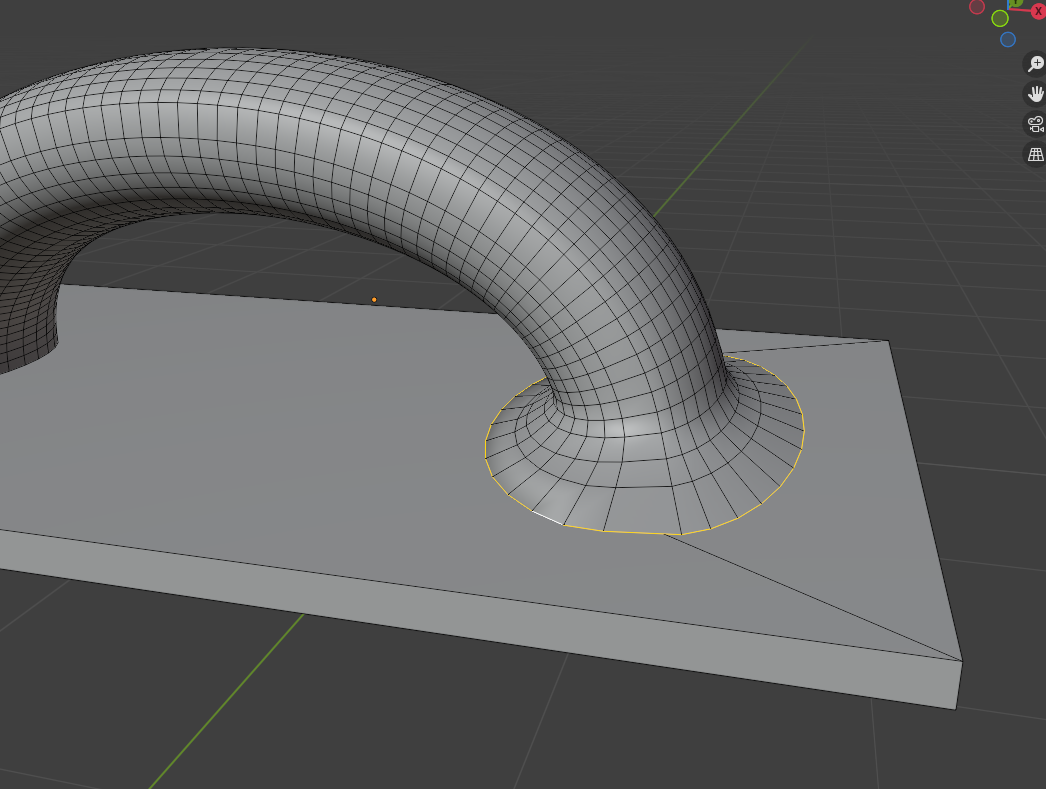

Hello all,
Another day, another filleting question! I know there have been many of
these lately (well, I guess there have always been), but I can't figure out
how to apply any of the solutions in those to my current problem, so I'm
hoping someone can point me in the right direction. I'm open to using
Python as well if that makes it easier.

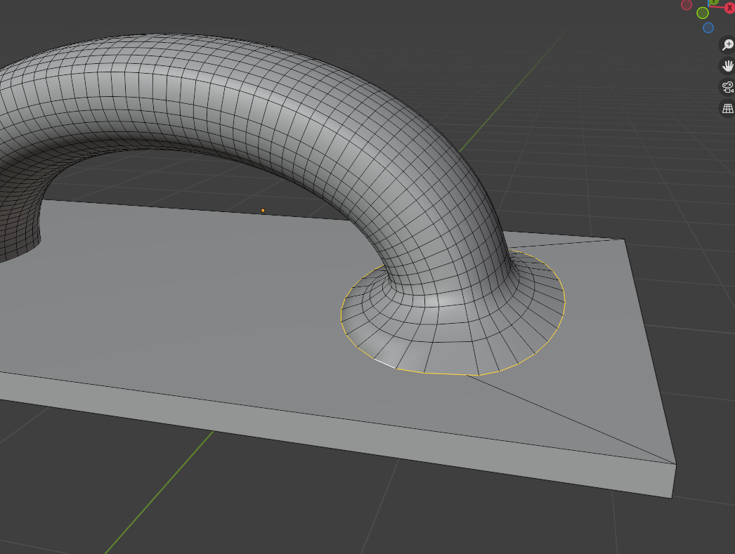

Essentially I want to create a handle with no sharp corners. I have
attached a crude example that I made in Blender. What I did there was start
out with a 2d version of the cross section of the handle, which is an
ellipse that is more squished (at least I think that's the professional
mathematician's term for it) at the top than it is at bottom. That shape is
then extruded along a Bezier curve. Then the bottom few rings of edges are
scaled in the X and Y axes, each subsequent one a bit less, the amounts of
the scaling factors forming an exponential decay curve or some such.
I don't think this sort of direct edge manipulation is possible in
OpenSCAD, but I also can't think of a CSG equivalent of these operations. I
mentioned Python OpenSCAD above because I know it has an extrude along path
function, which would get me partly there, but can I also then select and
manipulate vertices on the result mesh? Or can I go the other way around -
scale the cross section 2d shape on each segment of the bezier and then do
a hull() of all the result 2d shapes in plain OpenSCAD? Thanks!
did get some ideas from them, I couldn't quite wrap my head around
them enough to make them my own. But, in the end I've managed to
produce pretty much exactly what I wanted in plain OpenSCAD. I'm
posting this more as an encouragement to people like myself a week ago
who are very intimidated by making smooth objects in OpenSCAD, that
it's absolutely possible, but may require some different thinking, at
least compared to how I myself approach modeling other objects. I
actually started out writing a pure Python program that generated
triangles and exported into Wavefront .obj format, which is a very
simple text-based 3d mesh format. (I say 'writing a pure Python
be such a slog in Python, so I ported my approach from Python 1:1 to
OpenSCAD. That didn't work very well, it was essentially generating
all the points and faces to be passed to polyhedron(); but after a bit
of refactoring (but keeping the original approach) I got the attached
more idiomatic OpenSCAD version.
object manually in Blender. Create a list of points along a bezier
curve, then position a slightly linear_extrude()'ed polygon on each
point of that curve, rotating it to point towards the next point. Then
for the 'flare' at the base it applies a scale() to the relevant (i.e.
first x) polygons, using an exponentially decaying scaling factor.
These polygons are combined into a solid using hull() on each
consecutive pair. For generating the rounded object that forms the
base of this handle, I also used hull() on a bunch of spheres
consider myself an intermediate level OpenSCAD user, it still took me
a radically different way of thinking to get here. This whole process
has been quite a learning experience really, and I think it will make
me consider doing things in OpenSCAD in the future that just a week
ago, I would think of as too hard/not worth the effort.
OpenSCAD, as otherwise rendering this took minutes; in the preview
build, less than half a second.
competent at writing OpenSCAD code, as long as you create a custom GPT
and upload the OpenSCAD and BOSL2 manuals as zipfiles to it, and
instruct it on some stylistic things you want. It exposed me to some
techniques I hadn't used in the past but proved to be quite useful,
and took care of all of the tedious math.
cheers
Roel

 Hello all,
 many of these lately (well, I guess there have always been), but I
 can't figure out how to apply any of the solutions in those to my
 current problem, so I'm hoping someone can point me in the right
 direction. I'm open to using Python as well if that makes it easier.
 have attached a crude example that I made in Blender. What I did
 there was start out with a 2d version of the cross section of the
 handle, which is an ellipse that is more squished (at least I
 think that's the professional mathematician's term for it) at the
 top than it is at bottom. That shape is then extruded along a
 Bezier curve. Then the bottom few rings of edges are scaled in the
 X and Y axes, each subsequent one a bit less, the amounts of the
 operations. I mentioned Python OpenSCAD above because I know it
 has an extrude along path function, which would get me partly
 there, but can I also then select and manipulate vertices on the
 result mesh? Or can I go the other way around - scale the cross
 section 2d shape on each segment of the bezier and then do a
version.
object manually in Blender. Create a list of points along a bezier curve,
then position a slightly linear_extrude()'ed polygon on each point of that
OpenSCAD, as otherwise rendering this took minutes; in the preview build,

Hello all,
version.
at writing OpenSCAD code, as long as you create a custom GPT and upload the
tedious math.

A bit of 'closure' on this question I asked last week. I tried to understand and use the suggestions that were posted, and although I did get some ideas from them, I couldn't quite wrap my head around them enough to make them my own. But, in the end I've managed to produce pretty much exactly what I wanted in plain OpenSCAD. I'm posting this more as an encouragement to people like myself a week ago who are very intimidated by making smooth objects in OpenSCAD, that it's absolutely possible, but may require some different thinking, at least compared to how I myself approach modeling other objects. I actually started out writing a pure Python program that generated triangles and exported into Wavefront .obj format, which is a very simple text-based 3d mesh format. (I say 'writing a pure Python program', but actually Chatgpt wrote most of the hairy stuff). I got the handle itself to work, then I wanted to add more functionality to create the rest of the object I want to make, but that turned out to be such a slog in Python, so I ported my approach from Python 1:1 to OpenSCAD. That didn't work very well, it was essentially generating all the points and faces to be passed to polyhedron(); but after a bit of refactoring (but keeping the original approach) I got the attached more idiomatic OpenSCAD version.
What it does is basically do the same steps I would do to model this object manually in Blender. Create a list of points along a bezier curve, then position a slightly linear_extrude()'ed polygon on each point of that curve, rotating it to point towards the next point. Then for the 'flare' at the base it applies a scale() to the relevant (i.e. first x) polygons, using an exponentially decaying scaling factor. These polygons are combined into a solid using hull() on each consecutive pair. For generating the rounded object that forms the base of this handle, I also used hull() on a bunch of spheres positioned at the extremes of the outline of the object.
All of this may be obvious to others; but although I do by now consider myself an intermediate level OpenSCAD user, it still took me a radically different way of thinking to get here. This whole process has been quite a learning experience really, and I think it will make me consider doing things in OpenSCAD in the future that just a week ago, I would think of as too hard/not worth the effort.
A technical note is that I did have to use the preview builds of OpenSCAD, as otherwise rendering this took minutes; in the preview build, less than half a second.
And another side remark is that Chatgpt can actually be quite competent at writing OpenSCAD code, as long as you create a custom GPT and upload the OpenSCAD and BOSL2 manuals as zipfiles to it, and instruct it on some stylistic things you want. It exposed me to some techniques I hadn't used in the past but proved to be quite useful, and took care of all of the tedious math.
cheers
Roel
[image.png]
include <BOSL2-master/std.scad>;
$fn = $preview ? 32 : 128;
module squished_circle(radius, squish_top, squish_bottom, num_points) {
points = [
for (i = [0:num_points - 1])
let (
angle = i * 360 / num_points,
x = radius * cos(angle),
y = radius * sin(angle),
squish = (y > 0) ? (1 - squish_top) : (1 - squish_bottom)
[x, y * squish]
linear_extrude(height=0.01)
polygon(points);
// Function to calculate the Y-axis angle for a point
function calculate_y_angle(index, points) =
index < len(points) - 1 ?
atan2(points[index + 1].z - points[index].z, points[index + 1].x - points[index].x) :
atan2(points[index].z - points[index - 1].z, points[index].x - points[index - 1].x);
// Module to render a rotated squished circle at a given point
module render_squished_circle(position, angle_y, scale_) {
translate(position) {
yrot(90 - angle_y) // Rotate around Y-axis to face next segment
zrot(90) // Rotate around Z-axis
scale([scale_, scale_, 1])
squished_circle(10, top_squish, bottom_squish, circumference_resolution);
// Function to calculate a smooth transition from max_scale to 1
function calculate_scale(i, num_rings, max_scale, decay) =
(i < num_rings) ?
1 + (max_scale - 1) * (exp(-decay * i / (num_rings - 1)) - exp(-decay)) / (1 - exp(-decay)) * (1 - 0.5 * (1 - cos(PI * i / num_rings))) :
1;
module bezier_curve(p0, p1, p2, p3, num_segments) {
bezier_points = [
for (i = [0:num_segments])
let (
t = i / num_segments,
x = (1 - t)^3 * p0.x + 3 * (1 - t)^2 * t * p1.x +
3 * (1 - t) * t^2 * p2.x + t^3 * p3.x,
y = (1 - t)^3 * p0.y + 3 * (1 - t)^2 * t * p1.y +
3 * (1 - t) * t^2 * p2.y + t^3 * p3.y,
z = (1 - t)^3 * p0.z + 3 * (1 - t)^2 * t * p1.z +
3 * (1 - t) * t^2 * p2.z + t^3 * p3.z
[x, y, z]
for (i = [0 : len(bezier_points) - 2]) {
// Get current point and angle
p1 = bezier_points[i];
angle1_y = (i == 0) ? 90 : calculate_y_angle(i, bezier_points);
// Get next point and angle
p2 = bezier_points[i + 1];
angle2_y = (i == len(bezier_points) - 2) ? 0 : calculate_y_angle(i + 1, bezier_points);
scale1 = calculate_scale(i, num_rings, max_scale, decay);
scale2 = calculate_scale(i + 1, num_rings, max_scale, decay);
// Hull between current and next squished circles
hull() {
render_squished_circle(p1, angle1_y, scale1);
render_squished_circle(p2, angle2_y, scale2);
module half_handle(p0, p1, p2, p3, num_segments) {
// Render the Bezier curve
bezier_curve(p0, p1, p2, p3, num_segments);
// Parameters
handle_diameter = 20;
top_squish = 0.4;
bottom_squish = 0.1;
circumference_resolution = 64;
handle_width = 120;
handle_height = 40;
max_scale = 3;
num_rings = 30;
decay = 5;
module handle(start_curve_height) {
p0 = [0, 0, 0];
p1 = [0, 0, start_curve_height];
p2 = [handle_width / 2 - 30, 0, handle_height];
p3 = [handle_width / 2, 0, handle_height];
num_segments = 128;
half_handle(p0, p1, p2, p3, num_segments);
right(handle_width)
zrot(180)
