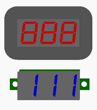

I saw a recommendation to use resize() to make text fit into a box the
other day, but it doesn't work with a mono-space font.
Here I am trying to fit three digits in a box but it fails if the first
digit is a one.
The text would fit if it was offset but resize doesn't offset, it only
scales. If the thing it is scaling isn't centred around the origin the
result isn't centred but it seems to be scaled around its centre. I bodged
it by adding a tiny square at the origin, which is too small to see.
Not quite correct because the one is slightly too tall when there are no
top segments. Since I don't know the height of the text I can't put a dummy
pixel at the top.

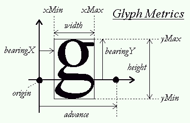

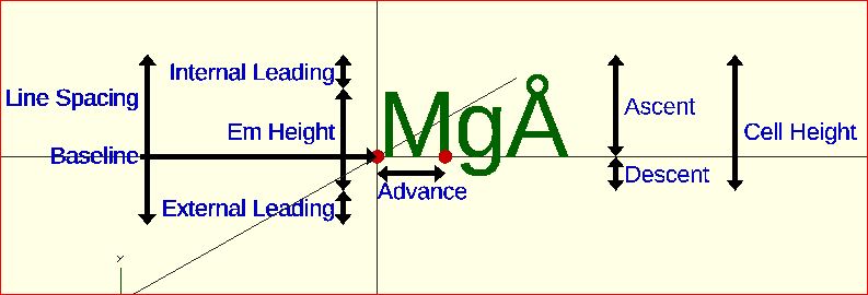

OzAtMichael
Wed, Apr 22, 2020 4:11 AM
there's no one set of text metrics that would make everybody happy.
You want the likes of:
(some nomenclature varies by source)
The first is from FreeType https://www.freetype.org/freetype2/docs/tutorial/step2.html
The second was me documenting other properties, some of which are font related rather than glyph.
(note the red dots are origin of M & g)
That stuff is available from FreeType per glyph, but when a sequence of glyphs are rendered
(FreeType render, not OpenSCAD)
due to kerning & hinting you need to measure the render, as shown in the above link.
Even then, there can be 'funnies' where glyph renders can go outside of such metrics. For example
part of the glyph could be in front of the origin.
So some combination of glyph metrics from FreeType, and measuring of the render would be needed.
For example, you may want bbox including the bearingX of the first glyph if you want it to layout
nicely,
or you may want it without bearingX & the equivalent blank at the end (advance-bearingX-width) so
you can absolutely align an edge.
This is not simple stuff.

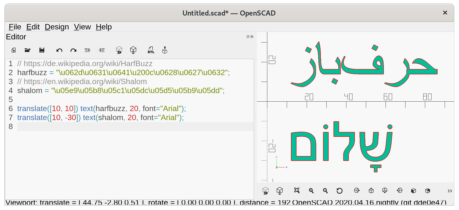

But it would not solve any of the cases you mentioned. Also
note it's not just up/down.
Try http://pomax.github.io/Cursive-swash-typeface/
Interesting example: Clear the input field and type a lower
case 'g'... now type another one.
The glyph bounding box is not where you think it is, and
it gets more interesting with right-to-left scripting
languages, like Persian and Hebrew (see screenshot). I'm

The screenshot has 2 strings, each with 7 Unicode code
points. Maybe that's showing things are not as simple as
it looks at the first glance. It took quite some extra work
getting those to render correctly (as far as the font
allows), mainly thanks to the awesome HarfBuzz library.
I would not like to see that support for languages other
than those using Modern Latin Alphabet limited by adding
interfaces that don't work in general.
