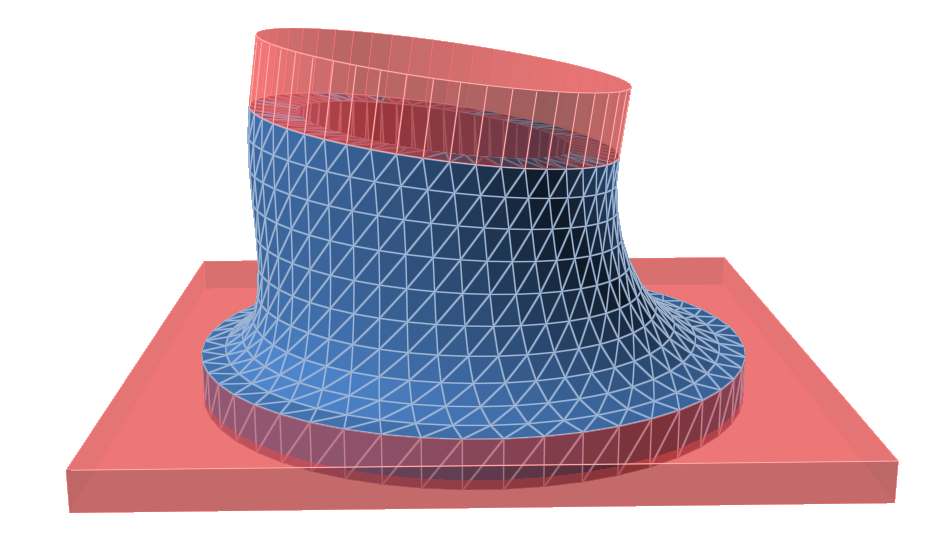

My method defaults to arcs - when this is possible. In most cases it is
not possible. I use what I call generalized arcs. These can contain a
single inflection. I attach an image with a quite unusual placement of
the fillet to demonstrate that the curves - although often very similar
to arcs - are in general not arcs due to the given boundary conditions.
As I have learned one could also use biquartic Beziers to smoothly align
quad patches. However, these have lots of degrees of freedom (5*5
control points)
and I would not know how to best compute those 25 control points for a
patch from a tuple of 4 PN pairs (point-normal pairs). Besides that you
never get a perfect arc from a Bezier.

@ Sanjeev: You are seeking for a general method. And such a method would
have to find and use a path along the intersection. As I think I pointed
out before, many approaches are possible. In my image of a fillet, the
line of intersection is not used at all. In the case of the object (a
pan?) that you are trying to make, I think that the wanted path should
be constructed (as you seem to do in Python) and that it can be
constructed also within OpenSCAD. The prerequisite would be two functions:
f1(t) would produce a point on the path that generates the large part of
the object. The angle of rotation can be applied outside of that function.
f2(u,v) would generate a point on the smaller object which seems to be
mainly a linear extrusion of a path with some scaling along the way.
If you can provide those two functions than I could assist in creating a
function which finds the path along the intersection of both. Since we
can pass functions as arguments in OpenSCAD, such an
intersection-finding function might be quite helpful for other users who
want to create fillets.
