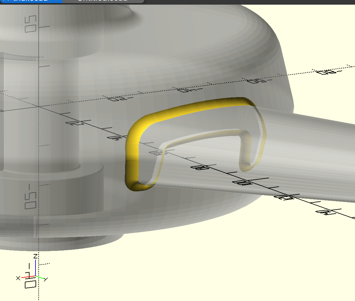

In the desire to provide a safe, easy and intuitive way to create
aesthetically rounded organic forms in OpenSCAD, I developed a library
called 'Yari'. Some of its features are visually presented here. In the
literature which was accessible to me, I did not find what I was looking
for. Therefore all of the used approaches (except for the VFH) are based
on my own thinking and experiments rather than on published papers.
I would classify the resulting approach as an interpolating, geometric,
bivariate, iterative subdivision scheme for PNs (Points with Normals). A
related recent paper of Yang, Xunnian is "Point-Normal Subdivision
Curves and Surfaces" (preprint, v2 of Dec. 2022, [2210.07974] on
arXiv.org). It describes similar goals and produces partially similar
results but the used approach is totally different from mine. One
difference is that the Yari library handles S-shaped boundary conditions
without any problem (compare the discussion of inflections in the cited
paper). Another difference is that the approach taken with Yari is
iterative rather than recursive. Accordingly, refinement is not
restricted to powers of two. This reminds more to NURBS than to
traditional subdivision schemes.
Yari aggregates patches (e.g. curved triangles and quads) to surfaces
with borders or to closed surfaces. These aggregates are held in a
half-edge data structure called VFH (Vertices, Faces and Half-edges) as
BREP. The VFH keeps also the normals. An OpenSCAD polyhedron can be
turned into a VFH and a VFH can be interpolated into an OpenSCAD polyhedron.
*xing_test
Input: Four points with simple and intuitive unit normals.
*Output: *The quad patch is interpolated and replicated 32 times.
This gives a system of sprues with perfectly circular cross sections
and with perfectly sine-shaped longitudinal cuts. The sprues form
perfectly circular holes.
  • torus_test_3x3
    *Input: *3x3 points with normals, regularly placed on a torus.
    Output: The nine patches interpolate to a perfect torus.
*pyramid_test
*Input: *An irregular pyramid made of four triangles and a quad. All
of its corners are on a sphere and the unit normals are taken
directly from the points.
Output: The pyramid interpolates to a perfect sphere.
*tripod_from_PDRAs
*Input: *Three points with unit directions, radii and (negative or
positive) opening angles.
*Output: *A smooth bordered surface spanned by the given pod ends.
By the way, symmetric, parallel, diverging pods with other lengs of
legs work as well.
Originally the purpose of this library was to design some jewelry.
Meanwhile I think that the library might be of worth in its own right.
What do experts here think about the shown features?
What would you suggest me to do with the developed algorithms?
-- Martin

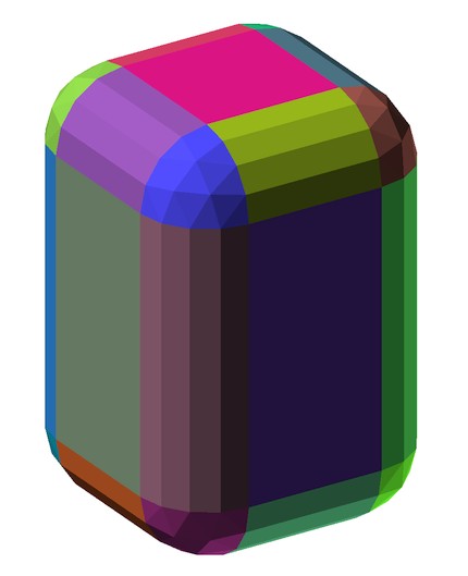

The equivalent of cuboid([20,20,30], fillet=5) created from patches with
my library looks like this
and produces a CSG with this structure:
group() {
    group() {
        multmatrix([[1, 0, 0, 0], [0, 1, 0, 0], [0, 0, 1, 0], [0, 0, 0,
1]]) {
            group() {
                group() {
                    group() {
                        group() {
polyhedron(points = [...], faces = [...], convexity = 2);
            group() {
                group();

The equivalent of cuboid([20,20,30], fillet=5) created from patches with my library looks like this and produces a CSG with this structure: group() {     group() {         multmatrix([[1, 0, 0, 0], [0, 1, 0, 0], [0, 0, 1, 0], [0, 0, 0, 1]]) {             group() {                 group() {                     group() {                         group() { polyhedron(points = [...], faces = [...], convexity = 2);                         }                     }                 }             }             group() {                 group();             }         }     } } Am 28.02.2023 um 09:01 schrieb Keith Sloan: > I recently add support in the FreeCAD OpenSCAD Alternate import for > minkowski requests that have the second object as a Sphere or a cylinder > seehttps://github.com/KeithSloan/OpenSCAD_Alt_Import. > (Embarrassingly I had created a branch two years ago but never got round to merging :-() > > I am also looking at a facility to access libraries direct from the FreeCAD OpenSCAD workbench. > On testing with BOSL the exampleshttps://github.com/revarbat/BOSL > Says > > cuboid([20,20,30], fillet=5, edges=EDGES_Z_ALL); Produces > minkowski() {cube([10,10,20], center=true); sphere(r=5, $fn=32);} Which would mean the importer would create a FreeCAD Brep Object with Fillets > but on testing I see > > include <BOSL/shapes.scad> > > cuboid([20,20,30], fillet=5); > > Produces as CSG > > group() { > group() { > group() { > group() { > group(); > } > } > multmatrix([[1, 0, 0, 0], [0, 1, 0, 0], [0, 0, 1, 0], [0, 0, 0, 1]]) { > group() { > group() { > group() { > minkowski(convexity = 0) { > cube(size = [10, 10, 20], center = true); > group() { > rotate_extrude(angle = 360, convexity = 2, $fn = 16, $fa = 12, $fs = 2) { > polygon(points = [[0, -5.09796], [1.9509, -4.7099], [3.6048, -3.6048], [4.7099, -1.9509], [5.09796, 0], [4.7099, 1.9509], [3.6048, 3.6048], [1.9509, 4.7099], [0, 5.09796]], paths = undef, convexity = 1); > } > } > } > } > } > } > } > } > }

@Adrian Mariano
Strangely I see your reply on https://lists.openscad.org/empathy/ but
not in my inbox from the mailing list.
I found approximative subdivision schemes - like e.g. the one you
mention - not satisfying for OpenSCAD.
The BOSL2 library is great and I agree that it indeed looks like a good
home for enhancements like mine.
The work of Ronaldo on VNFext could have been an excellent start into
the assembly of patches.
For me the assembly of patches proved to be a good, stepwise,
well-debuggable process with safe (2-manifold) results.
What challenges regarding usability / practicality of rounded polyhedra
did you encounter?

Wed, Mar 1, 2023 1:45 AM
It's been a couple years since I worked on it, but I recall the
difficulties with the subdivision schemes being that they were hard to
control, so getting a desired amount of rounding was not always possible.
And they were also very sensitive to exactly how a polyhedron was
triangulated, which is something that's generally invisible to you when you
examine a polyhedron in OpenSCAD.  I think they may also have been on the
slow side, especially if you wanted to do several iterations, or operate on
a polyhedron with many faces.  There was no difficulty in maintaining
validity of the 2-manifold with the subdivision approaches.  That is, valid
input lead automatically to valid output.  But then there's also the
problem that you need to actually have the polyhedron you want to operate
on available as a list of faces and vertices, which can be a challenge for
more interesting cases.
You scheme looks like it is more usable because you are able to build
interesting polyhedra from very short descriptions, though from your
examples I don't really understand the exact capabilities and limits of
your approach and implementation.    One of the things that we (the BOSL2
authors) have wondered about is how to enable people to make 3d bezier
patches that are actually useful.  Your method isn't bezier based, but it
seems like it is an approach to that basic problem of how to create 3d
structures.

Wed, Mar 1, 2023 5:15 PM
Looks interesting
Can you do fillets at the intersection of 2 solids?
example:
[image: Screenshot 2023-03-01 at 10.38.18 PM.png]
If you can do that then it would really help.
I have also tried rounding various intersecting surfaces, but it is quite
complicated many times and no generic solution at the moment.

"hard to control": True for approximating schemes which throw away all
input in each step of the recursive process. My scheme is interpolating
and iterative. The surface runs exactly through the given points with
exactly the given normals and/or tangents. You interpolate in a fixed
number of steps, no matter what granularity you want. Thinking in points
with normals seems very intuitive for me - that means easy to control
with your mind.
"desired amount of rounding": From the cuboid example (Keith Sloan) you
see that the rounding is as intuitive as it can get: You stay away from
the rounded corner by the radius of rounding. Done.
