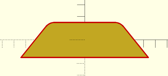

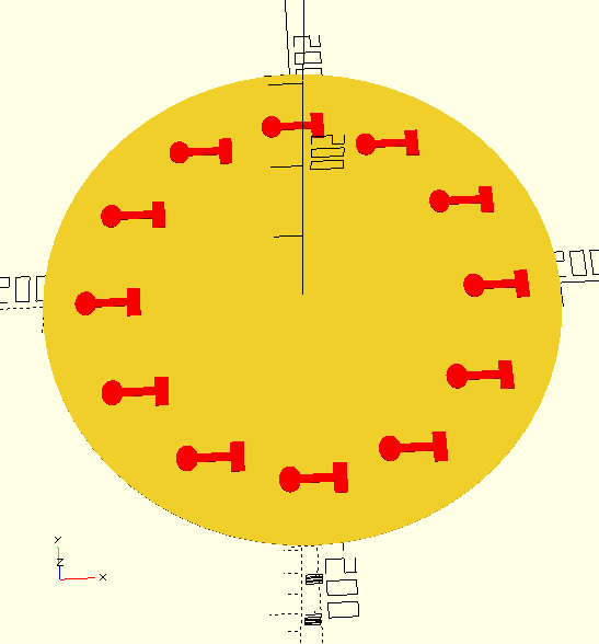

The projection() result would have to go to rotate_extrude and then it
wouldn't be so easy to put rounded caps in it.  But it's trivial to
construct the path that is equal to that projection, as shown by this code
which makes the path and gives it to stroke() to draw the red outline:
include<BOSL2/std.scad>
$fn= $preview ? 60 : 180;
spool_rad=100;
holeposition_rad=spool_rad-6;
hole_dia=6;
hole_hole_dist_max=33.9;
hole_hole_dist_min=21.9;
module profile() {
projection()
//back(1.5) right(holeposition_rad)
xrot(-90)
cyl(h=3,d1=hole_dia*1.8,d2=hole_dia,rounding2=1);
stroke(trapezoid(h=3,w1=hole_dia*1.8,w2=hole_dia,rounding=[1,1,0,0]),width=.1,color="red",closed=true);
profile();
The output of trapezoid is a path that can go to rotate_sweep or path_sweep.

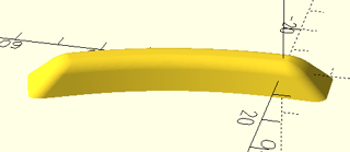

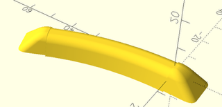

rotate_extrude worked!
Here's the code for the basic object. It previews in .167 seconds and
renders in 1.257 seconds.
Thanks Adrian!
$fn= $preview ? 60 : 360;
spool_rad=100;
hole_dia=6;
rotate_extrude(angle=30) profile();
right(holeposition_rad) up(1.5) end_cap();;
zrot(30) right(holeposition_rad) up(1.5) end_cap();
up(2.5)filament_slot();
module end_cap() {
module profile() {
projection() back(1.5) right(holeposition_rad) xrot(-90)
end_cap();
module filament_slot() {
rotate_extrude() right(holeposition_rad) circle(1.84/2);

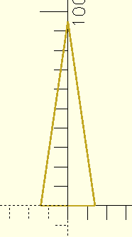

For those dimensions, I get an angle for the pointy end of 16.7° and the
two big angles being 81.6°.  So that matches BOSL2's result.
I drew the triangle like so (not to scale):
         / |T\
   96   /  |  \  96
          27.9
so that's two identical right triangles, each with the hypotenuse being
96 and one other side being 27.9/2.
Calling half of the top - the angle of the right triangle - T, sin(T) =
(27.9/2) / 96.  So T is asin((27.9/2)/96), which is about 8.4°,  That's
only half of the top, so all of the top is about 16.7°.  The angles of a
triangle total to 180°, so the other two angles are each (180 - 16.7)/2,
which is about 81.6°.  (I actually did the calculation with OpenSCAD and
the result was exactly the 81.6446° that you got.)  Or you could more
directly calculate the big angle using cosine - its cosine is
(27.9/2)/96, and the arc cosine of that is again 81.6446.
Here's a quick OpenSCAD program that draws the triangle, assembling
sides with those dimensions at the angles calculated.
base = 27.9;
side = 96;
T = asin((base/2)/side);
theta = T*2;
a = (180-theta)/2;
echo(T, theta, a);
square([base, 1], center=true);
translate([-base/2, 0]) rotate(a-90) translate([-0.5,0]) square([1, side]);
translate([base/2, 0]) rotate(90-a) translate([-0.5,0]) square([1, side]);

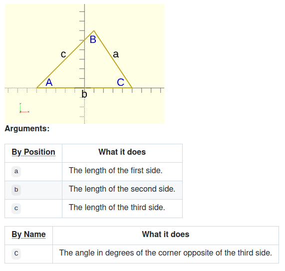

That's exactly what I got when I used that same statement. It gives me
angle A (using the terminology in the BOSL2 description (attached) and
in three triangle calculators.
My problem was that I had been using 24.66, but I just figured out my
problem. Somehow I measured the hole spacing incorrectly, or perhaps I
calculated it badly, as I measured the hole distance with calipers,
using the inner and outer sides and subtracting the hole diameter.
So after tweaking it for better accuracy, my rotate_extrude is:
rotate_extrude(law_of_cosines(c=39.5,b=96,a=96)) profile();
Thank you for your patience, and please accept my apologies.

One of the great things about BOSL2 I find that I very rarely have to go to the trigonometry aspects. I can do it but it always hurts my brain and need more coffee. Even more important, the code tends to be very brittle for changes.
My favorite shape is rounded_prism, and when I look at your clip I immediately see half a rounded_prism in the capped ends. Logically I see it is a rounded_prism cut in half and then a sweep of the crosscut inserted.
Since you can turn the rounded_prism into a vnf, you can use projection() to get a crosscut profile of the middle, which profile is then ideal to create the sweep.
So I came up with this:

I was slightly disappointed since I started with attachments, which was arguably simpler:
module clip(
r          = 100,              // mm spool radius
clip_span  =  25,              // degree span on radius
clip_h      =  6,              // height of the clip
cap_bot    = [20,12],          // cap end bottom
cap_top    = [6,6],            // cap end top
cap_rounding=  2,              // cap rounding
cap = rounded_prism(
    rect(cap_bot),
    rect(cap_top),
    h           = clip_h,
    joint_sides = cap_rounding,
    joint_top   = cap_rounding,
    joint_bot   = 0,
    k           = 0.9, // sorry Adrian
crosscut    = projection( yrot(90,cap), true ); // -> region
profile     = zrot(90, crosscut[0]); // -> 2D path
sweep       = turtle( [
        "arcleft", r, clip_span
vnf_polyhedron( left_half( cap ) )
attach(RIGHT,"start")
path_sweep( profile, sweep )
attach("end", LEFT)
vnf_polyhedron( right_half( cap ) )
Unfortunately, the sweep did not properly attach to the rounded_prism vnf :-( The anchors are not properly aligned. Maybe Adrian can shed some light on this?
Peter

I tried the BOSL2 law_of_cosines() and I'm getting results that are
nowhere near 24.66. Here's a snippet I tried:
!get_ang();
module get_ang() {
ang = law_of_cosines(a=27.9,b=96,c=96);
echo (ang);
This outputs ECHO: 81.6446
Any explanation gratefully received.

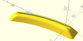

So here's my (almost) finished code for an Overture cardboard spool. I
say almost because I am still tweaking the cut for the filament channel
height to make it easy to snap the filament in but just enough to
ensure it will stay put until I pop it out.

Fri, Sep 26, 2025 3:16 PM
You can get the attachment version to work by using “start-centroid” and
“end-centroid” for the anchors of the sweep.
There may be a problem with vnf anchors.
What is a vnf?  BOSL2 can’t work on 2d geometry because it can’t access the
point data. Instead you have to use a point list which we call a path. The
vnf is the 3d version of this.  For Peter’s example that’s all you need to
know. Internally it’s the vertices ‘n’ faces that you would pass to
polyhedron() in native openscad to create the shape.
include <BOSL2/rounding.scad>
$fn = $preview ? 60 : 100;
module clip(
clip_span  =  40,              // degree span on radius
filament_r  = (1.75 + 0.05)/2,  // torus for the filament
filament_shift=0.5,            // z-shift for torus to make it 'clip'
     rect(cap_bot),
     rect(cap_top),
     h           = clip_h,
     joint_bot   = 0,
     k           = 0.9 // sorry Adrian
 crosscut    = projection( yrot(90,cap), true ); // region
 sweep       = turtle( [
 end_of_sweep = point3d( sweep[ len(sweep)-1 ],0);
     vnf_polyhedron( left_half( cap ))
     translate( end_of_sweep )
     zrot( clip_span )

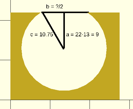

Well, here I am again, with a puzzler (for me it's a puzzle).
I have come pretty far along in my code, but one bit of it I arrived at
by trial and error. I found the rotation angle I needed for the pins by
rendering the object and using the measurement tool to arrive at the
right distance.
I never did take any trig in my schooling, so anything requiring it has
to be either looking up how to do it or trial and error.
So, In the code, I use a rotation angle of 24.66 in the xrot statement.
I do want to make this parametric, so I figured I'd use trig.
I have the three lengths of the triangle and want to find angle A.
!get_ang();
module get_ang() {
echo (ang);

You can get the attachment version to work by using “start-centroid” and “end-centroid” for the anchors of the sweep.
module clip(
     rect(cap_bot),
     rect(cap_top),
     h           = clip_h,
     joint_bot   = 0,
 sweep       = turtle( [
     zrot( clip_span )
     // remove the filament torus
     up( clip_h/2 - filament_shift)
     ymove(r)  // center of spool
     torus( or = r+filament_r, ir=r-filament_r )
clip();
<PastedGraphic-1.png>
module clip(
     rect(cap_bot),
     rect(cap_top),
     h           = clip_h,
     joint_bot   = 0,
 sweep       = turtle( [
 attach("end", LEFT)
<PastedGraphic-2.png>
