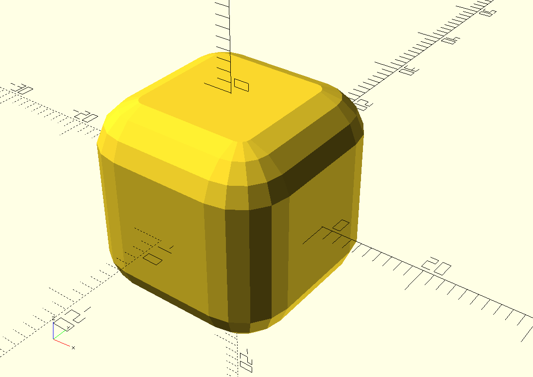

I have found in DesignSpark that I can right-click on an object in the
Structure view and select 'Convert to solid' -> 'Merge faces' and undo the
unsavory behavior of OpenSCAD
Paul

What you call "unsavory" behaviour of OpenSCAD is a standard procedure most
software do when exporting stl. If you want to discard the disposable edges
of the stl in Sketchup use the plugin Cleanup by Thomthom (
http://sketchucation.com/pluginstore?pagecount=1&author=1149&listtype=1&currentpage=1&actualpage=Next+%3E
What I call unsavoury behaviour is the ability Sketchup has to destroy the
topology when importing a healthy stl with a dense set of vertices. To
confirm this just import any gear you find in Thingverse. To solve this you
will need another plugin by Thomthom: Solid Inspector and a lot of manual
work.

Paul, Ronaldo:
The best way to import STLs into SketchUp is to first use an external
utility (NetFabb Basic is fine) to make them 10 or 100 times larger than
the original.  Then SketchUp does not bother to "fix" the fine/detailed
aspects of the model, and you do not have to use Cleanup or Solid
Inspector.  I then re-scale them back down when I'm done, sometimes in
SketchUp, but sometimes using NetFabb Basic again.

I tried Cleanup2 in Sketchup.  Although it improved the model, it still
left two co-planar facets on each face which DesignSpark treated, of
course, as separate items.  I still had to use DesignSpark's 'merge
faces' capability.
