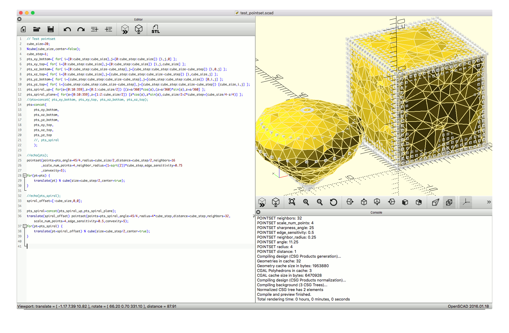

Mwahahaha! Function read_xyz() added. https://github.com/clothbot/openscad/tree/read_issue1324 https://github.com/clothbot/ClothBotCreations/blob/master/examples/test_read_xyz.scad https://github.com/clothbot/ClothBotCreations/blob/master/examples/oni.xyz Aside: The error is expected because of the read_xyz("invalid.xyz") call. <http://forum.openscad.org/file/n15777/test_xyz_screenshot.png> -- View this message in context: http://forum.openscad.org/Reversed-faces-tp15649p15777.html Sent from the OpenSCAD mailing list archive at Nabble.com.
