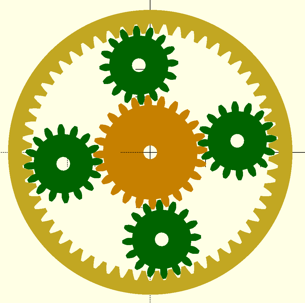

Anyone use BOSL2 to create a set of planetary gears? I searched for
"planetary" on the BOSL2 cheat sheet and had no matches

All the gears are in gears.scad. I made a brief effort to determine what
exactly a "planetary gear" set is, and didn't achieve enlightenment. It
does appear that they usually (?) include a ring gear around the outside,
though, and that type of gear doesn't appear in gears.scad. You can post
an issue on the github requesting support for such gears.

That seems unlikely to work well. The gear needs to have properly shaped
teeth to mesh with the teeth of the other gear and allow the teeth to
rotate past each other. It seems like differencing away a different gear
won't leave the right tooth form.

Sun, Jun 18, 2023 4:05 AM
On Jun 17, 2023, at 9:19 AM, Adrian Mariano avm4@cornell.edu wrote:
That seems unlikely to work well. The gear needs to have properly shaped teeth to mesh with the teeth of the other gear and allow the teeth to rotate past each other. It seems like differencing away a different gear won't leave the right tooth form.
On Sat, Jun 17, 2023 at 12:06 PM Daniel <daniel@puggsy.net mailto:daniel@puggsy.net> wrote:
It might be possible to create the ring by difference()ing a normal gear from a slightly bigger cylinder but I haven't tried so don't know how well it would work
Actually, BOSL2's spur_gear() module already lets you make interior-toothed ring gears. You just need to set interior=true and difference it from a larger diameter cylinder.
Here's code for a full animatable planetary gear assembly:

Sun, Jun 18, 2023 11:16 AM
This is really great, Revar!
I leave it to you whether this deserves to be a separate module() in the
library, or an example in the documentation, or neither. For now, I am
all set!
all set!

> Actually, BOSL2's `spur_gear()` module already lets you make
> interior-toothed ring gears. You just need to set `interior=true` and
> include <BOSL2/std.scad>
> include <BOSL2/gears.scad>
> $fa=1; $fs=1;
> rteeth=56; pteeth=16; cteeth=24;
> pitch=5; thick=10; pa=20;
> prad = 31.8;
> cp_ratio = cteeth / pteeth;
> pr_ratio = pteeth / rteeth;
> rdiam = outer_radius(pitch,rteeth,interior=true) + 5;
> diff()
> cyl(r=rdiam,l=thick)
> tag("remove")
> spur_gear(
> pitch=pitch, teeth=rteeth, thickness=thick+1,
> pressure_angle=pa, interior=true);
> for (a=[0:3]) {
> zrot($t*90+a*90) back(prad) {
> color("green")
> spur_gear(
> pitch=pitch, teeth=pteeth,
> thickness=thick,
> shaft_diam=5,
> pressure_angle=pa,
> spin=-$t*90*rteeth/pteeth);
> color("orange")
> zrot($t*90*rteeth/cteeth+$t*90+180/cteeth)
> spur_gear(
> pitch=pitch, teeth=cteeth,
> thickness=thick,
> shaft_diam=5,
> pressure_angle=pa);
> - Revar
> OpenSCAD mailing list

Revar:
prad of 31.8 seems suspiciously specific. Is there some magic for
creating that number so that things work properly?
Thank you!

Yeah, I chose that number by trial and error, but the correct code to calculate it is:
prad = (pitch_radius(pitch,rteeth) +
pitch_radius(pitch,cteeth)) / 2;
On Jun 18, 2023, at 7:19 AM, jon jon@jonbondy.com wrote:
