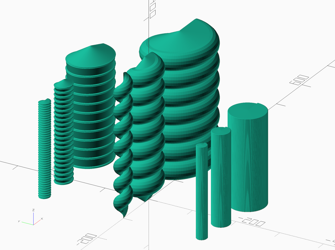

With chat of libraries and the like, I thought I would provide a module that I wrote that I’ve found very helpful in my own work.
I call it “spiral_extrude” and it’s a linear/rotate extrude hybrid.
It’s particularly useful for bolt threads, or perhaps for anyone who wants to model balusters.
It works kind of like the twist parameter in linear extrude except that each spiral extrusion is stitched to the earlier layer forming a closed watertight polyhedron.
(At least I HOPE it does).
Before I release it into the wild (i.e. thingiverse) I’d appreciate feedback… particularly performance improvements, efficiencies or oversights… and then again,  if someone identifies that some existing OpenSCAD functionality does this already and my module is redundant, that would be good to know too. :)
spiral_extrude() does require a set of profile points, but I hope that’s not too much of a drawback. As far as I could determine, there’s no way accomplish the spiral stitching with OpenSCAD 2d objects.
Here’s a picture of the examples produced by the module followed by the code…
spiral_extrude(height, profilePoints, radius, pitch)
from a set of xy points that define a profile, e.g.
	[[0,0], [0,.4],[1,1], [1, 1.4], [0,2]]
produce an spiral extruded polyhedron with the specified pitch and radius and of length height along the z axis.

With chat of libraries and the like, I thought I would provide a module that I wrote that I’ve found very helpful in my own work. I call it “spiral_extrude” and it’s a linear/rotate extrude hybrid. It’s particularly useful for bolt threads, or perhaps for anyone who wants to model balusters. It works kind of like the twist parameter in linear extrude except that each spiral extrusion is stitched to the earlier layer forming a closed watertight polyhedron. (At least I HOPE it does). Before I release it into the wild (i.e. thingiverse) I’d appreciate feedback… particularly performance improvements, efficiencies or oversights… and then again, if someone identifies that some existing OpenSCAD functionality does this already and my module is redundant, that would be good to know too. :) spiral_extrude() does require a set of profile points, but I hope that’s not too much of a drawback. As far as I could determine, there’s no way accomplish the spiral stitching with OpenSCAD 2d objects. Here’s a picture of the examples produced by the module followed by the code… /* spiral_extrude(height, profilePoints, radius, pitch) from a set of xy points that define a profile, e.g. [[0,0], [0,.4],[1,1], [1, 1.4], [0,2]] produce an spiral extruded polyhedron with the specified pitch and radius and of length height along the z axis. NOTE: - profilePoints[0] must be on origin [0,0] - profilePoints y co-ordinates must be positive and in ascending order procedure: - for each point in the profile generate a 3d point by adding a z value equal to the vertical offset for each segment in the spiral. Number of segments in each rotation is equal to $fn. - add a base [0,0,0] and top [0,0,height] origin point for stitching faces for a bottom and top cap - sealing the polyhedron requires two operations 1) creating triangular faces from the base and top origin points to all ajacent points in the bottom and top row respectively 2) creating a vertical 'sealing' face to connect the base and top origin point to each point in the profile in the first and last segment */ kClockwise = 1; kCounterClockwise = -1; // extrude in clockwise or counterclockwise manner $spiralVector = kClockwise; $fn = 100; // return the maximum value in nth position of vectors v in matrix m // recursive function function m_max_v_nth(m, n, _index = 0, _max = 0) = _index >= len(m) ? _max : _index == 0 ? m_max_v_nth(m, n, 1, m[0][n]) : m_max_v_nth(m, n, _index + 1, max(_max, m[_index][n])); // return 3d pt of x rotated by angle a with z of z // a = angle of rotation function xza2xyz(x,z,a) = [cos(a) * x, sin(a) * x, z]; function points_in_origin(profilePoints, zIncrement, xOffset) = let(angle = 360 / $fn * $spiralVector) [for(segment = [0:$fn - 1]) xza2xyz(profilePoints[0][0] + xOffset, profilePoints[0][1] + (zIncrement * segment), segment * angle) ]; function points_in_rotation(segments, profilePoints, zIncrement, xOffset) = let(angle = 360 / $fn * $spiralVector) [for(segment = [0:segments]) for(point = [1:len(profilePoints)-1]) xza2xyz(profilePoints[point][0] + xOffset, profilePoints[point][1] + (zIncrement * segment), segment * angle)]; module spiral_extrude(height, profilePoints, radius, pitch) { defaultWidth = m_max_v_nth(profilePoints,0); // calculate any additional x offset to increase the diameter of the extrusion xOffset = is_undef(radius) ? 0 : defaultWidth < radius ? radius - defaultWidth : 0; // calculate any addtitional y offset to pad the profile to the stated pitch defaultPitch = m_max_v_nth(profilePoints,1); pHeight = is_undef(pitch) ? defaultPitch : max(pitch, defaultPitch); rotations = ceil(height / pHeight) + 2; zIncrement = pHeight / $fn; pPointCount = len(profilePoints); pPointLimit = pPointCount - 1; pFaceCount = pPointLimit; pFaceLimit = pFaceCount - 1; segCount = $fn * rotations; segLimit = segCount - 1; pp = points_in_rotation(segCount, profilePoints, zIncrement, xOffset); bp = points_in_origin(profilePoints, zIncrement, xOffset); // concat all points adding the top bottom and top origin points allPoints = concat(pp, bp, [[0,0,0], [0,0,segCount * zIncrement + pHeight]]); ppIndex = 0; bpIndex = len(pp); bottomOriginIndex = bpIndex + len(bp); topOriginIndex = bottomOriginIndex + 1; // eoPPindex = bpIndex - 1; ppCount = len(pp); lastProfilePointPos = ppCount - 1; firstTopCapPointPos = lastProfilePointPos - ($fn * pPointLimit); fnLimit = $fn - 1; af = [ for(segment = [0:segLimit]) for(face = [0:pFaceLimit]) let(faces = face == 0 ? [ segment < $fn ? ppCount + segment : (segment - fnLimit) * pFaceCount - 1 , segment * pFaceCount + face, (segment + 1) * pFaceCount + face, segment < fnLimit ? ppCount + segment + 1 : (segment - fnLimit) * pFaceCount + pFaceLimit ] : // face != 0 [ segment * pFaceCount + face - 1, segment * pFaceCount + face, (segment + 1) * pFaceCount + face, (segment + 1) * pFaceCount + face - 1 ] ) for(i = [0:1]) i == 0 ? [faces[1], faces[2], faces[3]] // 0,1,2 ... 0,2,3 : [faces[3], faces[0], faces[1]] ]; bottomCap = [for(f = [0:$fn - 1]) [ bottomOriginIndex, bpIndex + f, f == $fn - 1 ? ppIndex + pPointLimit - 1 : bpIndex + f + 1 ] ]; topCap = [for(f = [firstTopCapPointPos:pPointLimit:lastProfilePointPos - 1]) [ topOriginIndex, f + pPointLimit, f ] ]; topSeal = let(startPos = lastProfilePointPos - pPointCount + 1) [for(f = [0:pPointLimit - 1]) [ f == 0 ? startPos - $fn * pPointLimit + pPointLimit : startPos + f , startPos + f + 1, topOriginIndex, ] ]; bottomSeal = [ for(f = [0:pPointLimit - 1]) [ f, f == 0 ? ppCount : f - 1, bottomOriginIndex, ] ]; allFaces = concat(af, bottomCap, topCap, topSeal, bottomSeal); polyhedron(points = allPoints, faces = allFaces); } module spiral_extrude_examples() { circlePoints = [[0, 0], [6.18034, 0.9789], [11.7557, 3.8197], [16.1803, 8.2443], [19.0211, 13.8197], [20, 20], [19.0211, 26.1803], [16.1803, 31.7557], [11.7557, 36.1803], [6.18034, 39.0211], [0, 40]]; topPoints = [[10,0],[12,1],[11,2],[11,3],[13,4],[10,5]]; threadPoints = [[10.9175, 0], [10.9175, 0.5], [12, 1.125], [12, 1.375], [10.9175, 2]]; // polygon(circlePoints); translate([-100,0,0]) spiral_extrude(200,circlePoints); translate([-15,0,0]) spiral_extrude(200,circlePoints, radius = 40); translate([120,0,0]) spiral_extrude(200,circlePoints, radius = 80); translate([0,180,0]) { translate([-100,0,0]) spiral_extrude(200,topPoints); translate([-25,0,0]) spiral_extrude(200,topPoints, radius = 20, pitch = 10); translate([80,0,0]) spiral_extrude(200,topPoints, radius = 50, pitch = 20); } translate([0,-180,0]) { translate([-100,0,0]) spiral_extrude(200,threadPoints); translate([-25,0,0]) spiral_extrude(200,threadPoints, radius = 20); translate([80,0,0]) spiral_extrude(200,threadPoints, radius = 40); } } spiral_extrude_examples();
Wed, Feb 27, 2019 2:32 PM
Seems to work. The only problem I found in my short testing was a purple part
at the top, in F12 view for
spiral_extrude(200,circlePoints, radius = 40, pitch = 100);
Ok, the interface is a bit funky. Usually one would expect the pitch
parameter to scale the thread form itself not just the space in-between.
Additionally one might want to find a parameter for choosing the number of
threads to be able to also design multi-start threads. I know this is
difficult to implement.
Have a look at my  threading lib https://www.thingiverse.com/thing:1659079
. It is a very lazy approach that uses a minimum amount of code as it builds
on a general sweep() and lets union() do the dirty work.
Seems to work. The only problem I found in my short testing was a purple part at the top, in F12 view for spiral_extrude(200,circlePoints, radius = 40, pitch = 100); Ok, the interface is a bit funky. Usually one would expect the pitch parameter to scale the thread form itself not just the space in-between. Additionally one might want to find a parameter for choosing the number of threads to be able to also design multi-start threads. I know this is difficult to implement. Have a look at my threading lib <https://www.thingiverse.com/thing:1659079> . It is a very lazy approach that uses a minimum amount of code as it builds on a general sweep() and lets union() do the dirty work. -- Sent from: http://forum.openscad.org/
HJ
Hugo Jackson
Wed, Feb 27, 2019 6:11 PM
Thanks for your input… I don’t know why I didn’t find your threading lib when I decided to write my module… I could have saved myself some time.
As for my implementation of pitch…here’s what happened. One of the things I use this library for is creating channels to hold LED light strips. So while the profile of the channel doesn’t change, the spacing between channels is usually more dynamic,  but when I use the module for threads, I’m dynamically calculating the tooth profile points for the required pitch and don’t want my module to adjust it.
And yes, I avoided more than one start just because the complexity of multi-threads was more intimidating that I was up for when I originally wrote the module.
Anyway, now that I know that your lib is already out there, my offering doesn’t offer any improvement so rather than posting it to thingiverse and muddying the waters I’ll hold back.
Thanks again for taking a look at it.
