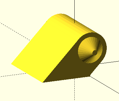

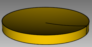

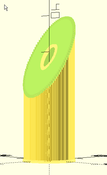

I'm trying to bevel a drilled cylinder, but I when I do that, the top
of the cylinder disappears into a (green) hole. I attached a
screenshot. The 3D printer-owning friend I sent my STL to says there's
a strange gap at the top.
$fn=100;
cylinder(h=39, d=13.69);
     // bevel
    translate([-6.845,-15,18])
        rotate(a=[0,-56.89,0])
            cube(30);
// bolt hole
cylinder(h=39, d=4);
Of course, if I remove the bevel, the top of the cylinder is normal (yellow).
Is this a bug? Is there a better way to bevel a cylinder?

The model works for me.  What version of OpenSCAD are you using?

When I run your code on my machine (Win7, OpenSCAD 2019.05) everything is fine. The exported STL passes Meshmixer inspector (watertight/manifold) and would likely print fine.

I tried playing with the code and I get some rather strange F5 previews but the F6  render is OK using  2021.01.13 (git 0f79135ef)

I find that when subtracting shapes, you need to make them longer than
what you are subtracting the shape from. If both edges are on the same
plane, it often has no idea what to do, you can see the flashing
yellow/green of indecision...

I find that when subtracting shapes, you need to make them longer than what you are subtracting the shape from. If both edges are on the same plane, it often has no idea what to do, you can see the flashing yellow/green of indecision... On 16/01/2021 16:35, Luc Le On 16/01/2021 16:35, Luc Le Blanc wrote: > I'm trying to bevel a drilled cylinder, but I when I do that, the top > of the cylinder disappears into a (green) hole. I attached a > screenshot. The 3D printer-owning friend I sent my STL to says there's > a strange gap at the top. > > $fn=100; > > difference() > { > difference() > { > cylinder(h=39, d=13.69); > > // bevel > translate([-6.845,-15,18]) > { > rotate(a=[0,-56.89,0]) > { > cube(30); > } > } > } > > // bolt hole > cylinder(h=39, d=4); > } > > Of course, if I remove the bevel, the top of the cylinder is normal (yellow). > > Is this a bug? Is there a better way to bevel a cylinder? > > > > _______________________________________________ > OpenSCAD mailing list > Discuss@lists.openscad.org > http://lists.openscad.org/mailman/listinfo/discuss_lists.openscad.org
Ray West
Sat, Jan 16, 2021 5:23 PM
make the last line -
  translate([0,0,-2]) cylinder(h=40, d=4);

I get weird behavior like that with the 2019.05 version as well as the RC5
version.  It also persists if I shrink the cutting cylinder down to a
smaller diameter.  I've seen weird preview behavior when the cutting object
is really big (like bigger than the viewport) but not in a case like this,
that I can remember.
It's bizarre that it works fine if you do the difference() in 3d but gives
those weird results when you use the more efficient technique of doing the
difference in 2d.
One other remark to the original poster:  When you do a difference it's
normal for the cut surface to be green.

That is  to low convexity, default should be much higher but it is what it is

I never remember convexity.  I have it set to 10 in all my library functions,
and I've never noticed that this causes any problems or performance issues.
Is there some reason the default couldn't be changed in a future version of
OpenSCAD?    Why would anybody need convexity to be low?

I think because 1 is the fastest and is correct for all the builtin solids.
Odd thing is that the number required seems to be PC dependent. On an old
laptop I had to set it higher!
