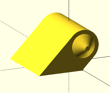

Ok.  I've got a small example, but you will unfortunately have to
update to the latest BOSL2 to run it.  I discovered the issue while
developing a print-in-place hinge for BOSL2, so it occurs with a
just-added new feature.
include<BOSL2/std.scad>
include<BOSL2/hinges.scad>
$fn=32;
knuckle_hinge(length=25, segs=3, offset=3, inner=true, in_place=true);
The model looks like this:
The STL file is small, so I'm attaching it as well.  Maybe someone
with other software than PrusaSlicer can tell us what's wrong with the
model without having to mess with BOSL2.  With this model PrusaSlicer
reports "Auto-repaired 256 errors".

Here's a pretty minimal raw-OpenSCAD demonstration:
$fn = 4;
cube([10,10,8.2], center=true);
rotate_extrude(angle = 360, start = 180) {
polygon(points = [[0, 0], [2, 0], [2, 4.1], [1, 5], [0, 5]]);
Removing the cube has both CGAL and Manifold producing STLs that
PrusaSlicer doesn't like.
(Design/Display CSG Tree is your friend when you're trying to strip away
the complexity of a library to get to the raw geometry, though it would
be nice if it could elide the boring group() nodes.)
