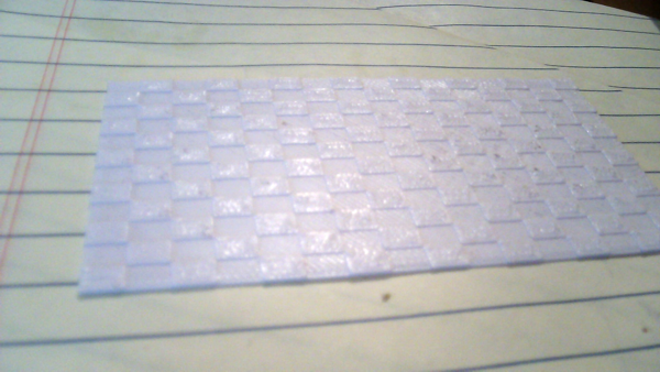

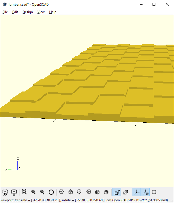

OK, I know I just said I'd shut up, but this is a specific question to
which I have a specific (example) answer.  This is not concocted; it's
real.  The intent is to produce something visually similar to a shingled
roof.  It basically makes a checkerboard where all of the black squares
are slightly raised.  (Because the shingle thickness is down around the
vertical resolution of the printer, trying to represent the actual slant
of the shingles wouldn't work.)
inch = 1;
foot = 12*inch;
layer=0.3;
epsilon=0.1;
module roof(w,l,t,shinglew,shinglel, shinglet) {
    cube([w,l,t]);
    translate([0,0,t]) {
        for (iy=[0:1:floor(l/shinglel)-1]) {
            for (ix=[iy%2:2:floor(w/shinglew)-1]) {
                translate([ix*shinglew, iy*shinglel, 0]) cube([shinglew-epsilon, shinglel-epsilon, shinglet]);
roof(w=8*foot, l=4*foot, t=0.6*inch, shinglew=6*inch, shinglel=4*inch, shinglet=layer);
The rendering ends up with optical illusions that make the shape unclear
from most directions, but this one is pretty good:
Here's what it looks like in plastic (pardon the poor focus):
Why is this a problem?
Note that I couldn't use the obvious solution; I had to inject
"-epsilon" so that the raised rectangles wouldn't touch at the corners.
I don't remember whether I remembered to do that when I constructed it,
or if I had to run into an OpenSCAD non-manifold-ness complaint and then
add them... but I shouldn't have had to add them.
And (OK, repeating myself a bit) I don't care in the slightest what the
slicer does with those intersections, whether it considers the
rectangles to have separate perimeters or not.  The corners should be
awfully close to one another, and whether that means slightly separated,
or slightly overlapping, or precisely touching is not important.
roof.  It basically makes a checkerboard where all of the black squares are
vertical resolution of the printer, trying to represent the actual slant of
inch = 1;
foot = 12*inch;
layer=0.3;
epsilon=0.1;
cube([w,l,t]);
translate([ixshinglew, iyshinglel, 0]) cube([shinglew-epsilon, shinglel-epsilon, shinglet]);
roof(w=8foot, l=4foot, t=0.6inch, shinglew=6inch, shinglel=4*inch, shinglet=layer);
Note that I couldn't use the obvious solution; I had to inject "-epsilon"
so that the raised rectangles wouldn't touch at the corners.  I don't
remember whether I remembered to do that when I constructed it, or if I had
to run into an OpenSCAD non-manifold-ness complaint and then add them...
slicer does with those intersections, whether it considers the rectangles
to have separate perimeters or not.  The corners should be awfully close to
one another, and whether that means slightly separated, or slightly
(Half of the time I say that the slicer should color between the lines,
which means that "square" convex corners will always be round and the
corners will not touch, and half the time I say that no matter how thin the
object is, it should still be represented in the plastic, even if that
means coloring outside the lines, and so a zero-thickness intersection gets
a single minimal extrusion across it.  Either answer would be reasonable
and understandable.)
Now, note:  I'm talking about the input 3D solids and the output plastic.
I'm not talking about the mesh in the middle; that's an implementation
detail that I shouldn't have to care about.  I accept that a "polygon soup"
representation might be ambiguous.  (I'm not sure I've seen one yet, but
I'm willing to accept it on faith.)  It might well be that solving this
problem would require fundamental changes to OpenSCAD and the slicers.
I had another real-project case that ran into the same problem, but it was
more complex.  Basically, it was equivalent to having an inset square with
a raised circle in it, where (to the accuracy of my measurements) the
diameter of the circle was equal to the length of the edge of the square.
I had to fudge them a bit to get them to be different.

On Thu, 14 Nov 2019 at 03:41, Jordan Brown openscad@jordan.maileater.net
On 11/13/2019 9:39 AM, Max Bond wrote:
I think it would be helpful to enumerate the use cases for which
nonmanifold geometry is desired/required, so we can look at that list and
ask; is this what OpenSCAD is for? What do these things have in common?
Would they all be served well by 3MF etc?
inch = 1;
foot = 12*inch;
layer=0.3;
epsilon=0.1;
cube([w,l,t]);
plastic.  I'm not talking about the mesh in the middle; that's an
implementation detail that I shouldn't have to care about.  I accept that a
"polygon soup" representation might be ambiguous.  (I'm not sure I've seen
one yet, but I'm willing to accept it on faith.)  It might well be that
solving this problem would require fundamental changes to OpenSCAD and the
slicers.
was more complex.  Basically, it was equivalent to having an inset square
with a raised circle in it, where (to the accuracy of my measurements) the
