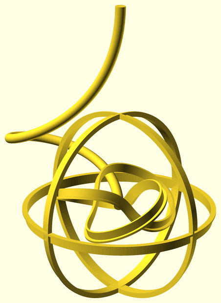

In this operation I am multiplying all the points of a 2D profile in one
multiply, so the result can be a lot bigger than the transform matrix.
Typically hundreds x 3, so that big list could be allocated and filled in
rather than grown. Probably not a great saving as you say because each
element is a 3 vector and each number is still a separate allocation.
Yes I think Python uses boxing as well and there is a lot of scope for
speeding up OpenSCAD's list handling and value handling in general.
This test sweep test takes 0 seconds in the GUI and 2.4 seconds on the
command line to generate a PNG. My fastest tests take 1.5 seconds on the
command line, so that seems to be startup and image export overhead. So I
think the computation is about 0.9 seconds. I suspect most of that is list
handling. Transforming the whole profile with one matrix multiply saves
about 0.3s
