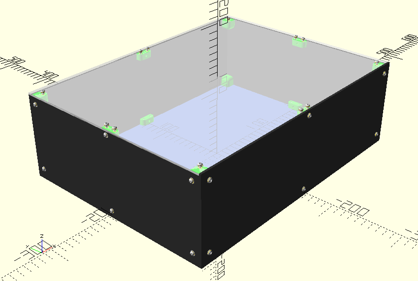

I used it to speed up the preview of this box from 63 seconds to 5 seconds.
All the time was taken making the holes in the sheets. In 3D it is slow
because of CGAL hates lots of holes. When I made the sheets 2D I had to
project the holes and that was not much faster as projection() is very
slow. Now I represent the holes positions and orientation with matrices and
project the holes with matrix multiplication and filter the ones that lie
on the sheet like this.
module drill_holes(type, t)
for(list = [corner_holes(type), side_holes(type)], p = list)
let(q = t * p)
if(abs(transform([0, 0, 0], q).z) < eps)
multmatrix(q)
drill(screw_clearance_radius(bbox_screw(type)), 0);
t is the transformation that maps the holes for each sheet to the X plane.
